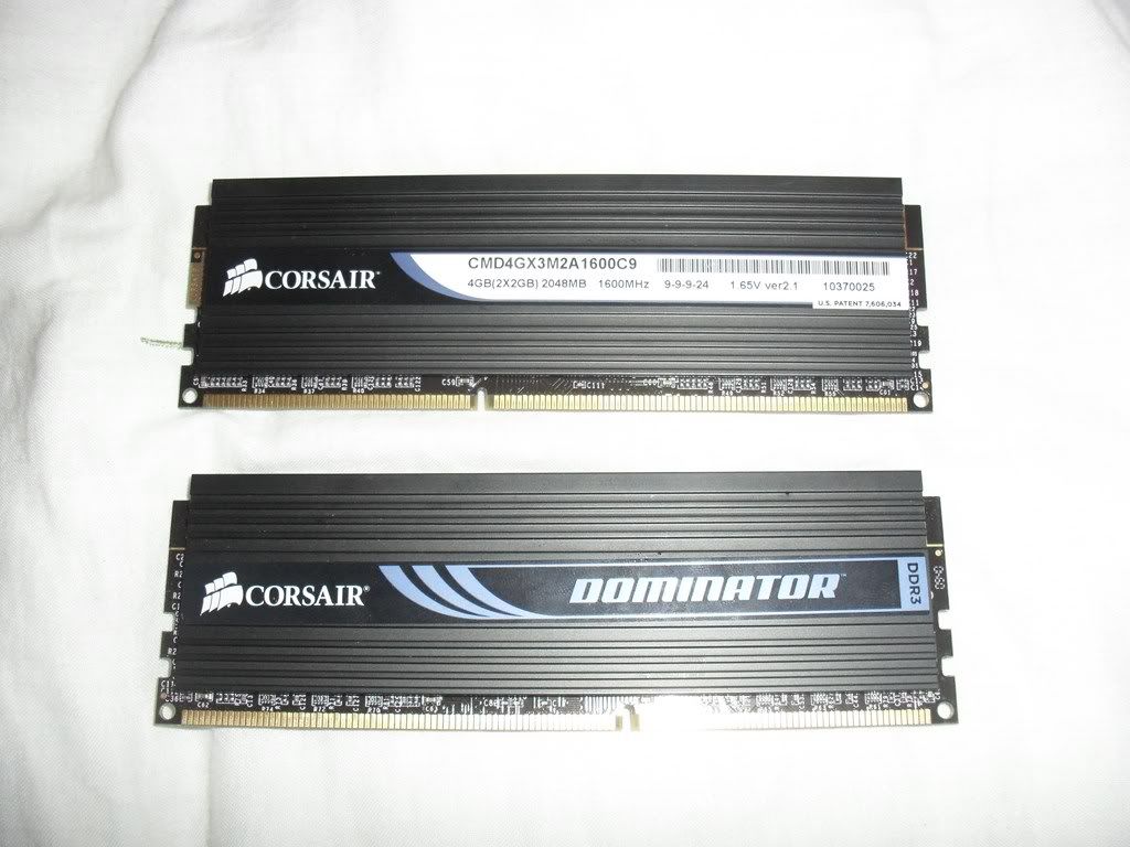

Hi,
Is the Corsair CMD4GX3M2A1600C9 compatible with the CMP8GX3M2A1600C9
I've been offered the first one (4gb kit) for a low price and i plan to buy the second one (8gb kit) but the model numbers are slightly different (differences in bold :)) and i was wondering whether they will work together with my sandybridge rig :)
Thanks in advance :)
EDIT: link to the 4gb kit; ******* (i'm presuming ther aren't a competitor - :))
and a link to the 8gb kit i plan to buy; http://www.corsair.com/memory-by-product-family/dominator/cmp8gx3m2a1600c9.html

The 8GB kit is rated for 1600MHz @ 1.65V and 1333MHz @ 1.5V so it's not exactly Sandy Bridge compatible at 1600MHz unless someone can confirm it undervolts.
Both sets are 9-9-9-24, 1600MHz but I can't see any information on the voltage requirements of the 4GB kit.

As the memory controller is on the processor it's only recommended to use a certain voltage so as not to damage the processor. Intel recommend 1.5V +/- 5%.
So ideally you need to run the RAM at 1.58V or less.
A lot of the kits OcUK sell, such as the Kingston HyperX or Corsair XMS3, will happily run at ~1.5V even though rated as requiring up to 1.65V.
The Dominator RAM you're looking at is rated as requiring 1.65V for 1600MHz.
If you're going to use it with Sandy Bridge you really need it to be able to run at 1.58V or less.
