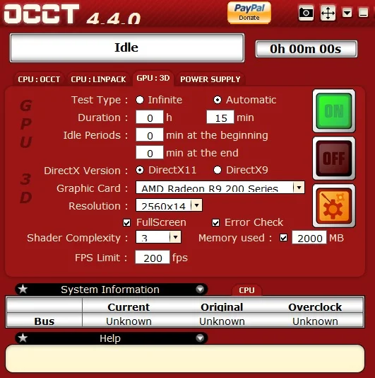

Copy my settings. (ignore memory usage) This will sniff out an faulty or unstable core gpu. If you get any errors at stock clock/voltage settings, then you know its faulty.
OCCT detects tiny artifacts that would otherwise be hard to see whilst watching a short benchmark sequence or whist normal gaming. If it produces any errors, you know it's not fully stable.
As long as you set Shader Complexity to 7 and 400 FPS its pretty good for testing the true stability of the GPU, i got errors on my overclock where it seemed perfectly stable in anything else, but was perfect at stock.
I'm perplexed, or don't know what I'm on about, but I have just run OCCT as shown and have no errors but I do get artefact's sporadically in games.
