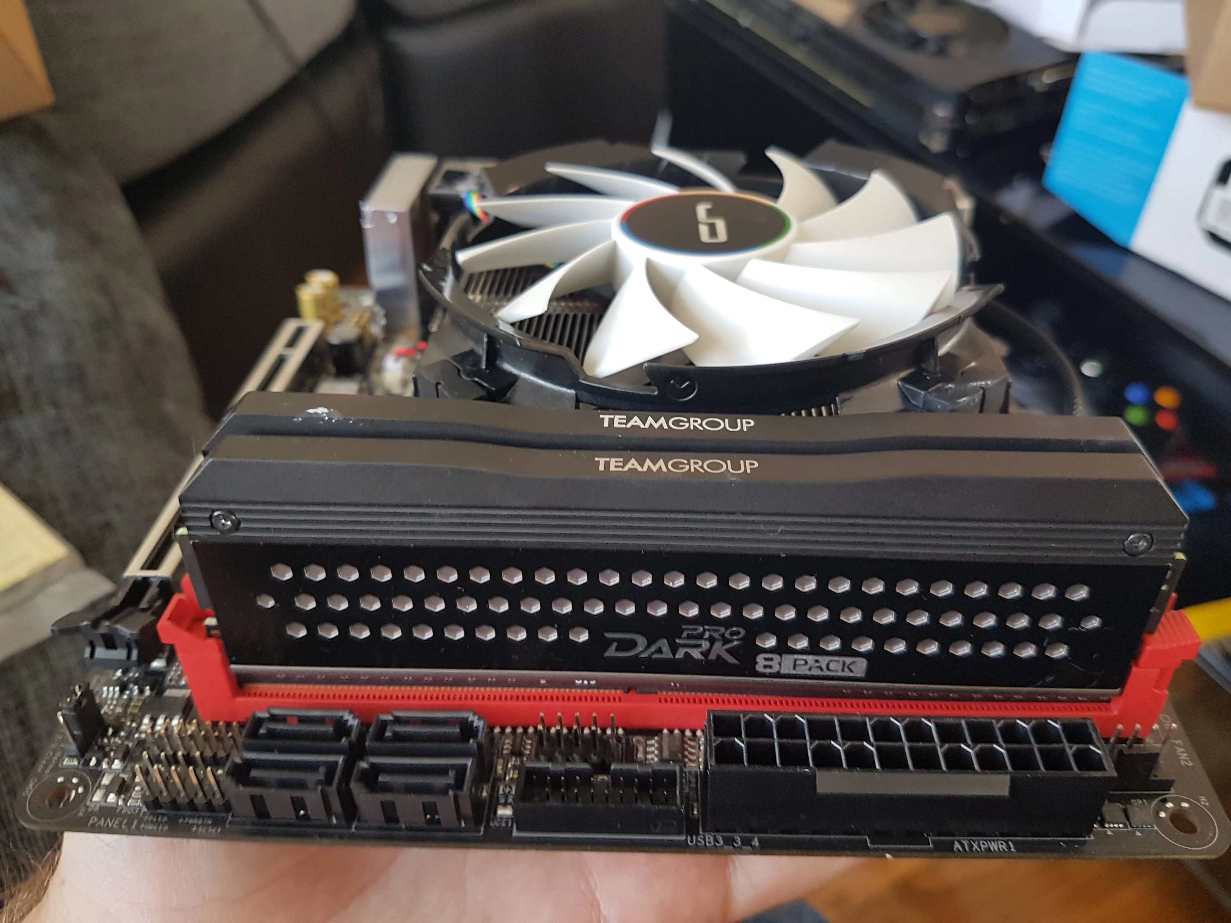

was thinking of trying to fine some really small fans to put on the grill to exhaust near the cpu. or even some how trying to shoe horn in a 120mm aio on the cpu

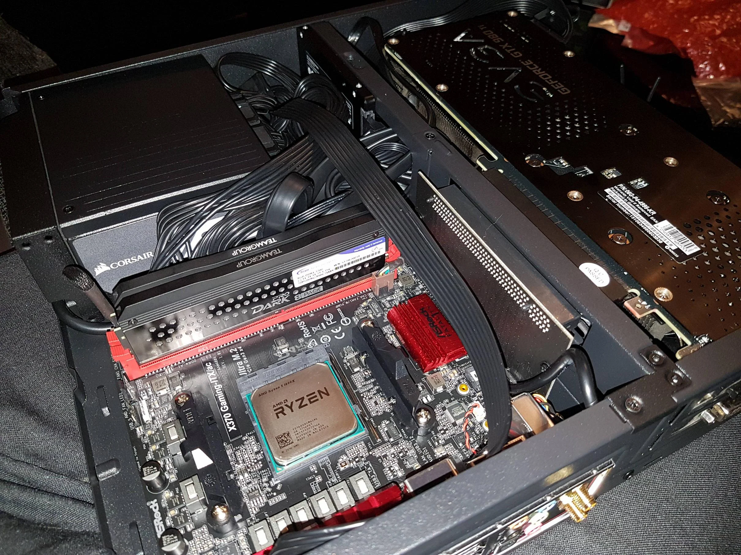

This is the space i have without cpu fitted (its all very tight)
The chamber for the mobo actually has no fan just a grill above and beside the cpu section. I feel it could do with some forced cooling in that chamber really
I doubt you'll be able to shoehorn in a aio, not with the length of that beasty graphics card. Is that the best cpu cooler you can fit in that space? Seen some pics with a noctua fan for the cpu.
that cpu cooler is half the size and 30 tdp lower
