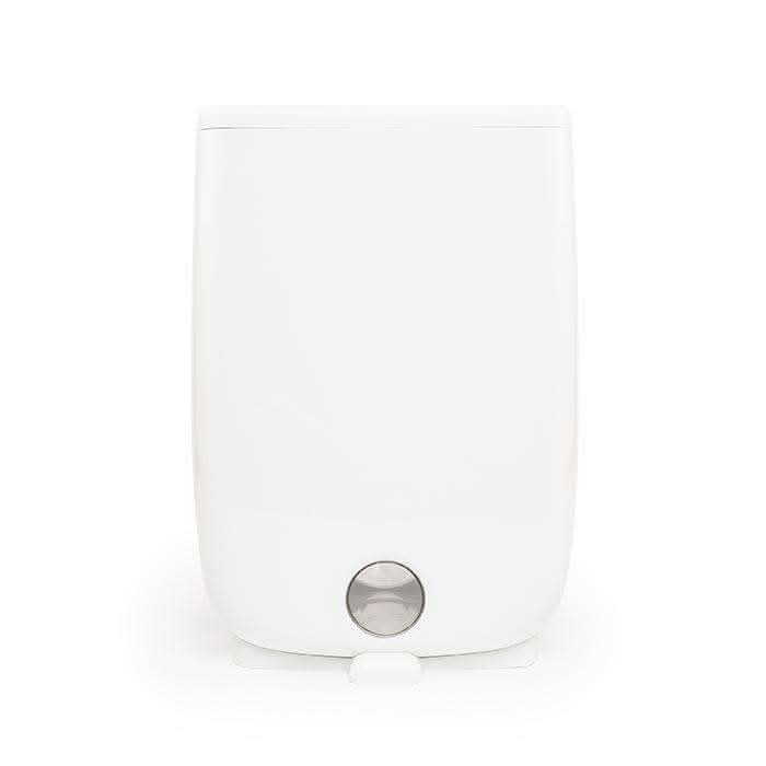

I have a dehumidifier (Meaco dessicant low energy) that i use to dry the kids clothes in a small room during the winter. I also have it on auto setting during the winter so that it turns on/off automatically to stop condensation throughout the house once humidity reaches a specific %.

I have this one which is suppose to be low energy to dry my kids clothers and sort out condensation in my house:

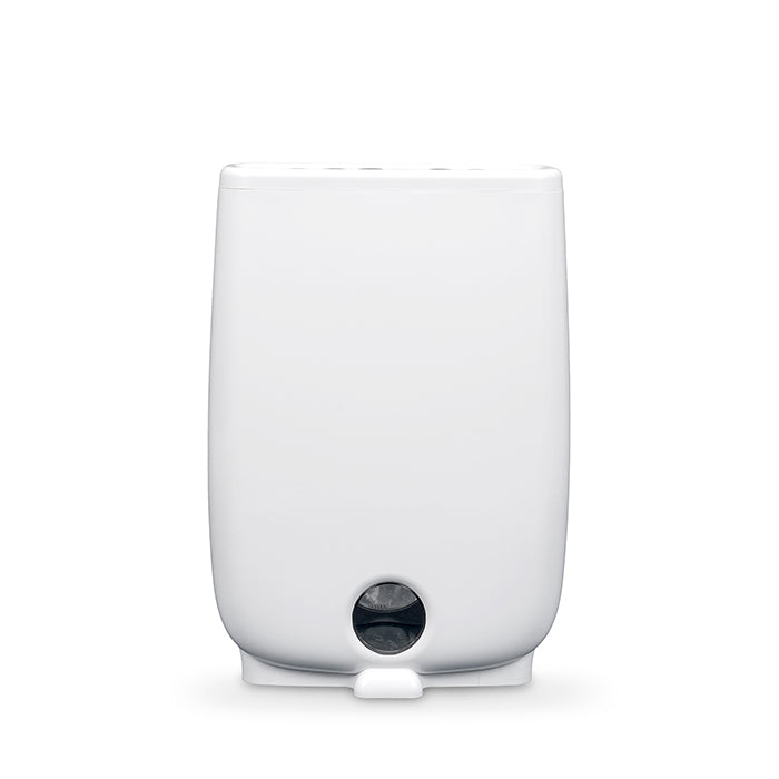

Dehumidifier for sure. Don't be cheap tho - look at least 200 quid. My one has a clothes drying mode and it literally sucks the water out of the clothes.
