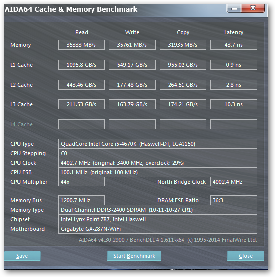

Ram speed higher , bench results lower ?
just updated aida
stock vtt/vccsa 1.55v dram,trfc is 88 or 96 I think not sure can do 2200mhz but the read/write/copy figures drop
Dropped SA, IOA/D and PCH to 1.181, seen a nice reduction in temps in game, (64c max). Also ran superpi 1.5 and no crashes, even managed to break the 7 min barrier. XMP on ram, cpu at 4.5ghz and stock cache.

Hi pgi,
Having real trouble implementing those voltage settings. Found each section but can't seem to get any good boot. Bumped right up to 1.2v on each still as soon as I try c9 nothing. :mad:
Dram was 1.7v whole time. Going to relax and work backwards now.

It may just be down to the motherboard, I wouldn't imagine its power layout is anywhere near as good as my X-OC :)
Its also possible your kits have different IC's to mine, my two kits were from the original OcUK batch, not the bought in batch for the easter sale.
Yeah quite possibly mate. Though this little z87n packs a punch its no match for the oc. :D
I have now just settled for the best i can manage with the c10 settings. Its the $$hi*y TRFC thats killing me here

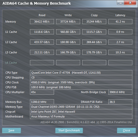

anyway got trial aida64 will add mine soon
