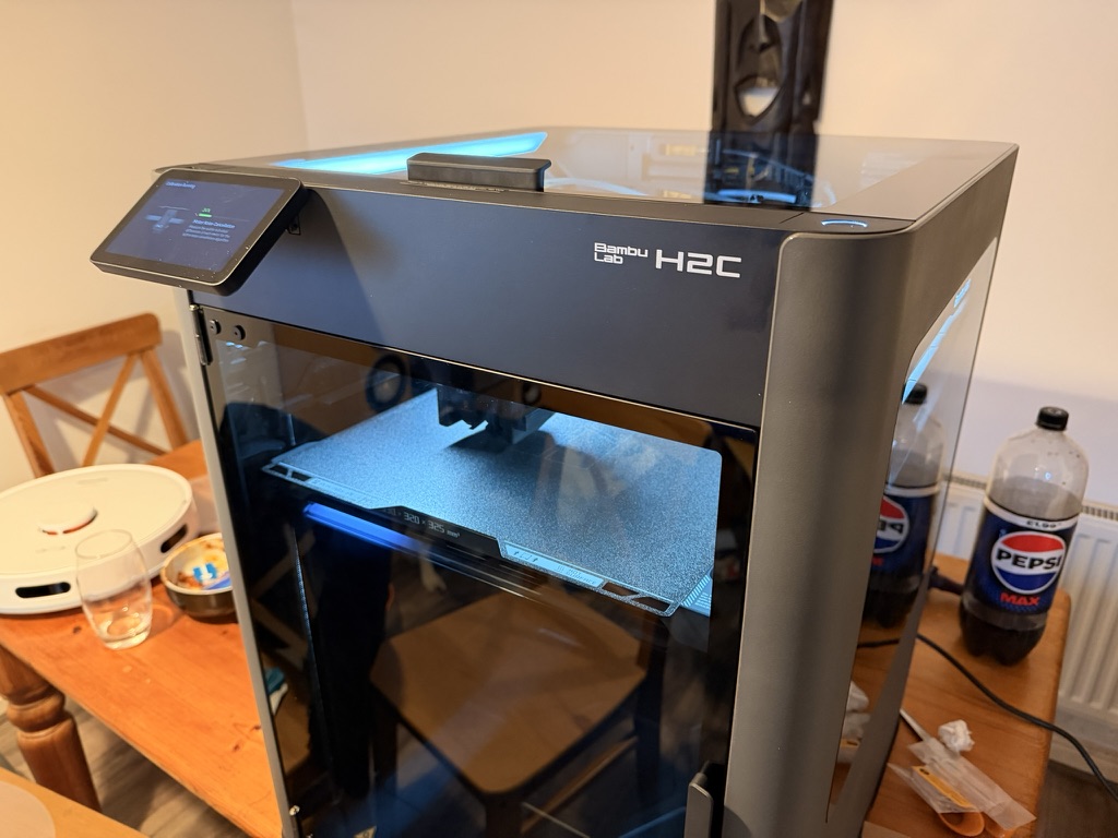

Awwww, yeeeahh!
That Pepsi Max bottle print looks really good.
I don’t do much in the way of multi colour printing and am more than happy with my H2S, certainly once I’d changed the faulty motor and got it working again, but part of me really fancies getting a H2C.
