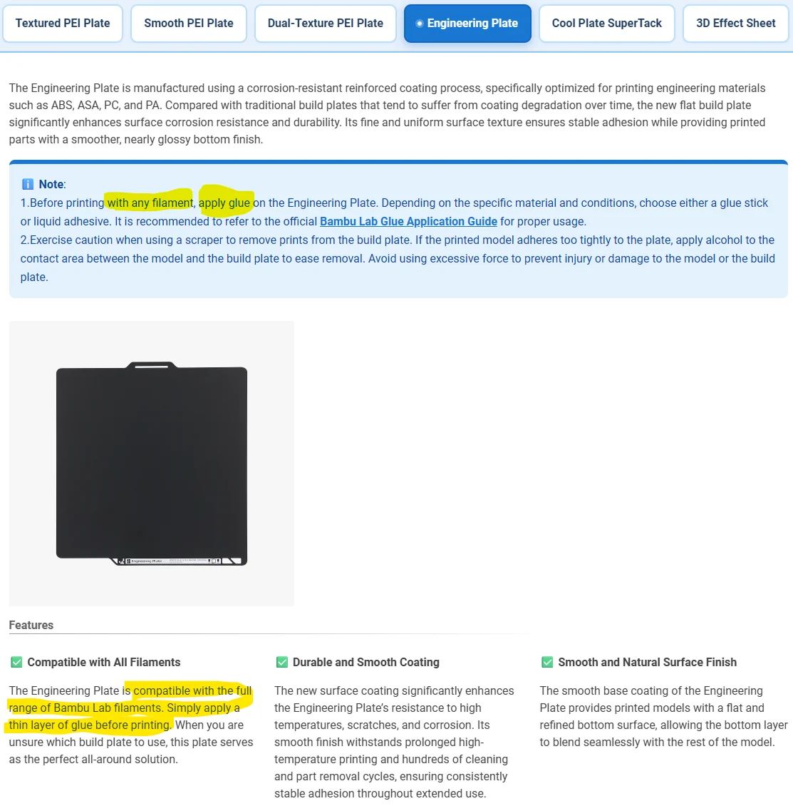

Tried to print this on engineering plate but the first layer would not adhere.
I was trying to print PETG basic. The nozzle temperature was 245 degrees C and the plate 70 degrees C.
A thin layer of hairspray and the first layer finally stuck to the plate.
Is there anything wrong about the standard Bambu Lab printer settings that could have fixed this without adhesive?
The Bambu Mini never had an engineering plate....Standard petg is a bit of a pain in the ass usually; try the Bambu PETG HF or another brand's PETG "Rapid" like Elegoo. I have never had an issue with adhesion on the Rapid variants and never used glue or hairspray even when I had a Bambu Mini.
My mistake, it's been a while since I had it.The Bambu Mini never had an engineering plate....
