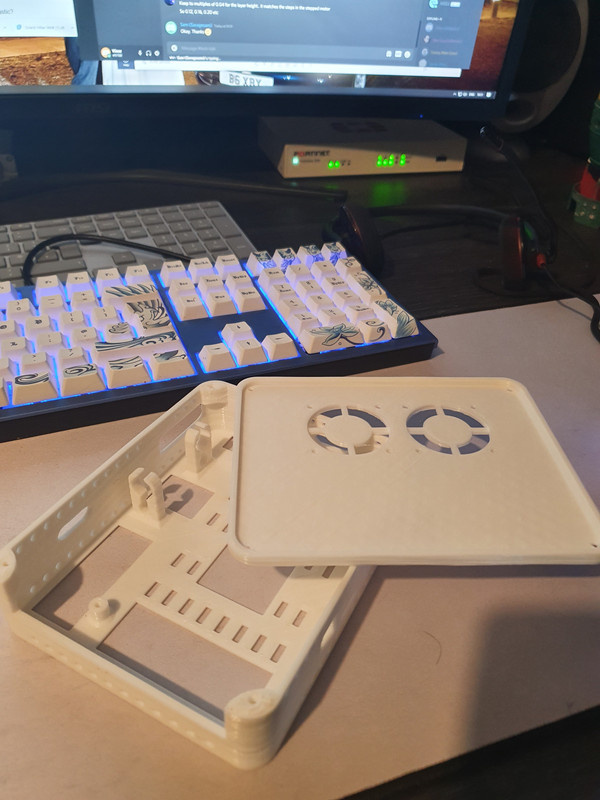

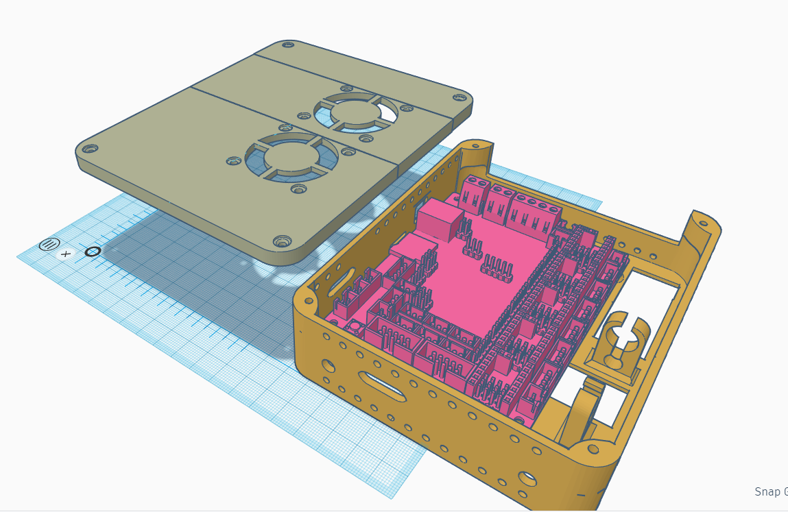

My modded smaller skr 1.4 case:
and printed:
couple of first layer issues on the lid (should have cleaned the build plate :( - but ill fill it with a bit of plasto give the whole thing a little sand and a coat of paint :)
and printed:

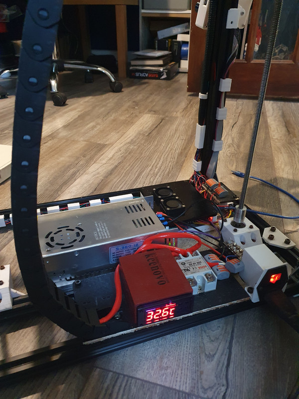

Nice printer. Question where is the heated bed? All I see is glass so what's the thermostat and SSR for?
Also I wouldn't bother with the WiFi module for the SKR, 1) it's super slow and the interface is rubbish and 2) Use the Pi and Octoprint for that.

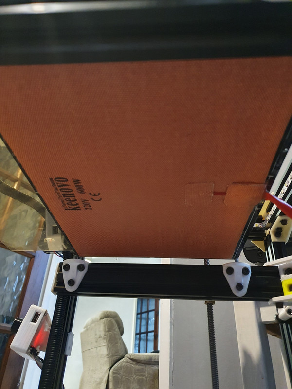

It is here!! 220v 600w and currently connected to a digital thermostat have a look at the pics:
Ive only just finished the rebuild so am working out the quirks!
As for the relay - That will be used by the Pi3 I have bought to turn the mainboard on. Or at least that is the plan. I inherited the printer with mega2560+ramps and have been slowly modernizing it.
That's not the SSR I thought it was don't connect it to the bed.
Oh OK hard to see on the first picture. So what I would do (Have done) is to remove the thermostat and use the SSR, you have a thermistor on the Keenovo pad connect that to the SKR and wire the bed to the SSR and PSU and then wire the bed connector on the SKR to the SSR to control the power.
Right I think that makes sense. Perhaps ill have a little look at that a bit later on today. I thought maybe I could keep the thermostat and have the board control that but what you are saying seems to make more sense.
Oh my bad that's a DC - DC SSR. Ignore what I said.
Its ok ill buy the right SSR :) I think this SSR will allow me to use the Pi3 to control the power to the mainboard etc though. Just need to get my head abound it all and work out what I want to do. She is printing really nicely though which is good :)
