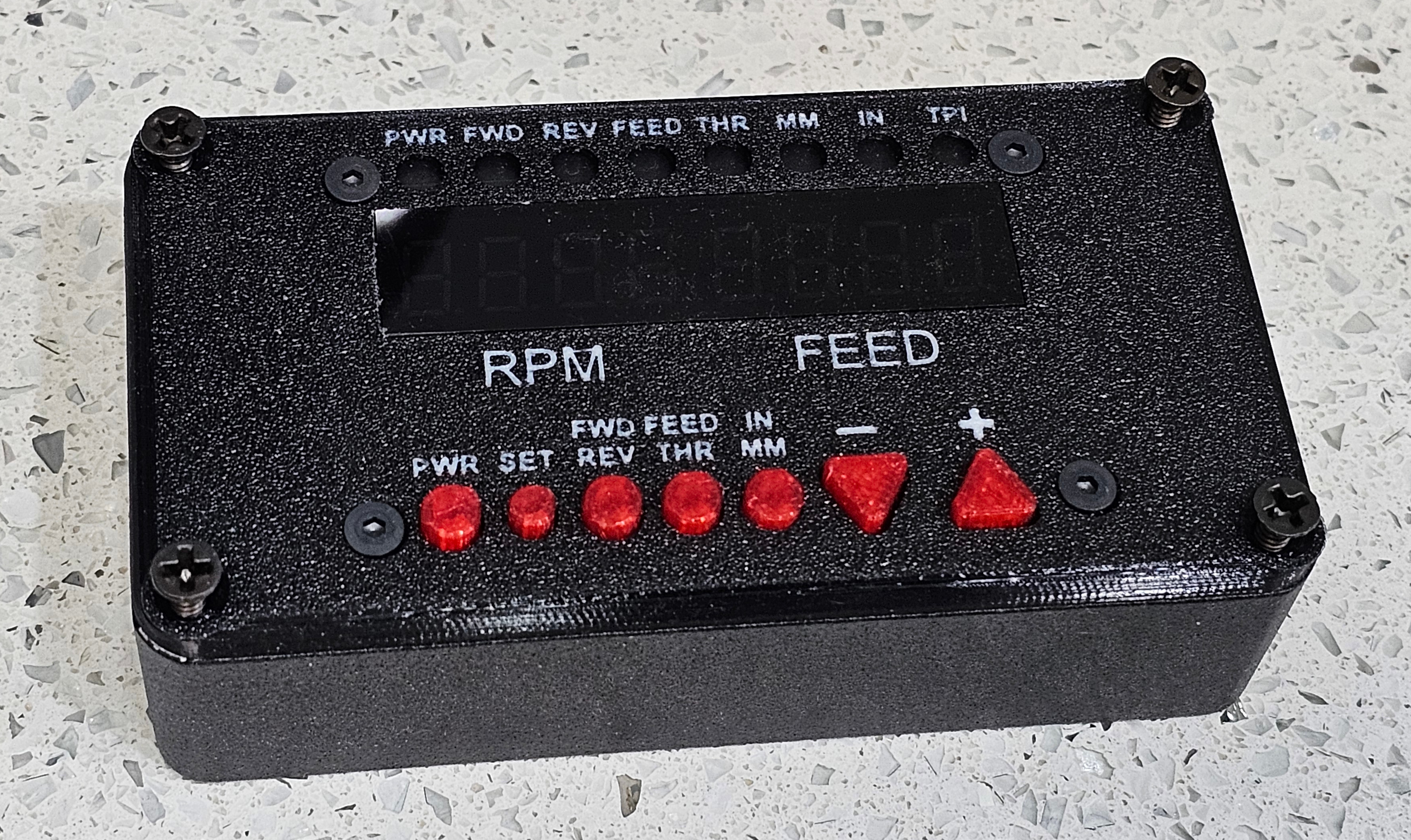

Whilst it's definitely a personal thing, I'd say I've probably used the colour-change more often than I have the extra build volume. I've printed control panels with text (swapped down to the 0.2mm nozzle to get the definition). I've got a smooth bed now so it may look better re-printed.

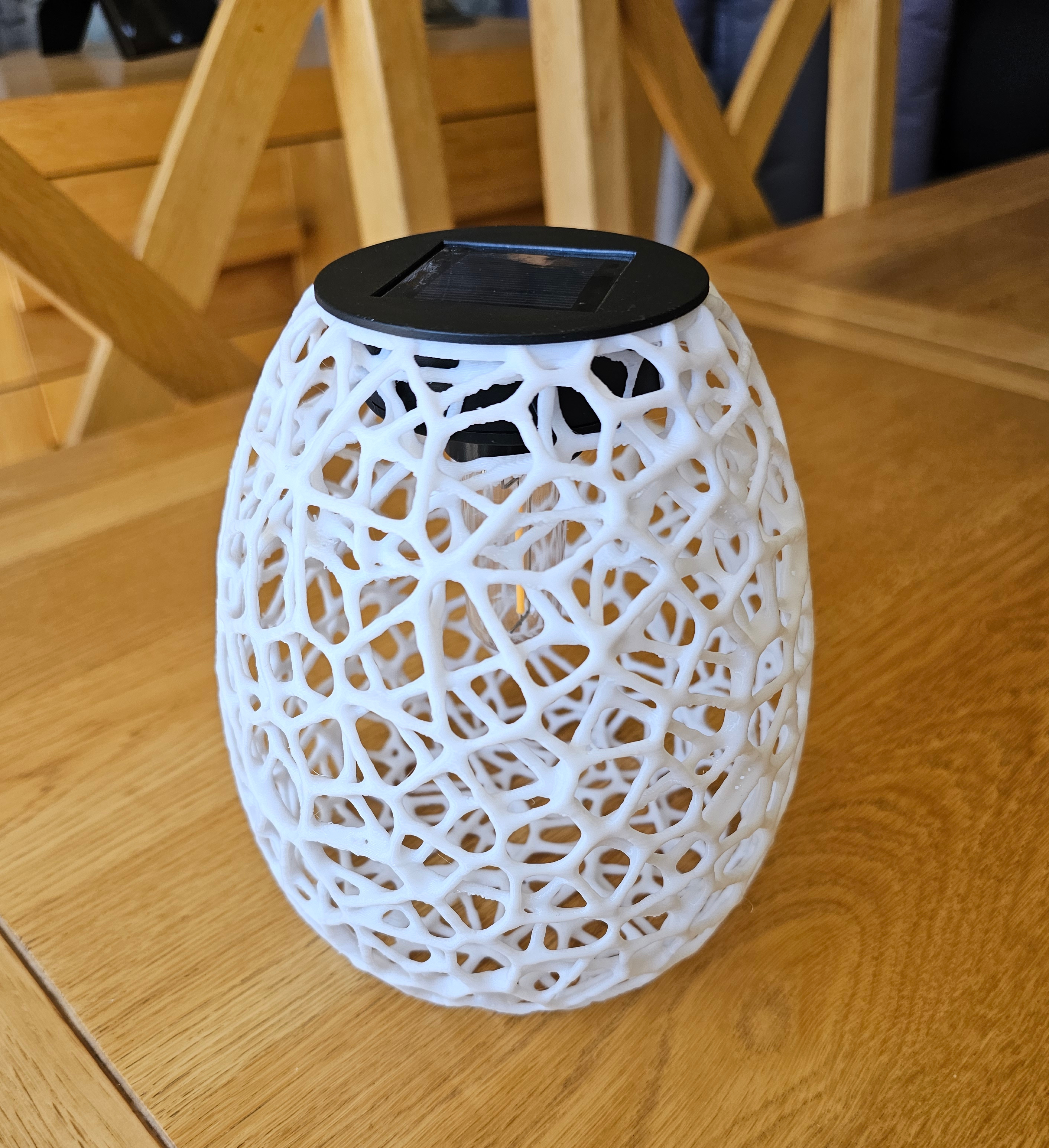

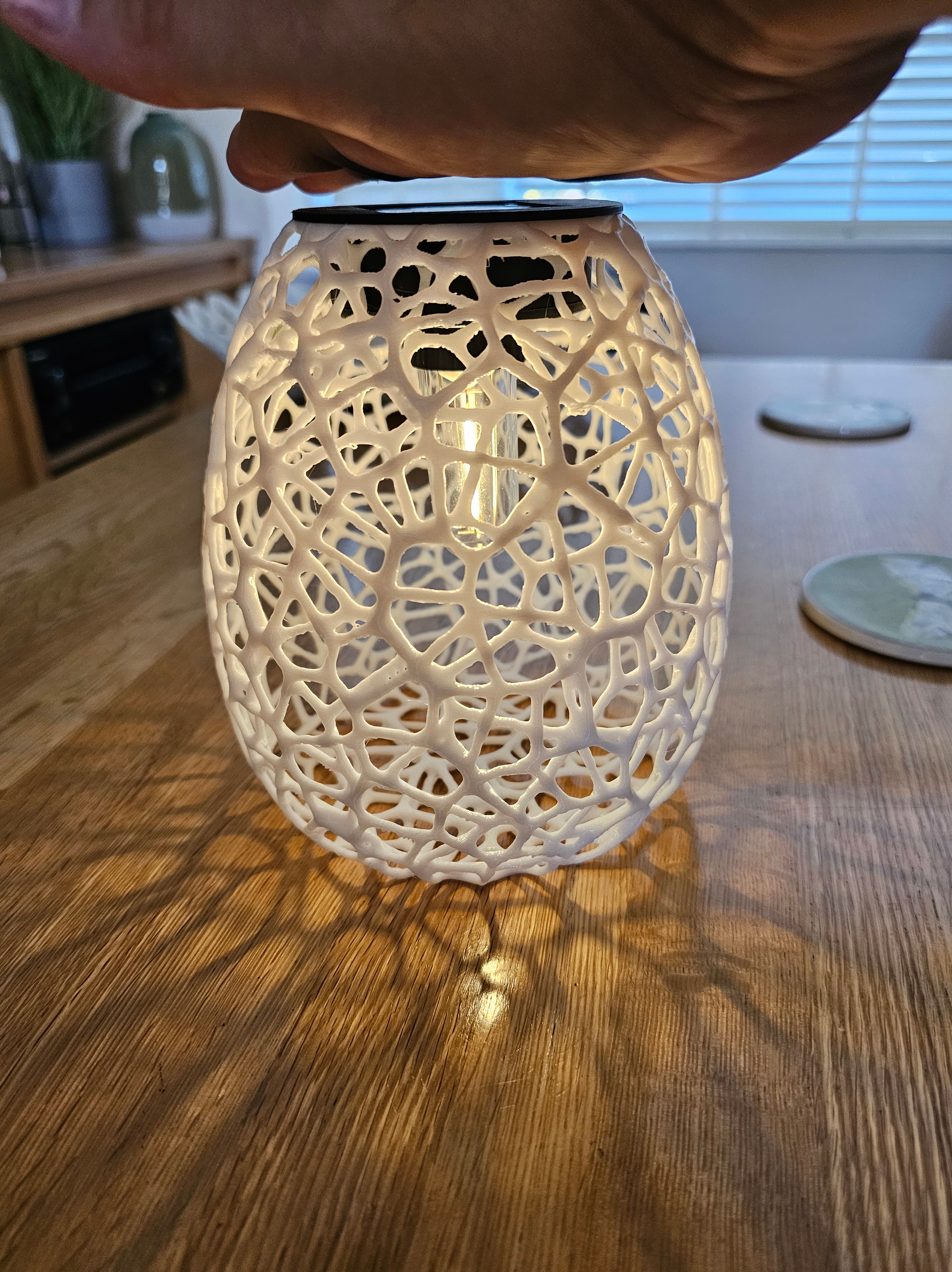

Right, now I'd like to claim victory at 3D printing. For I have achieved the unthinkable. I have printed......something my wife likes and approves of! :eek:
She managed to smash the glass jar this solar lamp unit sits in so I whipped up a revolve in fusion and Voroni'd it:
This is the site I used to turn the solid into a Voroni mesh: https://www.voronator.com
Well worth a play.
It's a little rough in places as the pattern makes some hideous overhangs....but also disguised them in its lack of uniformity. There was auto tree support with critical only set and a 5mm outside-only brim to increase the bed surface area. I had to add and subtract some solids from the mesh to bring the mounting hole back to dimension. Took ages to calculate in Fusion because the Voroni part is in STL format. You might find this helpful if you want to play with STLs in Fusion: https://www.youtube.com/watch?v=WtEWbNIaK9Q
There was a fair amount *cough* of deburring and tidying up to do. Especially where one of the supports failed.
