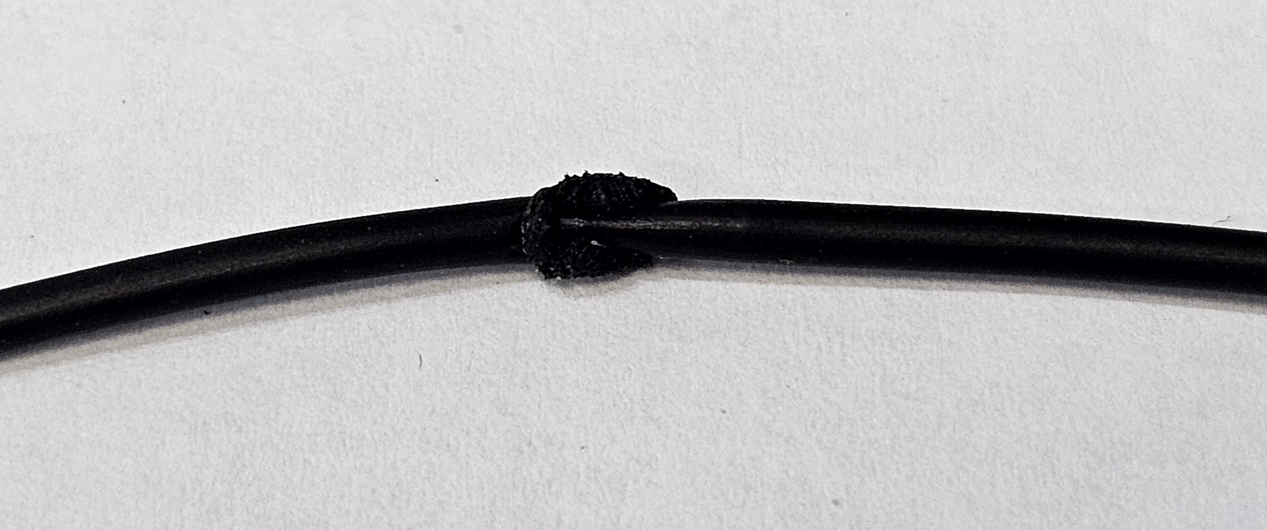

Now, bearing in mind that earlier, I'd found this (click for larger) on the spool:
So there's a really bad splice in the filament that, had I not spotted it by complete chance, would have jammed everything up completely. Diameter was 2.8mm.
