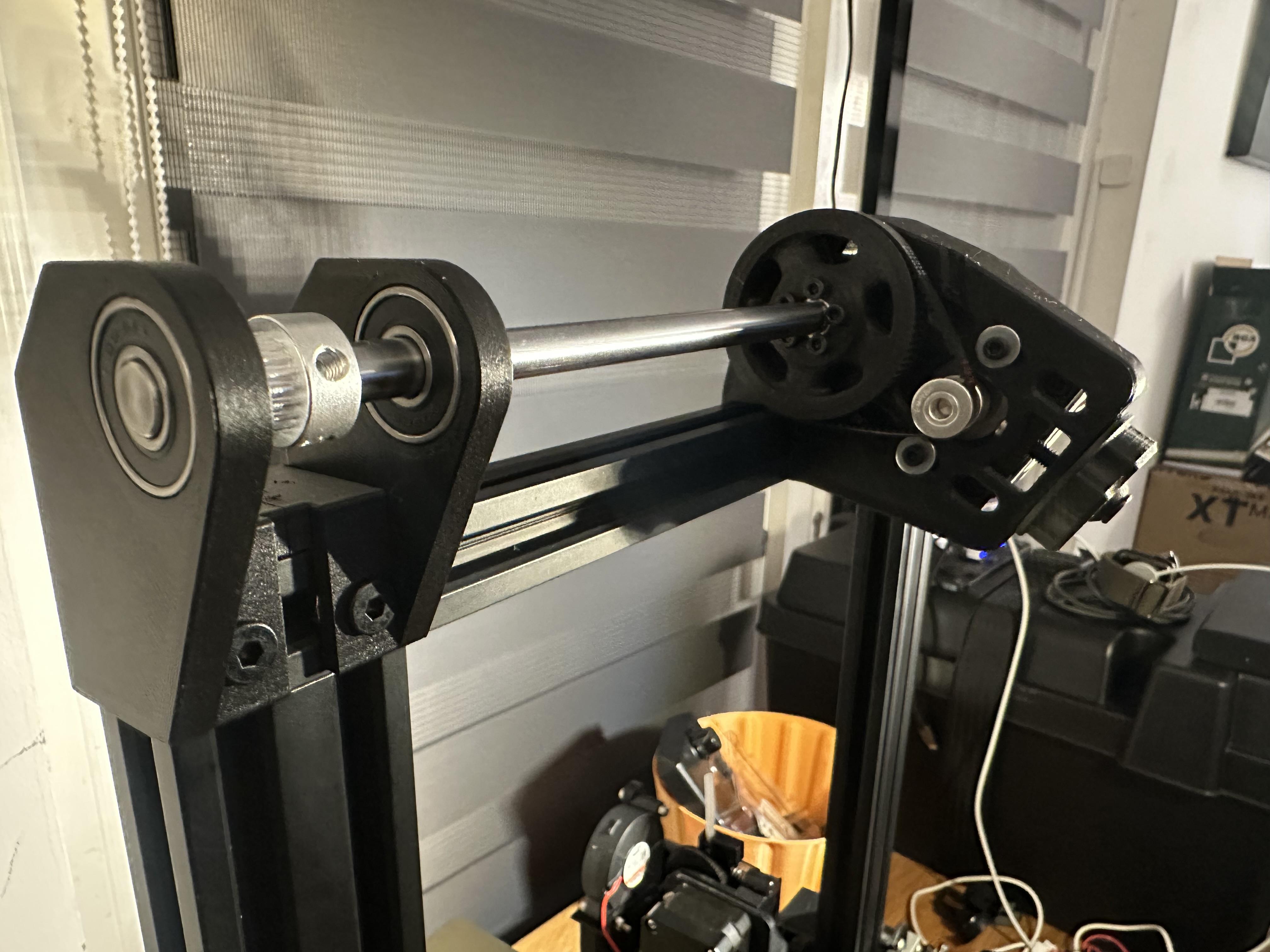

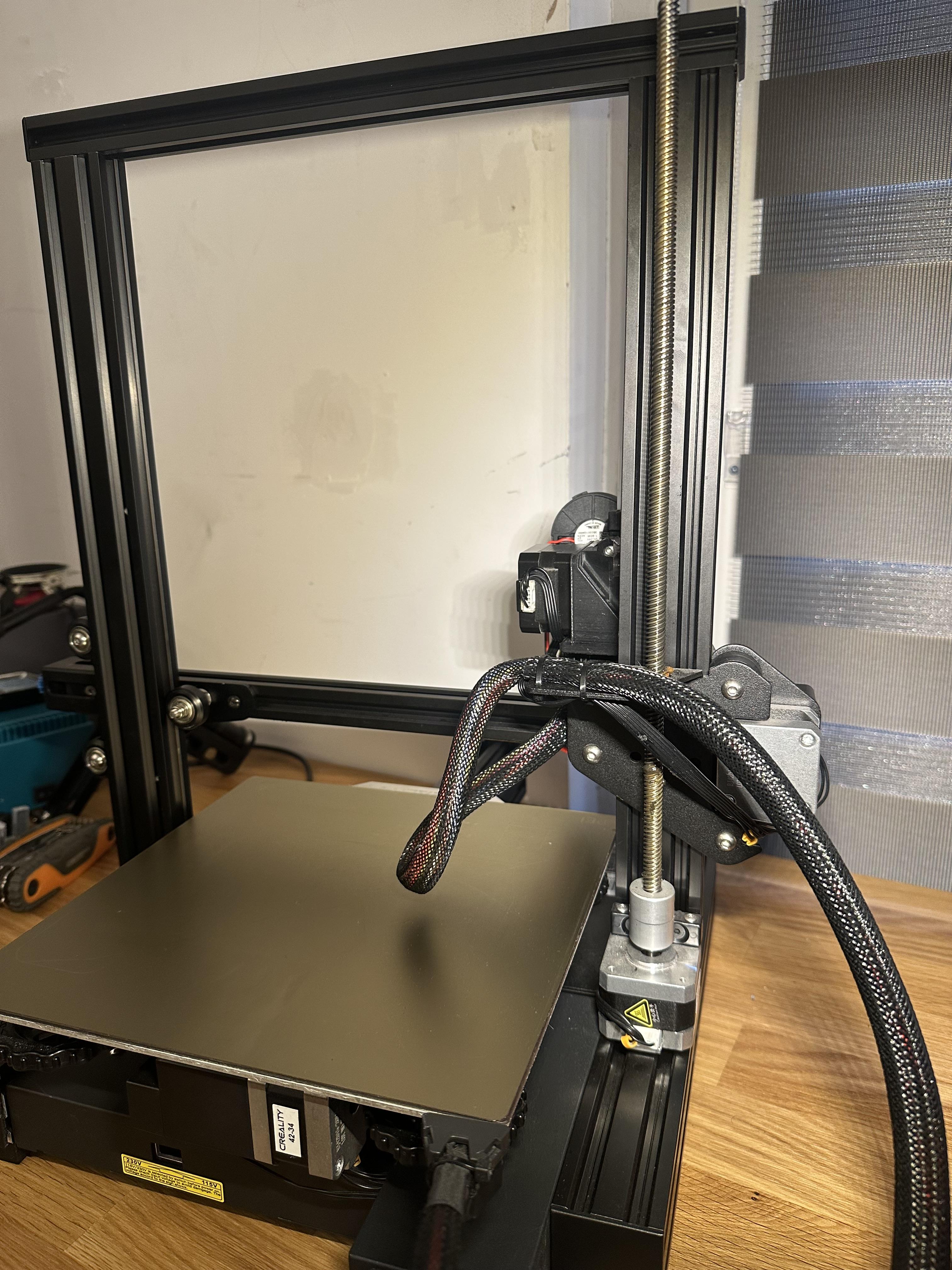

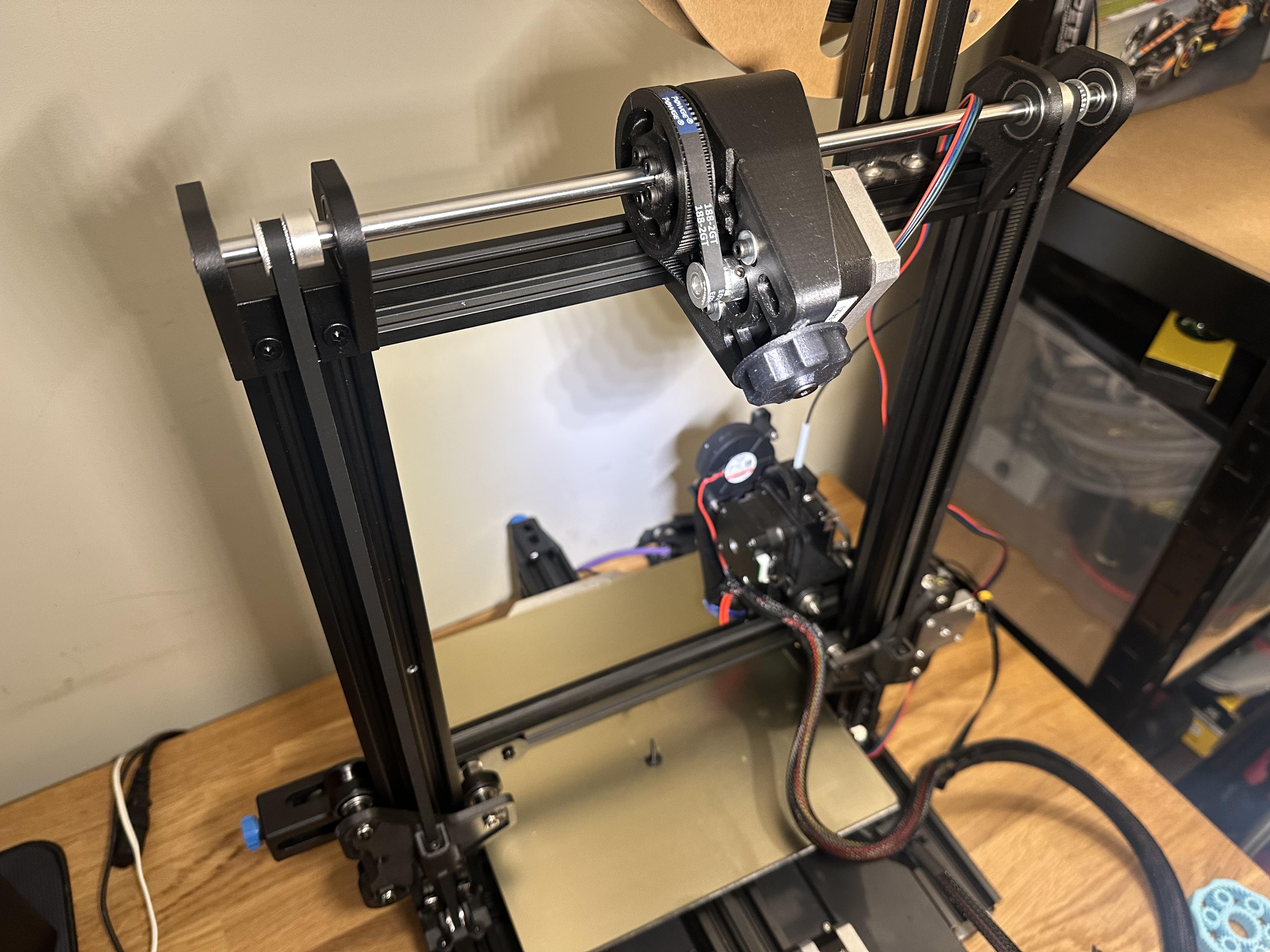

This weekend I finally got around to converting my Ender 3 V2 to belt drive Z, been meaning to get it done for months.
Before, with the standard lead screw setup.

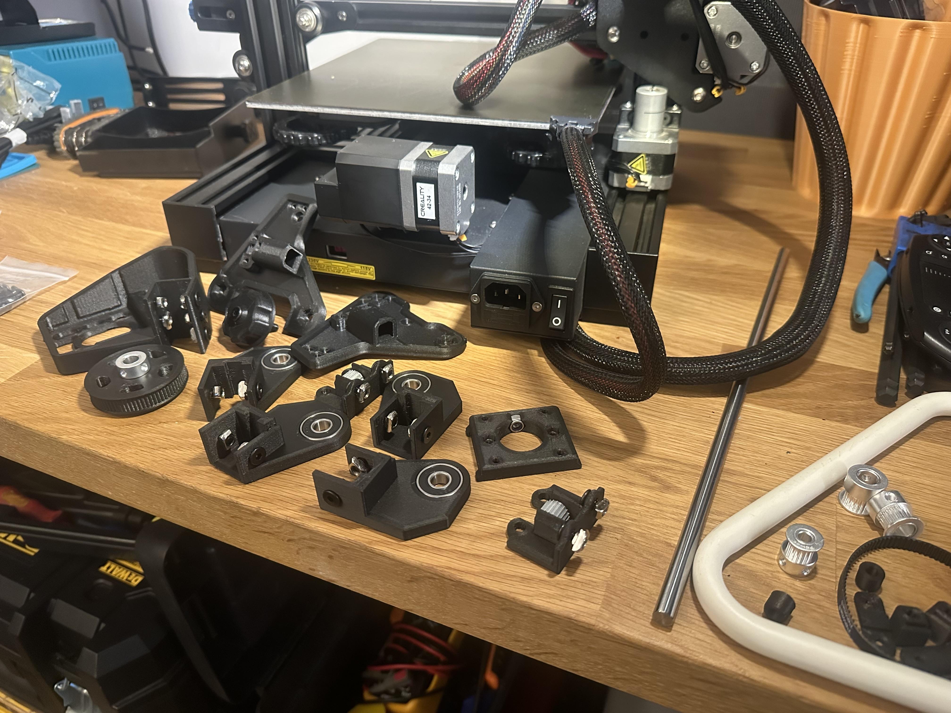

Lots of parts printed ready to go, all in PETG-CF. Bought a kit with the rest of the parts from Aliexpress.
Assembly

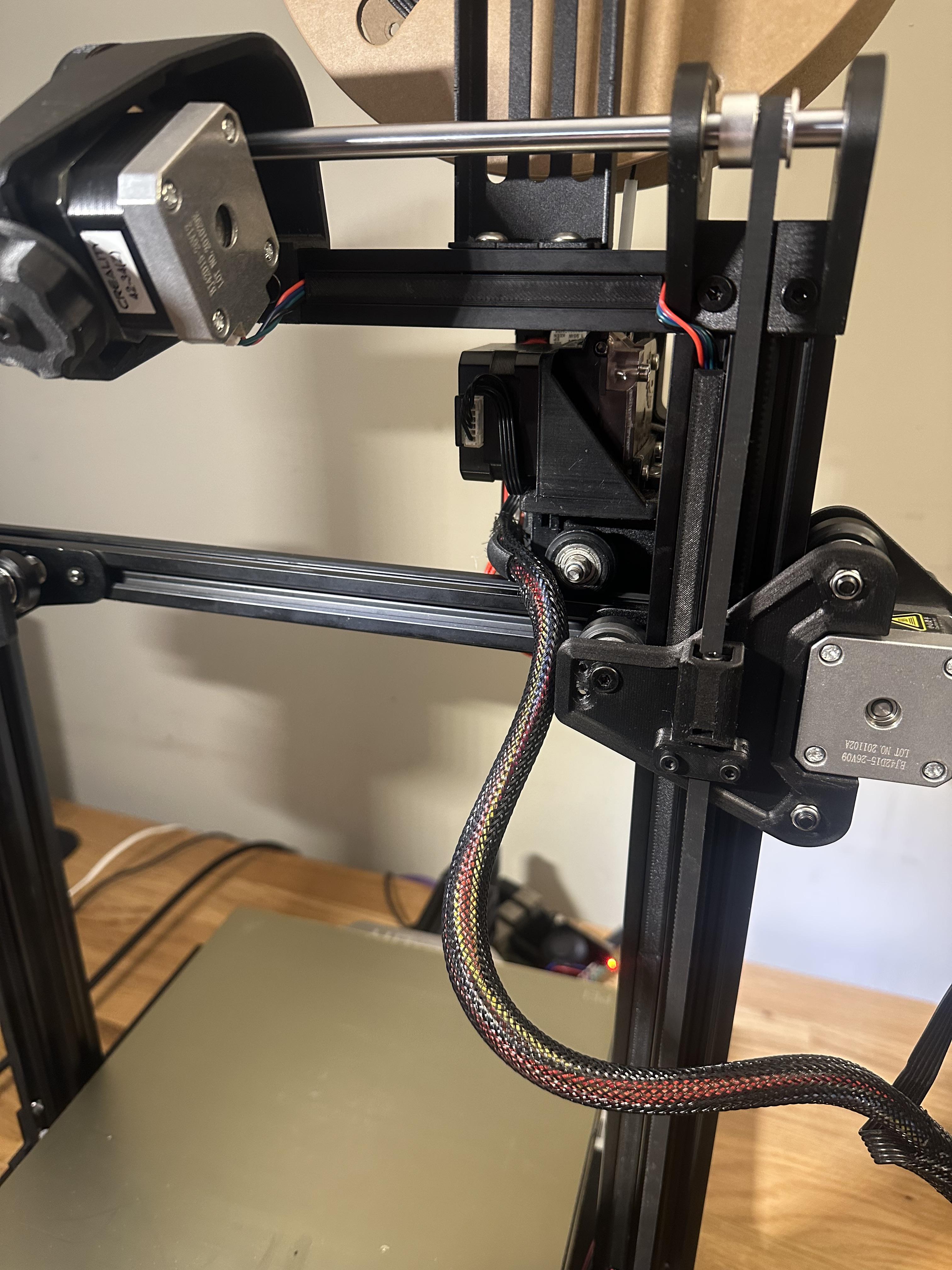

Once back together I printed some extrusion covers to help hide the cable running up the back for the Z motor now up top.
Great little upgrade, Z movement is now much quicker, no gantry sag, will eliminate any z-banding. Plus I think it looks really cool :)

Interesting. I'd always thought that a leadscrew would have been the higher standard there. I guess you're going to have some backlash on the screw and maybe less stretch on the belts than in my head.
Yeah, belt drive doesn't immediately strike me as being more accurate initially. But as you said, there's backlash on the screw, and tensioned belts are extremely accurate.
