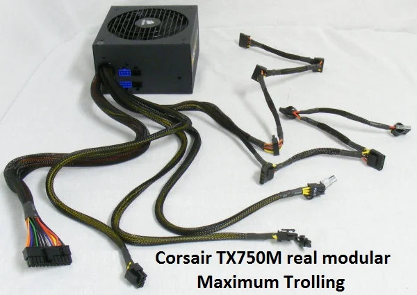

The PSU is not modular but that's your choice you could get a moedular version of it for an extra tenner:
http://www.overclockers.co.uk/showproduct.php?prodid=ca-054-cs&groupid=701&catid=123&subcat=1084
although the benefits of modular has been questioned here recently and most ppl seemed to say that they are bit as 'messy'.

That particular PSU is not modular by any reasoned standard, just had one sent back. All the cables you need for a standard build (and more) cannot be removed, the only modular cables you can choose to attach are required only if you have more than 2 graphics cards and more than 4 hard drives.
That particular PSU is not modular by any reasoned standard, just had one sent back. All the cables you need for a standard build (and more) cannot be removed, the only modular cables you can choose to attach are needed only if you have more than 2 graphics cards and more than 3 hard drives.
LOL that's genius.
I can sorta see what corsair done with that "modular" PSU.
In 9 out of 10 systems these days, all the cables you can't remove would be required so would never be removed anyway.
But at the same time, you are paying for a modular PSU, the ability to remove all cables, especially if you wanted to braid them yourself, would make the job a lot trickier.
Yeah I'd be sending that back too if I'd have bought it! :p
Most "modular" PSU's have a certain number of captive cables.
If you want 100% modular than that's what you specifically need to buy.
I think the following are 100% modular:
  • Corsair AX
  • XFX Black Edition Pro
  • OCZ ZX
Even then not every 100% modular PSU may be suitable for cable braiding.
The OCZ ZX, for example, has components added to the end of some cables making it more difficult and less attractive.
I may not be entirely correct with every PSU in each range and there may be others.
If you want 100% modular then you need to do some research.
