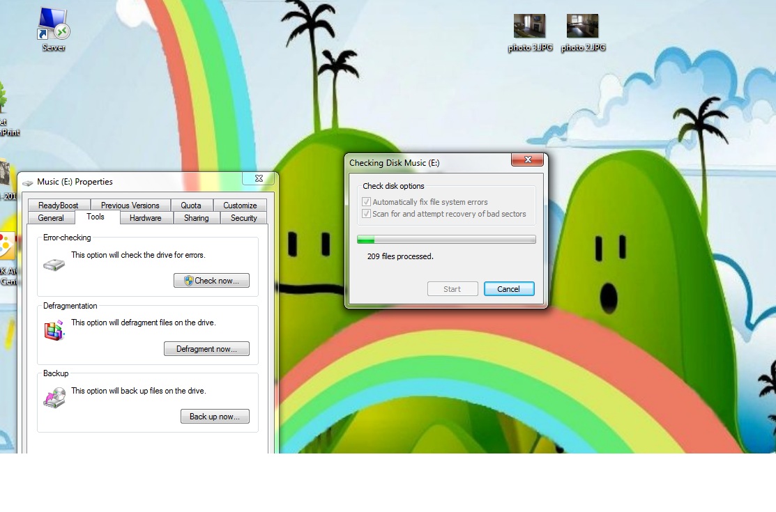

Right, got the drive (1 of) connected to my laptop. I've set it running chkdsk and it started off running great. However for about the last hour its been sat like this
Its not crashed or stopped responding but it just hasn't moved on past this stage. Any idea what the best course of action is?
