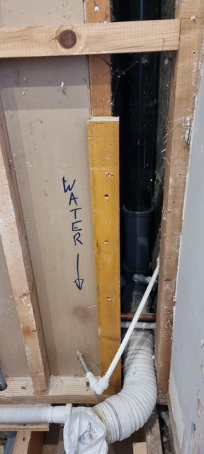

Well, I've pulled the floorboards up... basically, for us to have a flush floor/walk in shower, the 40mm waste needs to enter the stack about 80mm lower than it currently does.
And to access that, means floor up and probably a hole in the dining room ceiling :(

Tiling complications can wait... First I need to fix this waste issue.
I need to get that 40mm waste (EDIT and the toilet waste! )below floor level and over to the left hand wall as you look through the door.
Access to that stack is pretty dire though, even if I go up through the dining room.
HELP :D
