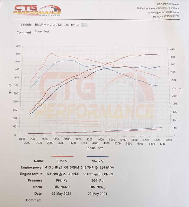

BM3 Stage 1 on my old M140i, I regretted getting BM3, should have went with MHD... This is also a good example of a poor tune. :p Just to clarify, CTG didn't tune the car, only dyno'd it. Really nice guys BTW!
Edit:
If you can get a tuner who actually tunes the car on dyno, go for it. I would avoid OOB maps and god forbid tune boxes...
