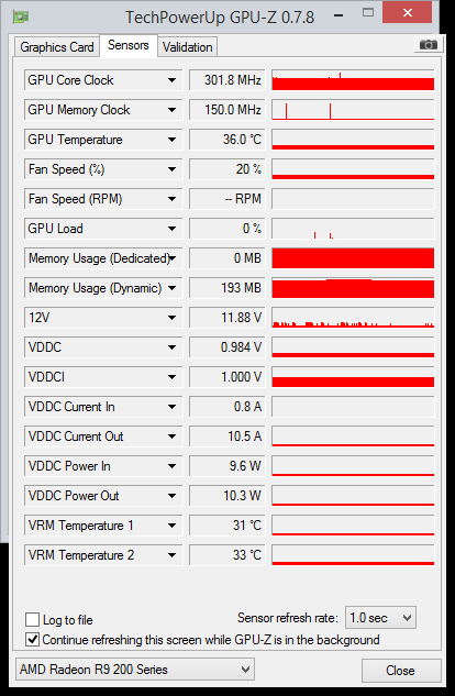

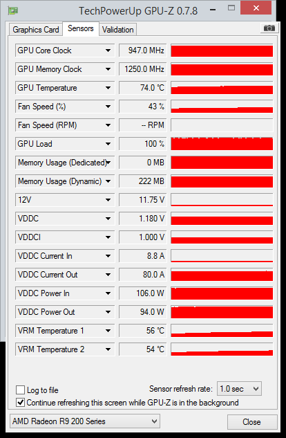

So, I've got my 290X and all my cooling apparatus.
290X came in great condition, such a steal for £250. In the box, all the bits and pieces. Plugged straight in, didn't even touch the drivers and worked like a dream.
Had real issues with the Kraken at first, I was up at 90 degrees with the stock cooler so I had to fix that today. The rad is now mounted in the front and I'm getting 64 degrees at load which means there are still issues, probably to do with mounting/smudged thermal compound but it's SO much better than stock I'll leave it for now.
As expected, VRM1 is crazy hot so I'm gonna order some heatsinks for it. VRM2 is fine but I'll heatsink that up too. I've hit as high as 108 degrees, so yeah.
It runs fine, but the card's longevity is probably an issue.
Sorry for the horrible picture and cable management, it's usually much cleaner than this, I'm just lazy at the moment.
