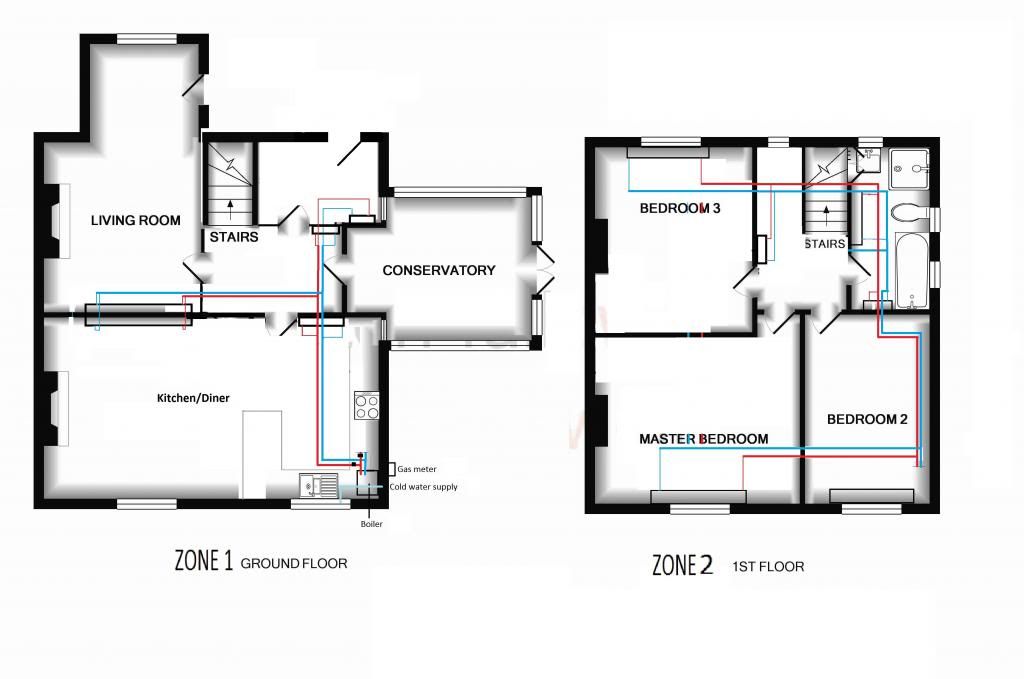

Here's rev.2
I've added another radiator in the kitchen/diner and also I've put two in the hall ways too, I'll need to get BTU calcs done to check the 831 still has enough grunt.
I'll see what she wants to do with the conservatory, wall space is very limited though so it may have underfloor heating if any.
On the hot water side, is there simply one outlet that I just t-off to each tap?
Also, is it worth lagging all of the pipework?

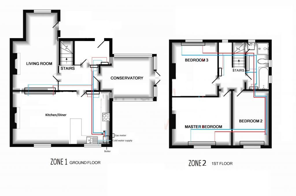

Looks excellent, but Zone one 1, you don't need 22mm in kitchen/dinner then other side of wall another 22mm for living room, good idea putting radiators in hallways.
I would remove the 22mm in kitchen/diner, use the 22mm hallway to tee off from, & why a loop on blue 15mm between kitchen diner & living room?
831 should be ok for around 15 radiators.

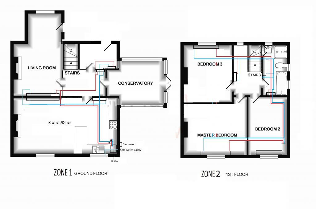

Thanks for that, I'll print it out and go for a wander, see what prices I can get all of the bits for. [you and your stealth edits! :D]
As mentioned earlier, I intend to do all of the pipework and rads + remove the old system and then get a plumber to come and fit the boiler. Would buying the boiler myself be a bad idea ie. should I just let the plumber do that bit? Or am I likely to get hold of a plumber that will just fit all of my own parts?

In bedrooms 2 & 3 you could stop BLUE 22mm at same point as RED 22mm & reduce down to 15mm.
And the same in living room, show your plumber & see if he agrees.
And clip the pipes where necessary, nothing worse than rattling pipes.

Obviously it'd be cheaper to drop down to 15mm where you mentioned but are there any downsides?
Downsides?
Trouble is your plan isn't to scale, so I have no idea as to length of run from where you tee off the 22mm to radiator in 15mm which might be 300mm or 3000mm

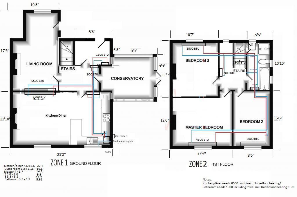

Rev.6!
I've added dimensions (metric noted in the bottom left with floor space in m^2) also I added the on-line calcs for BTU requirements :)
Considering doing away with the smaller rad in the kitchen and also the small rad/towel rail in the bathroom and going for electric underfloor heating.
