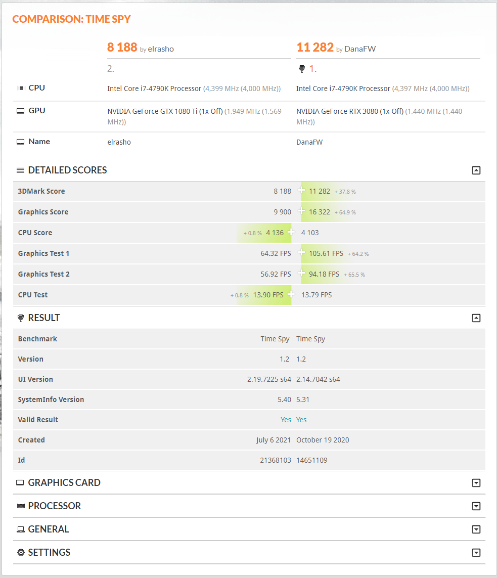

3D Mark was going cheap on Steam so I got it. Compared my results with someone who had similar specs but a 3080 GPU
Looking at a 38% increase in graphical performance if I got a 3080 :) That should get be back on track as my pixel count has gone up by around that percentage aswell

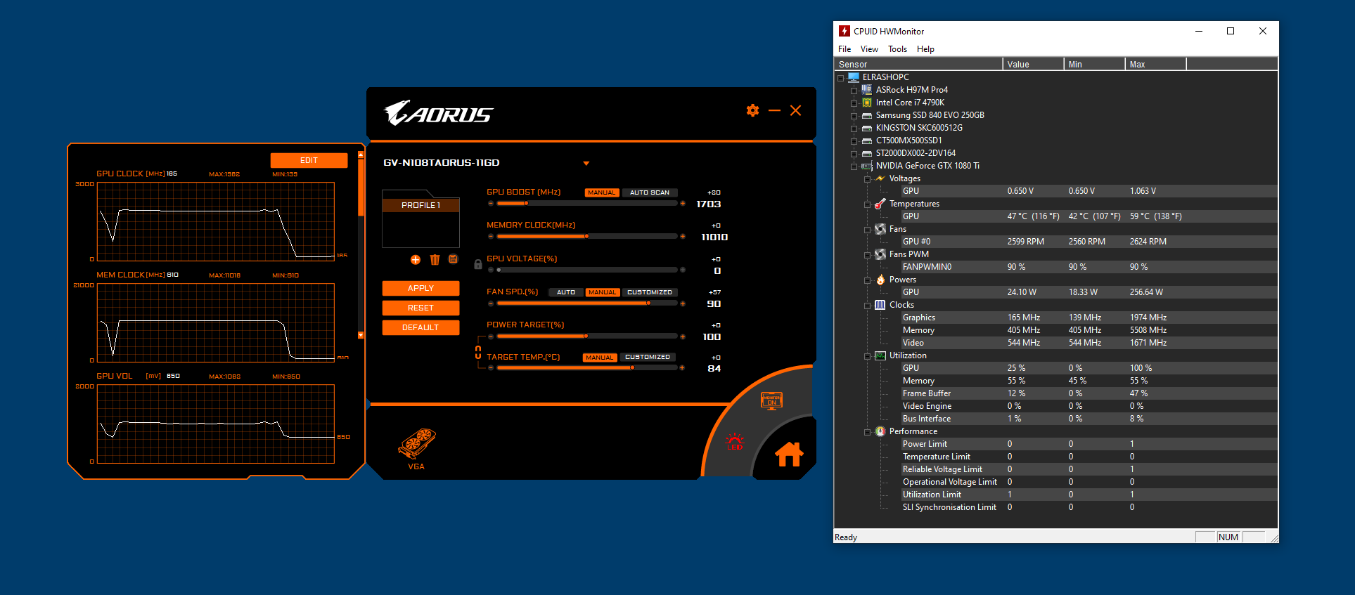

I overclocked my GPU by just 20Mhz and now I'm getting solid 100+ FPS with same graphics settings I had before. How can just 20Mhz make such a big difference? Shall I overclock the VRAM too?
Here's a vid too:
Also noticed GPU usage sits at 97% almost constantly so seems like this site overclock has kicked my GPU up the butt lol Temps never go above 60c too
