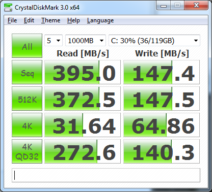

I'm having an issue with the RocketRaid 620. I seem unable to break 400 mbps using 2xc300 in RAID 0.

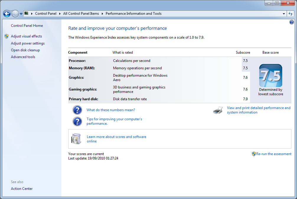

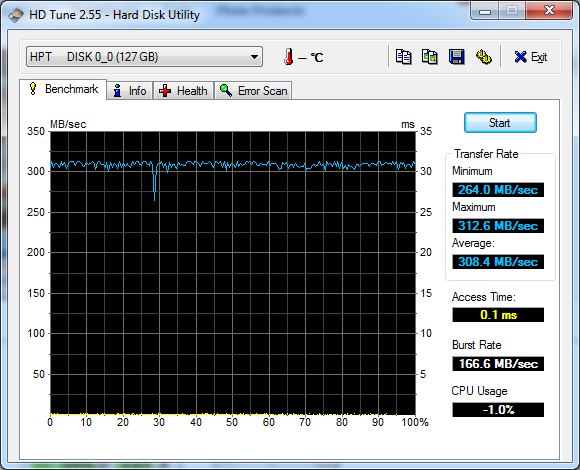

Please look at these benchmark screen shots and let me know if you have any thoughts. The ATTO one seems to just brickwall at 400....
The wierd thing is that the write speeds are fantastic and exactly where I think they should be.
So my thoughts are around the bandwidth across the PCI-E controller. The 620 is a PCI-E 2.0 1x card and if my p*ss poor maths are correct the bandwidth should be 500 mbps (http://en.wikipedia.org/wiki/List_of_device_bit_rates)
So my answer is probably not to be so cheap and stump up for a better RAID/SATA 6gb controller......but if anyone else has any thoughts - here are the benches...

Stump up for a new controller, it definitely looks like the Highpoint can't handle more than 400MB/s throughput in RAID0. You'd even do better than the 500MB/s theoretical max that a 1x connector gets you by using your onboard SATA 3Gb/s ports to set up your RAID.
Unfortunately for you the most affrdable choice for decent 6Gb/s raid performance is the LSI 9240-4i at ~£160. Personally I wouldn't bother unless you were wanting to RAID 3 or 4 SSD's and could really justify the extra throughput (HD video editing etc; General Windows use and game loads don't actually benefit a noticable amount from one SSD to RAID0 SSD's, the bottlenecks are elsewhere now)
If you're not booting from the drives, try running the drives in JBOD mode and using Windows to software RAID0 them instead.
