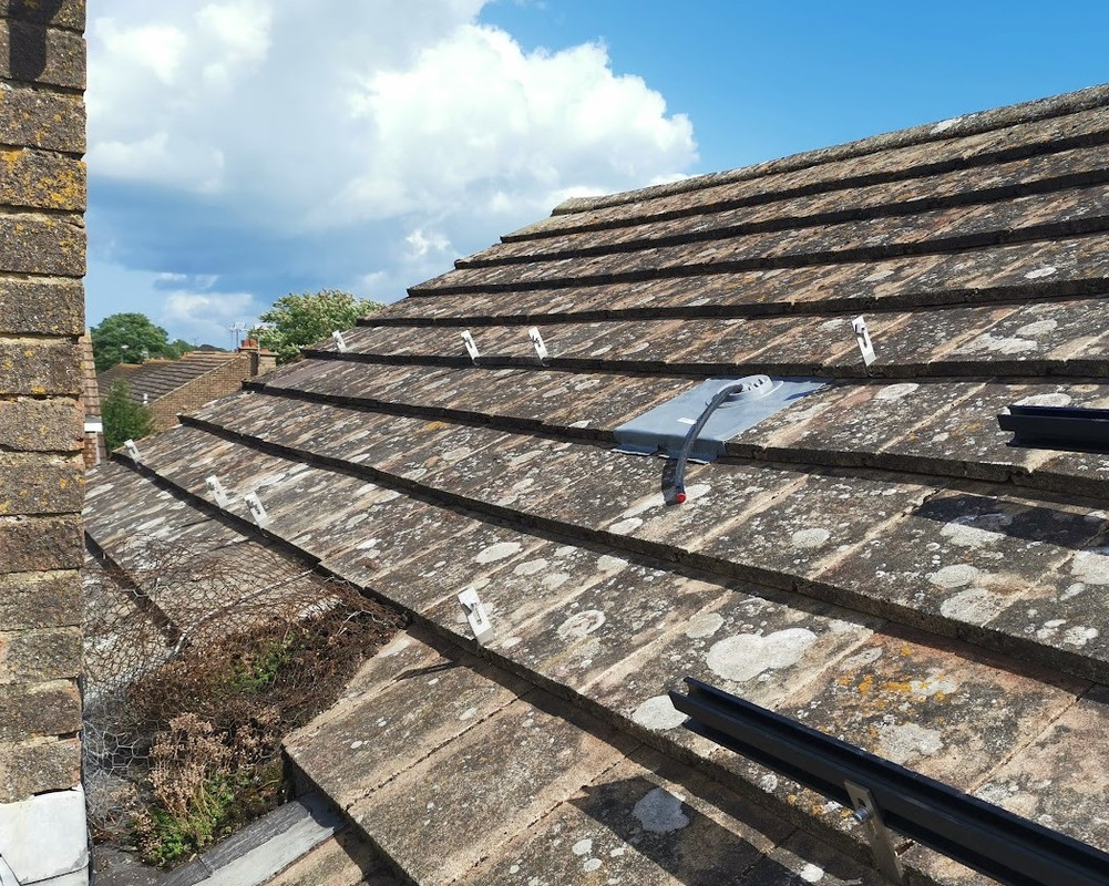

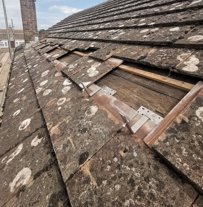

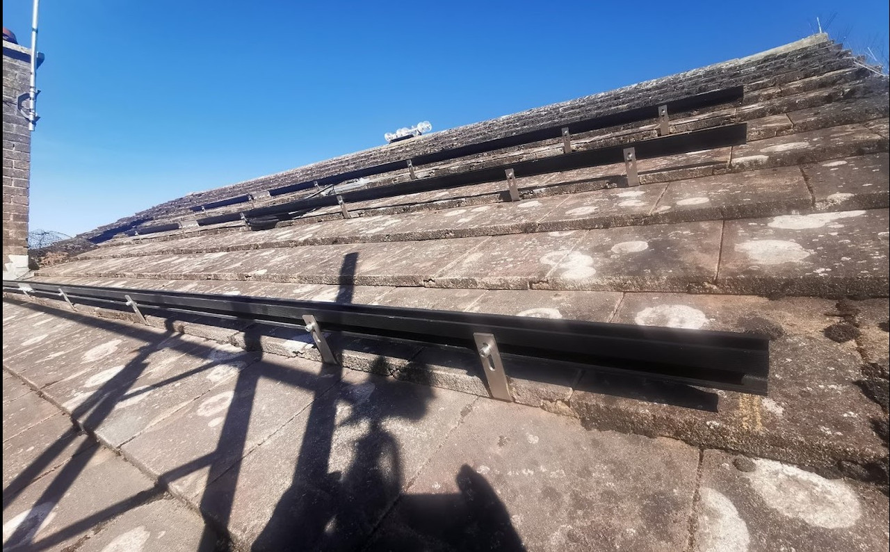

First row of hooks in.
The hooks have to spaced out so the hook doesn't rest on the tile below, so I've used some 5mm aluminium between the hook and rafter, there was also a hole in the felt, so I patched it in.

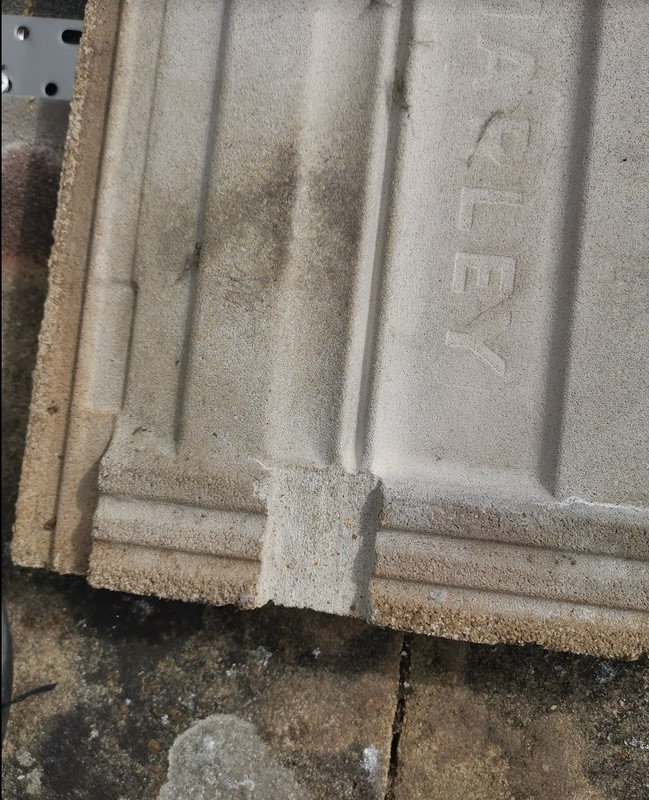

Likewise the back of the tiles have to be notched out, so that also clears the roof hook.

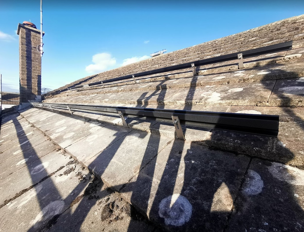

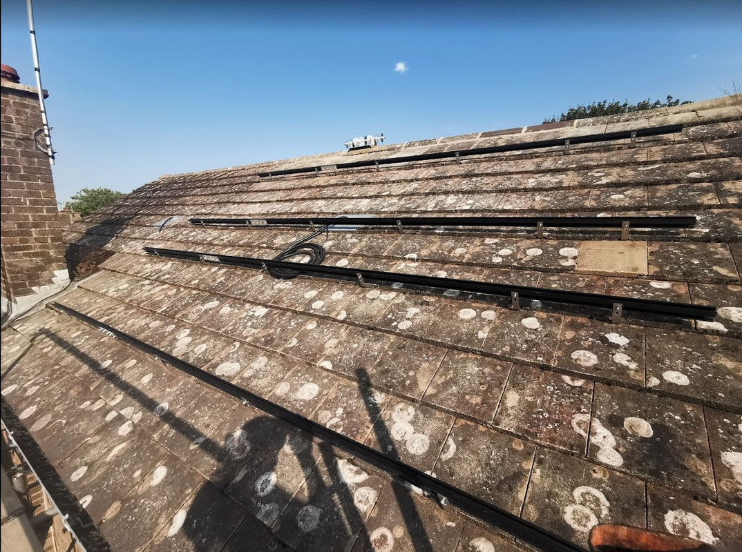

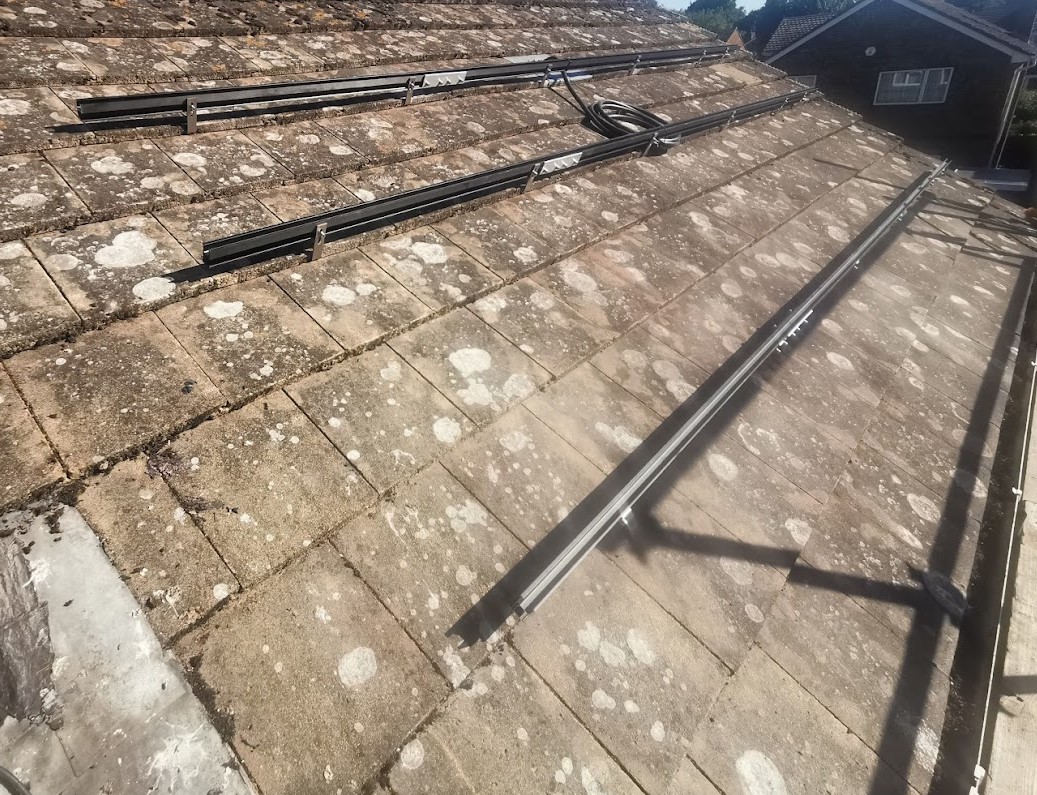

I got two rails installed yesterday, this picture and the next were taken at 18:36.

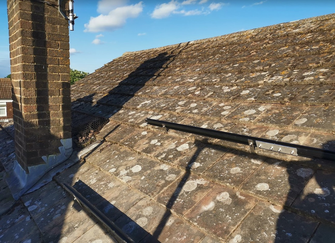

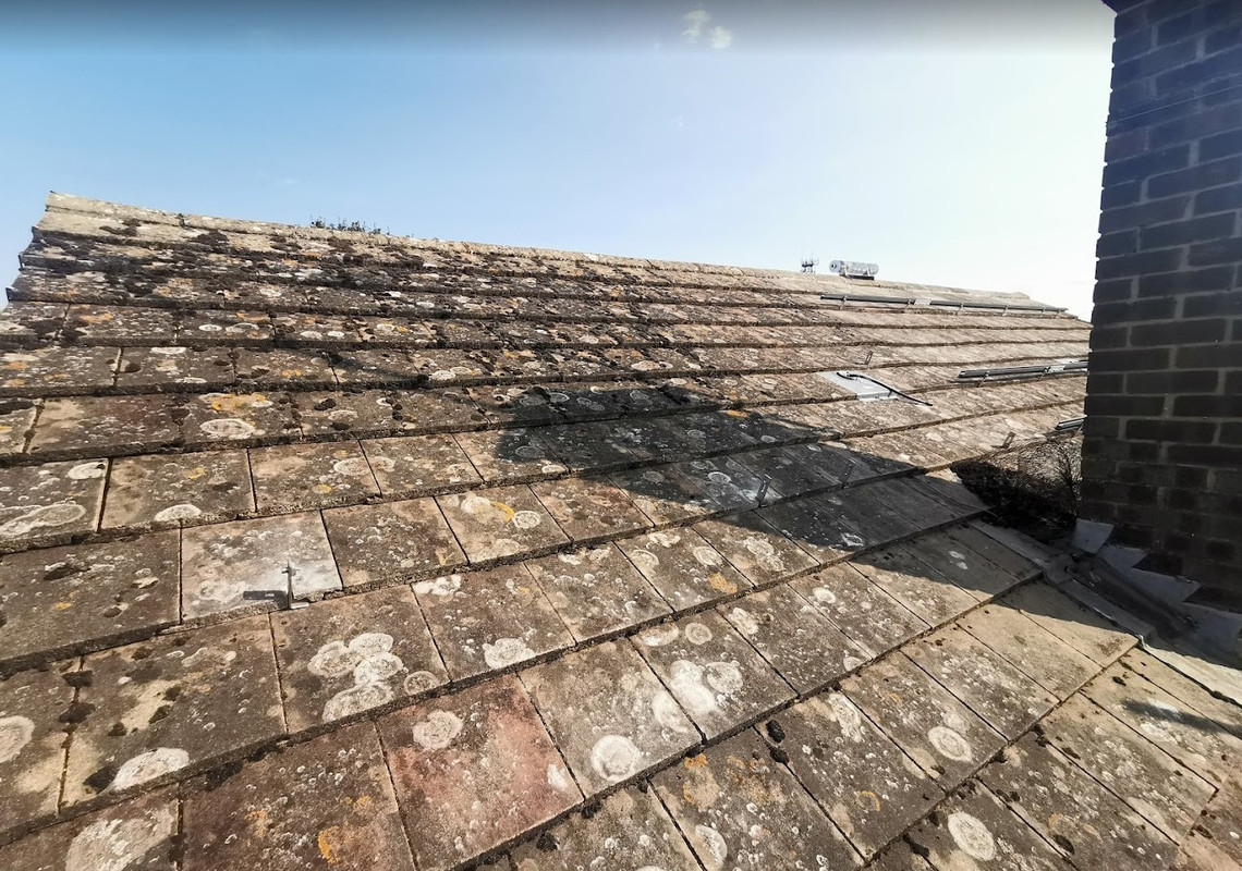

This picture shows the shading caused by the chimney, and next doors roof. There will be four panels in that area, in landscape, so the shading will only affect them later in the day, and they are on their own string in parallel with the other two strings, so won't affect them.
I wasn't impressed with the rail joiner, so used that and made up my own much more substantial joiner, using 5mm aluminium and some left over rail clamps from the garage build, which fitted perfectly.
Well, its 10am, so best I go and get some more work done.

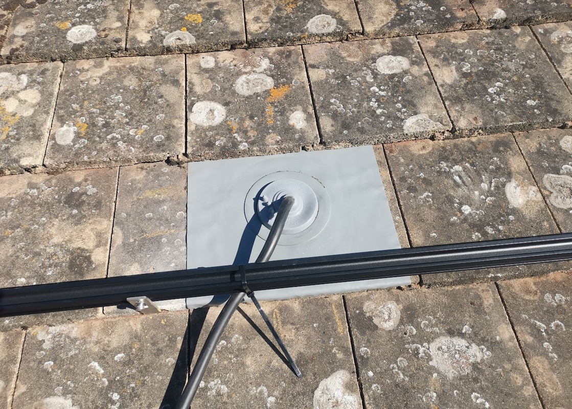

Got the third rail up, and also the cable entry done.
There's probably not many installers that do this correctly.
Another thing I forget to mention yesterday, is when installing the roof hooks, its very important to drill pilot holes, failing to do that could mean split roof rafters.
Not as much progress as yesterday, but I need to allow a full day for the top rail, in case I need to take the ridge tiles off.
Looking very professional. Its a pity those roof hooks have the rafter plates in that orientation, vertical would have suited a lot better and less risk of weakening the rafter as the fixings could have been spaced well apart.
So when is the chimney and unused TV aerial coming down Ron ;)
They are done like that so the hook can be offset from the rafter to match curved tiles, which would increase the twisting motion of the bracket relative to the rafter, should probably have extra wood screwed to the rafter, but that probably doesn't happen often.

Got the top rail installed for the 8 panel array, which meant removing some ridge tile - if I didn't the roof hooks would be 300mm lower down and the panel overhang would be too much - how many solar installers remove ridge tiles????
All four rails in place, although I need to square them and level them.

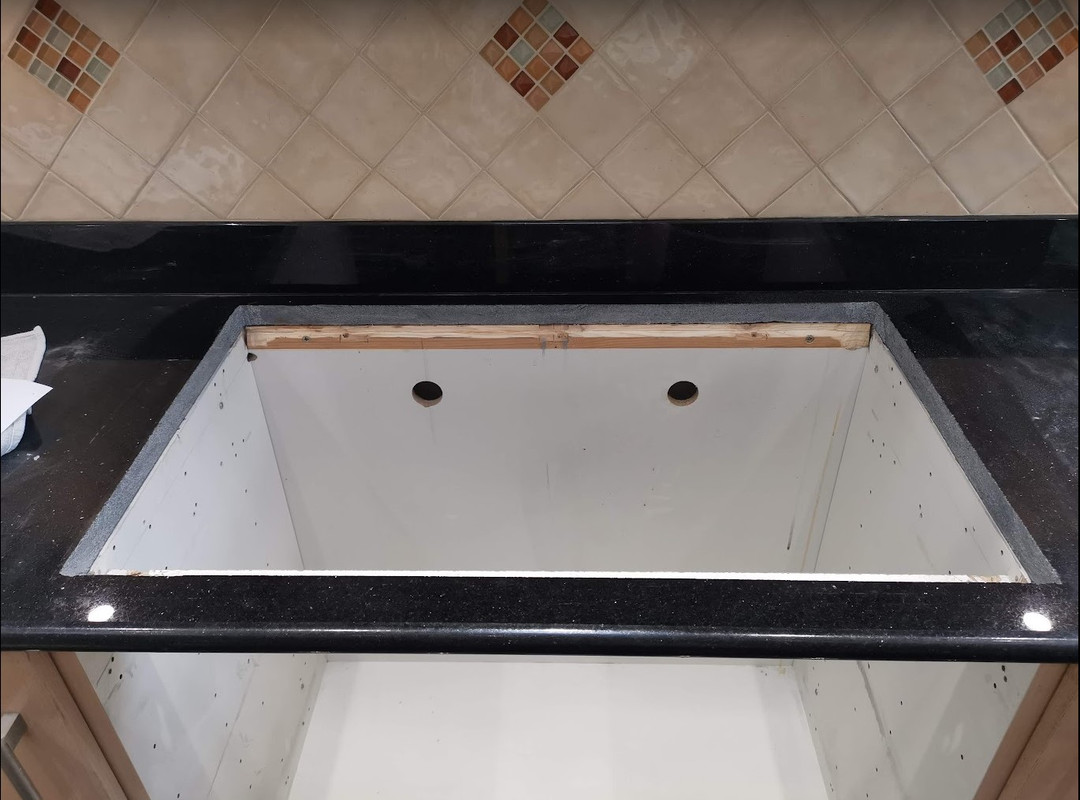

Yesterdays weather was horrendous, so it was time for some work inside the house, one of the reasons I.m fitting more solar is that we want to move away from gas, first thing to go is the gas hob with an induction hob being fitted.
The cable for the hob was run in last year when the garage work electrics was done.

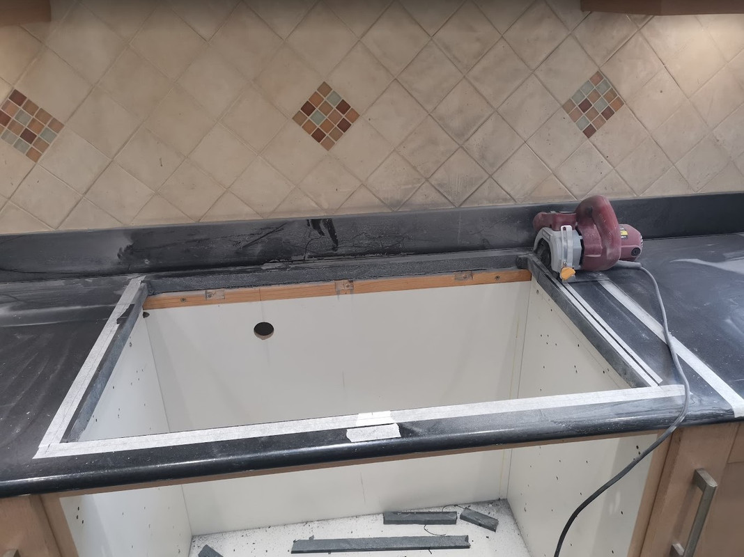

The hole for the hob was a little too small, and needed to be enlarged, only problem, the worktops are 30mm thick granite, but I don't let that worry me!
Although I've marked the front for cutting, it was decided that would leave a gap at the back of the hob, which would be difficult to clean, and as I could cut the back, that was what we did.
So it was just the back and the two sides which needed cutting, which was a very messy job! Luckily I have a saw for cutting, it uses a 115mm diamond blade.
Hole cut to size, and an extra air vent cut in the rear of the cabinet.
Squaring out the corners was quite tricky, but managed to remove sufficient for the hob to fit.

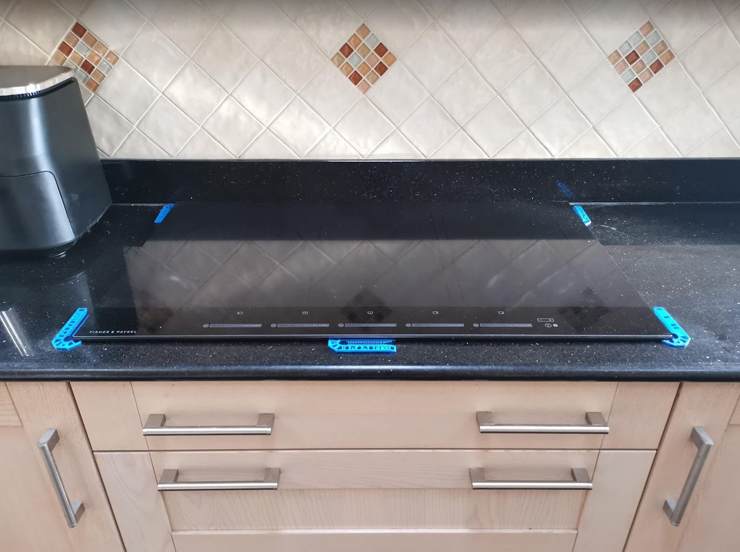

Luckily my bargain induction hob fits - it was ex-display and I got it for less than half price.

I got induction hob fitted when i moved to this house 10yrs ago. They are brilliant to be fair
We did the kitchen in 2005, and I made the decision to fit a gas hob, my brother shortly after did their kitchen and went for an induction hob, and I realised I should have as well, so its been a long time coming.
Ever since we removed the gas hob a month ago now, we've been using a portable double induction hob, and its been very good.
Nice job, cutting that kind of work top is pretty risky.
Our ‘de-gasification’ started with an induction hob, we the. Got the solar and ended with the heat pump.
When I did our hob it went into an oak worktop when I refit the kitchen. Easy enough to sort out with a jigsaw and a decent blade.
We haven’t looked back since getting it although it slightly annoys my wife you can’t use the cheap pans anymore.
