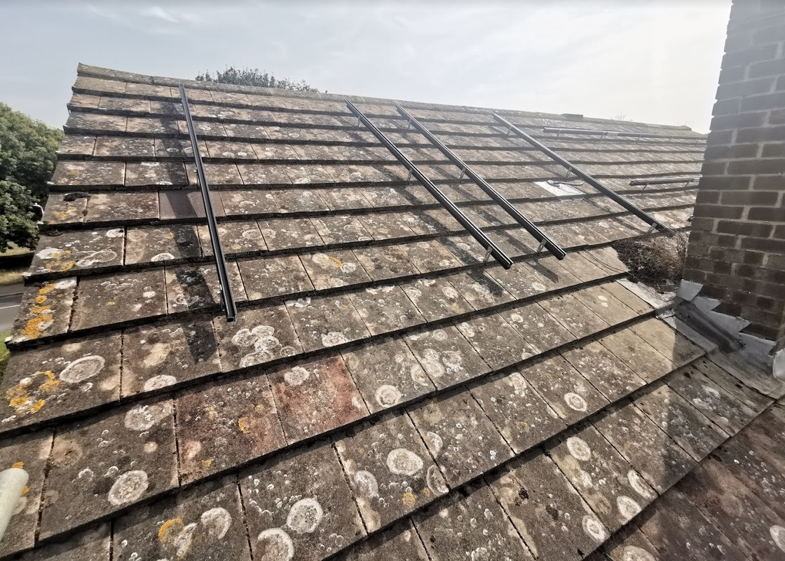

The weathers forecast for 20 to 24 mph winds tomorrow, so I took today off work, and cracked on with the last four roof brackets, it got a bit windy late afternoon and I was knackered, so I'll finish fitting the roof rails on Sunday.
Had to take off three ridge tiles in the middle, then I could slide the tiles either way to fit the each end hook.
PS. I've got some Wet & Forget to spray the roof with, will likely do that Sunday as well.
I see shade. Micro optimisers?
No, optimisers don't play nice with Victron MPPT solar charge controllers.
The roof I'm doing has 12 panels, they are wired in three parallel sets of four (4S3P), so whilst the four in the above picture would be affected by the shading, the other eight will not, and its only mid to late afternoon the chimney starts shading those four panels (picture was taken at 16:15). Its the main reason I've done those panels landscape, the shadow comes up from the bottom of the roof as the sun goes round.

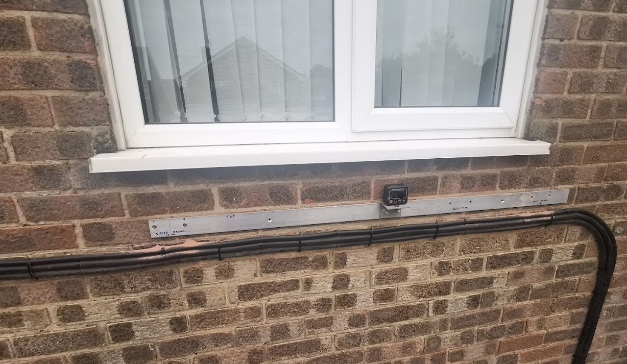

I got 24 holes drilled, 24 M8 stainless steel studs cut, and 24 studs resin bonded into the rear wall of the house.
I made up a jig, so I could accurately drill the holes, it had all the holes required for two panel mounts, and another set of holes for the next panel, just needed to move it over, level, secure and drill, and repeat.
Think I'm pretty much ready for the electricians.
Roof rails are done and ready.
This is 13:00, and that shadows well out the way at the moment.
The rear wall mounts are all bolted in place, and ready for the panels.
I do need to put some new LED wall lights along the bottom just below the panels, and some conduit up behind the panels to feed the lights.
Also a few things to sort out on the roof, but that can be done after the panels are fitted, or before if I get time.
