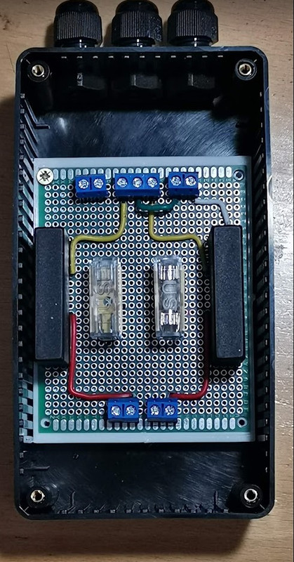

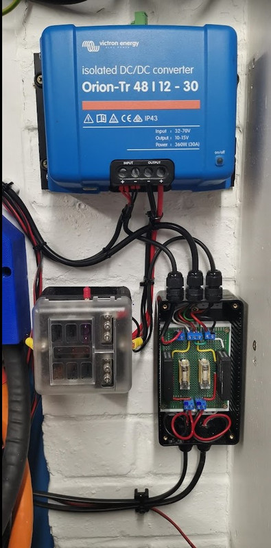

During my solar additions earlier in the year I had to remove my battery heater system, it was also rather messy as well.
So I came up with a bit better solution. As the relays in the Cerbo GX can't handle the current of the heater mats, I've had to use external relays.
My solid state relays are now mounted on a little PCB, in a box, the relays have built in heat protection, but hopefully that won't be a problem anyway.
And the new setup.
