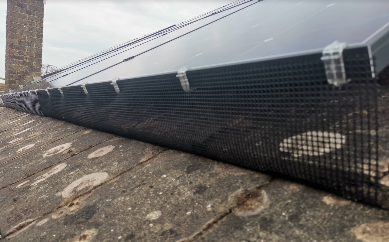

In the picture below I'm using Enviroguard 30mm SolarGuard Clear Speed Clips, these clip onto the edge of the panel that doesn't have lip underneath.
For the sides with the lip, I'll be using Enviroguard Budget Solar Guard Clip, both from City Plumbing.

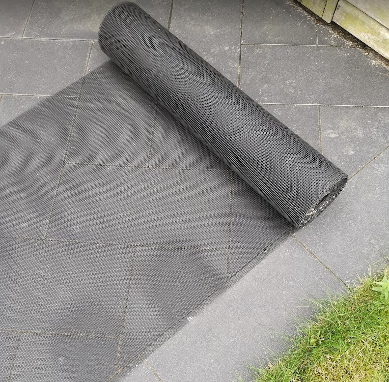

For the actual bird mesh, its simply plastic fencing, with a 5mm square hole, I bought a huge roll years ago when I did the Solaredge system.
The bottom edge is tucked under the tiles.

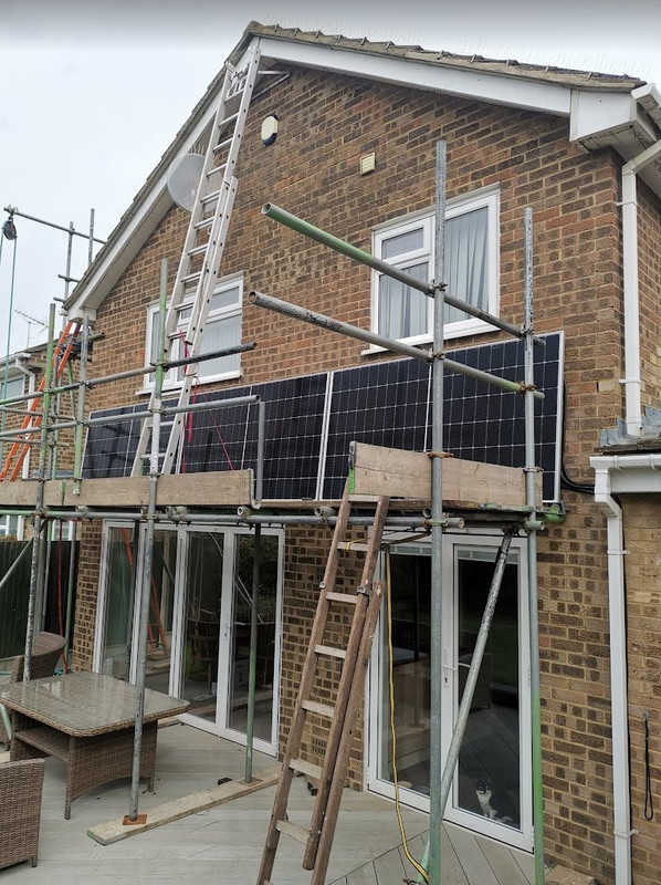

Anybody fancy working at height?
I've secured all the ladders with ratchet straps.

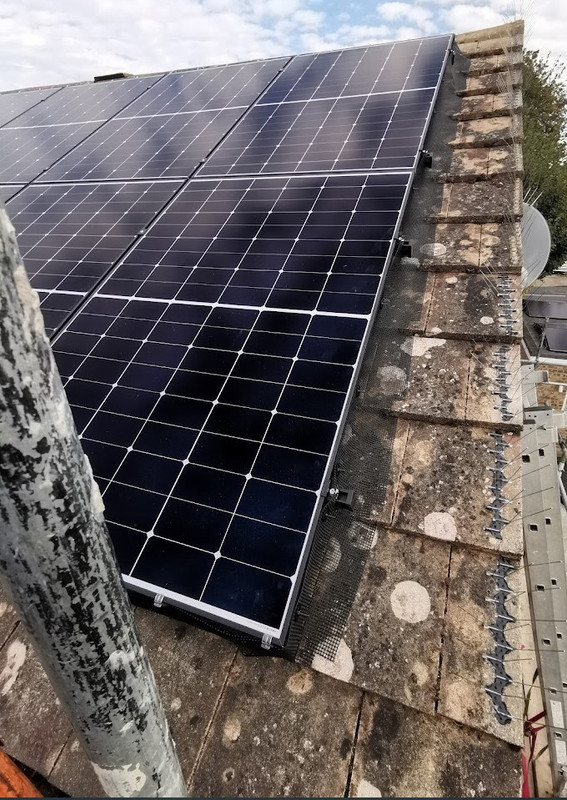

This was to fit the bird netting to the rear edge of the panels, bit tricky as I had to work one handed whilst hanging on with the other!
View from the top of the ladder.
Rear edge, this is what I had to fit from the ladder.

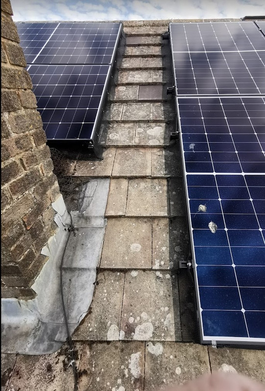

Netting up the centre, birds have already messed on the panels - the end of the aerial is just above the panels.

Just need to get the scaffolding taken down now.

What does the wife think of your new drip feed to anyone using the patio doors after rain Ron ? Mine would tell me that's a panel or 3 too far ;)
She took a bit of convincing, I said it will also help keep the bird muck off the bi-folds :cry:
