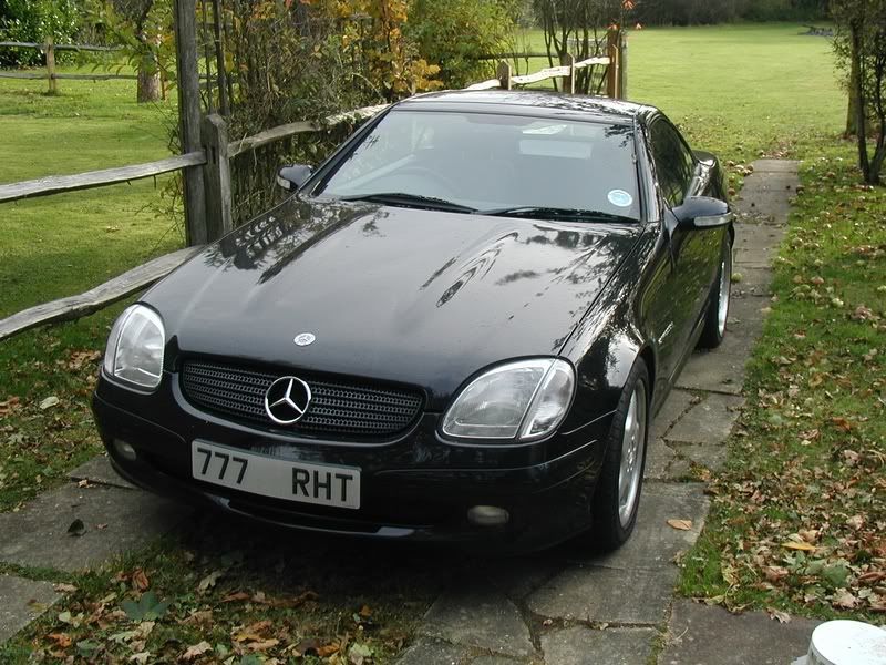

There is a mercedes benz in the background of one of the pictures, i am asking if he has any pictures as i am interested in mercedes cars :)

Here ya go Jez
