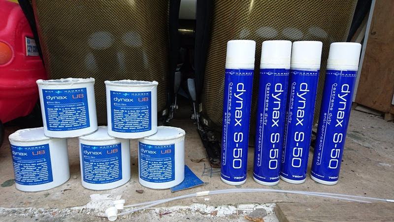

I found the Bilt Hamber Dynax stuff great when I did my mx5. The UB brushed on nice and easy without any real mess. The S-50 for inside the box sections come with a 360° spray Lance and coats inside box sections very well. I had before and after pictures using an endoscope and everywhere was fully coated. I did my 5 in 2016 and it's still going strong with the current owner and not showing any signs of rust (which for a MK2 is very rare, although it was a fresh import in 2012)
