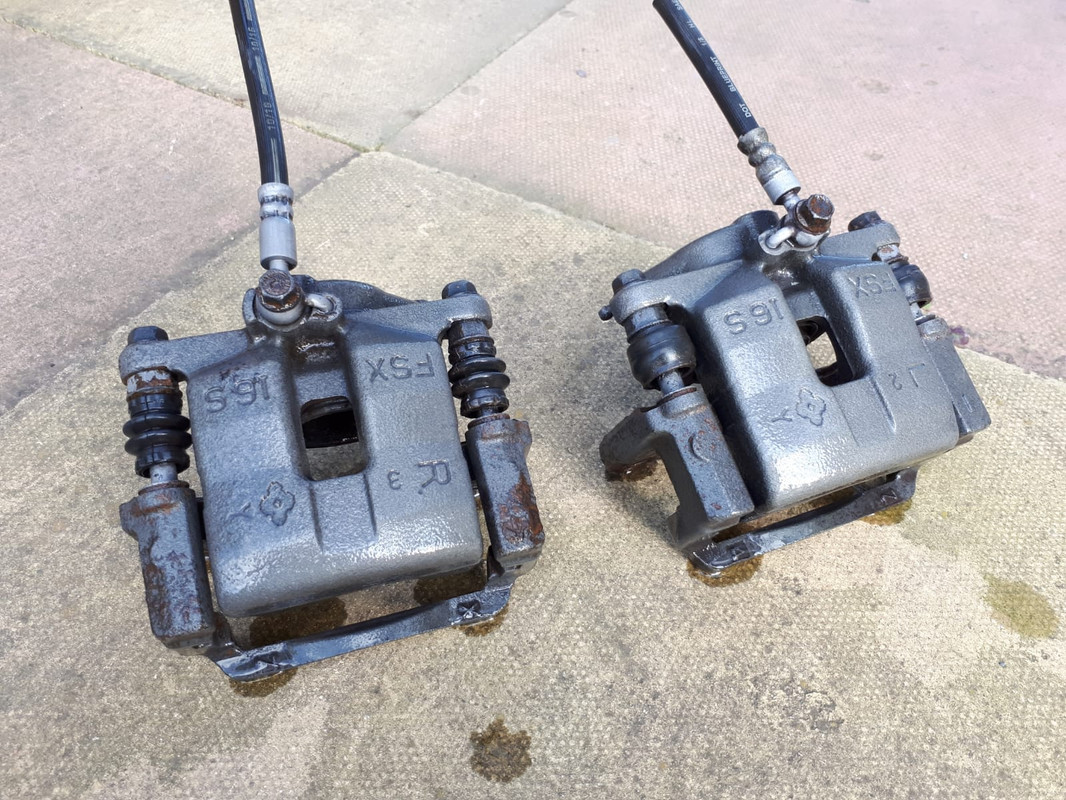

The easiest way I found of removing rust from brake calipers is by using Bilt Hamber Deox C. These are 20+yr old mx5 calipers that were submerged in a solution of it. The calipers can go in complete as the solution doesn't affect any of the seals or brake hose
I've heard the same and recently ordered some for that very purpose, not actually tried it yet but the results look pretty good to me :) And it's environmentally friendly too so no hassle to dispose of it, seems win-win...
I believe they reccommend painting/coating them pretty soon after removal as it leaves little/no protection?
In that video he said you can get a black version which is the same liquid but with graphite added.
I saw that bit ... he didn't seem to say, but presumably, graphite makes it a bit more viscous/resilient
you masked the bores ? seems risky without that as google also suggests - a gel type product sounds easier to contain in that respect.
Both are safe on rubber, but you don't want the Deox-C going into the piston bores, If you get the solution in the bore you would need to dismantle to dry, if there's any doubt that you can’t keep it dry dismantle the assembly first, block the bore then soak – this is our recommended method. :D
I have some BH products. DEOX gel and some other barrier stuff. These callipers look great for their age.
