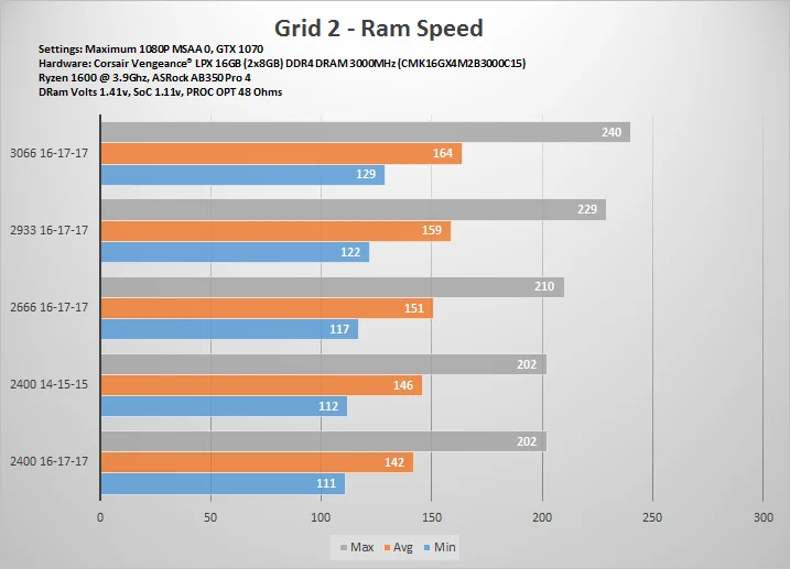

There isn't much information around about how much extra performance you can get with faster Ram on Ryzen 1, so to satisfy my own curiosity i spent half an hour testing, the results were surprising.
Just one game, i may or may not add more later.
Grid 2: Maximum 1080P MSAA 0, GTX 1070.
Corsair Vengeance® LPX 16GB (2x8GB) DDR4 DRAM 3000MHz
CMK16GX4M2B3000C15
Ryzen 1600 @ 3.9Ghz
Other relevant settings:
DRam Volts 1.41v
SoC 1.11v
PROC OPT 48 Ohms
Results: Chart made by Armageus, thank you :)
2400 16-17-17
Min: 111
Avr: 142
Max: 202
2666 16-17-17 (+11%)
Min: 117 (+6%)
Avr: 151 (+6%)
Max: 210 (+4%)
2933 16-17-17 (+9%) Total (+23%)
Min: 122 (+4%) Total (+10%)
Avr: 159 (+5%) Total (+12%)
Max: 229 (+9%) Total (+13%)
3066 16-17-17 (+4%) Total (+27%)
Min: 129 (+6%) Total (+16%)
Avr: 164 (+3%) Total (+16%)
Max: 240 (+5%) Total (+19%)
Timings scaling:
2400 16-17-17
Min: 111
Avr: 142
Max: 202
2400 14-15-15
Min: 112 (+1%)
Avr: 146 (+3%)
Max: 202
It seems timings make some but little difference, outright speed has about 55% scaling.
