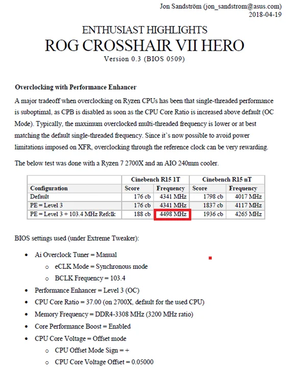

https://www.reddit.com/r/Amd/comments/8eaves/2700x_up_to_45_ghz_in_single_threaded_loads/
4.5Ghz.
Most reviewers got 4.3Ghz just by setting everything on auto and upping the clock multi, Guru3D got 4.4Ghz that way, its not surprising that with a bit of work fine tuning 4.5Ghz is in reach on a good board.
Yeah but read the thread from that post and you need to mess with the base clock that can lead to all kinds of stability problems and adds latency. Ok for getting high benching numbers but for myself I would stick to the auto method and get a fast rams kit as that seems to be the way to go for better 24/7 settings.
4.5Ghz.
Yes but don't forget it's single threaded loads there, it's still using the same boost rules of less threads higher frequency.
