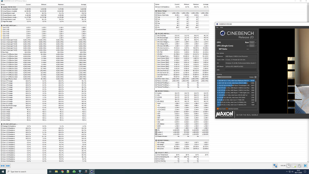

Ryzen 5800x 87c in Cinebench...
When you say manual is that a manual voltage only or a manual all-core OC?
AutoOC/PBO off in bios, then just using Ryzen Master setting to manual mode for both clock and voltage
I'm just running at stock settings though for now until the new bios stuff comes out. Good thing is the system is totally silent, I can't hear it in games over room ambient noise which is a huge change from last system build.

Hey guys! Just finished building my new system with a 5800x and 3070 (after a few headaches with bios flashing..)
I just tested in Cinebench and my CPU hit around 85-87. Is this anything to worry about? Is the Noctua UH12S capable of cooling this cpu effectively? It quickly dropped to mid 30s after the test.
Has anyone tested in Cinebench with this cpu and gotten similar temps?
Thanks in advance!
Simple option is to stick a second fan on that cooler if it has only one like the stock pitures. Does it come with a second fan holder clip ? If so order a second fan and set them to push and pull. That will drop at least 5-7c maybe more.
