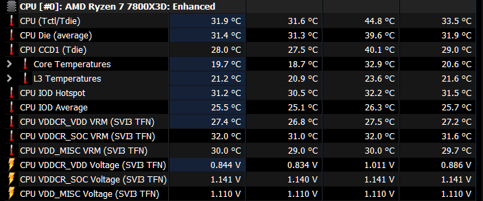

Mine with voltages;
Think have optimised the hell out of it now, both cpu and memory end (no clock generator on the motherboard for overclocking). All subtimings done etc and system silent, just gotta enjoy it now :D :)
Wow how did you manage that? That's amazing! :eek:
Good chip combined with decent cooling I guess, the 360 AiO is complete overkill for it but I had it sitting here so decided to use it as the Dan A3 was setup for negative pressure so all heat exits through the top and back (with no incoming fans but lots of mesh for cool air intake). Very happy with it!
Ah very nice! Mine is on a custom loop and still higher temps. Enjoy it my friend :D
