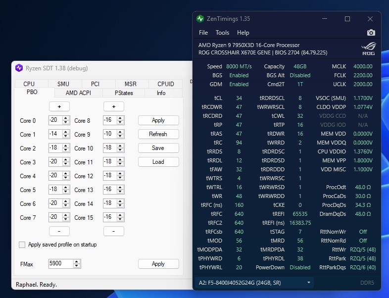

have been doing some more PBO -ve optimisations and it is very odd, per core -ve seems to be very dependant on the -ve curve on the worse core
get to a stable point (and no further) with say that worse core at -4, ie you get to a point where -ve point is optimised for each core and pushing any of the other cores past that stable point and prime95 all cores fails one or more cores and over time even causes a complete reboot (after several hours). Make that worse core then -3, and suddenly you can go -2, -3 or even more further past that point on most of the other cores very odd
I'm interested to see how far it goes -I think I posted this previously but whilst I don't under stand this inter-core voltage relationship, working on that worse core and allowing for more negatives on the other cores at a guess is better for gaming but worse for a completely all core load like video rendering
the inter-core voltage could possibly I guess be just a relative voltage, as in if the worse core is set to a "higher" -ve curve (as in -3 vs -4) then maybe the average voltage across the other cores is slightly higher thus allowing better -ves on the other cores so you are not actually gaining anything at all -not sure

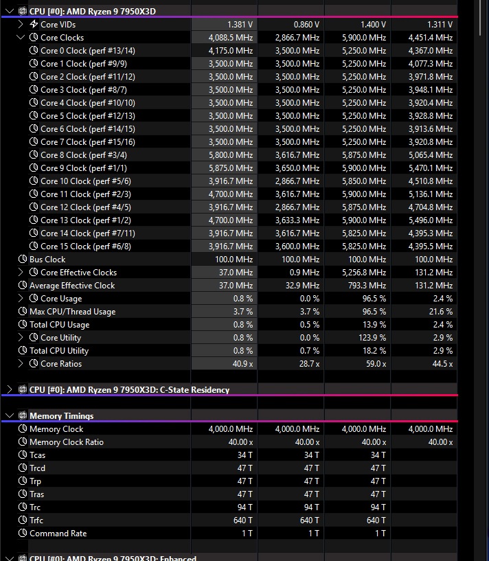

small prime sits at just over 4.5 gig when all core running, pulls about 74W and after 10 hours CPU is 56C which is not bad for cheap air cooling !
get to a stable point (and no further) with say that worse core at -4, ie you get to a point where -ve point is optimised for each core and pushing any of the other cores past that stable point and prime95 all cores fails one or more cores and over time even causes a complete reboot (after several hours). Make that worse vecore then -3, and suddenly you can go -2, -3 or even more further past that point on most of the other cores very odd
You have to find a balance, its a PITA, RAM overclocks eat into PBO, so I just upgraded a couple of weeks ago to a 48gb kit from a 32gb kit, running it at 8000MT/s CL34, the same as my 32gb kit, but ive had to start all over with my CO, im not getting anywhere near the amount of -curve that I had with my 32gb kit.
It my understanding there is only 1 algorithm for the CO to each CCD, so as far as im aware, regardless of if you set 1 core to -20 and one core to -10, its averages it out, so effectively it would try -15 to every core.
Also finally, I had to go through 4-5 7950X3D's until I got a decent one, I ordered some off the rainforest and sent them back, "performance or quality", ordered one off OCuk and got a good one straight away, maybe the rainforest arnt storing them correctly, but it very very pot luck if you get a good chip with a decent IMC in it, 9000 series isnt any better as it uses the same IOD from 7000 series.
So anyone can test this theroy really, if you have your best core set way lower than your other cores, say -5 for your best core and -15 for the others, see if you lower your others to -10, if your best core will also do -10 or -8 now.

So I have finally got round to installing the 7950x3d I picked up for tinkering fun. Any overclocking tips? Is it similar to the 7800x3d or less wiggle room for overclocking. I see the core boost over ride. Is this like the 7800x3d where you can only get +50 mhz or is it more like the 9800x3d where when you select +200 you can get a freebie 200 mhz boost.
Yeah......no, if you cant be bothered just stick it in and enable PBO, I can do +150mhz on mine, but it took a lot of work to find limits and curves, a lot of homework and studying, and with the RAM overclock, took 2 weeks to get fully stable, verified with Core Cycler, Y-Cruncher, Prime95 Blend SSE, AVX2 and AVX512, Memtest Pro, Karhu, and AIDA64 Stress test, all 12hour ish overnight runs, TM5 for initial ram tests as it picks up errors really fast.
