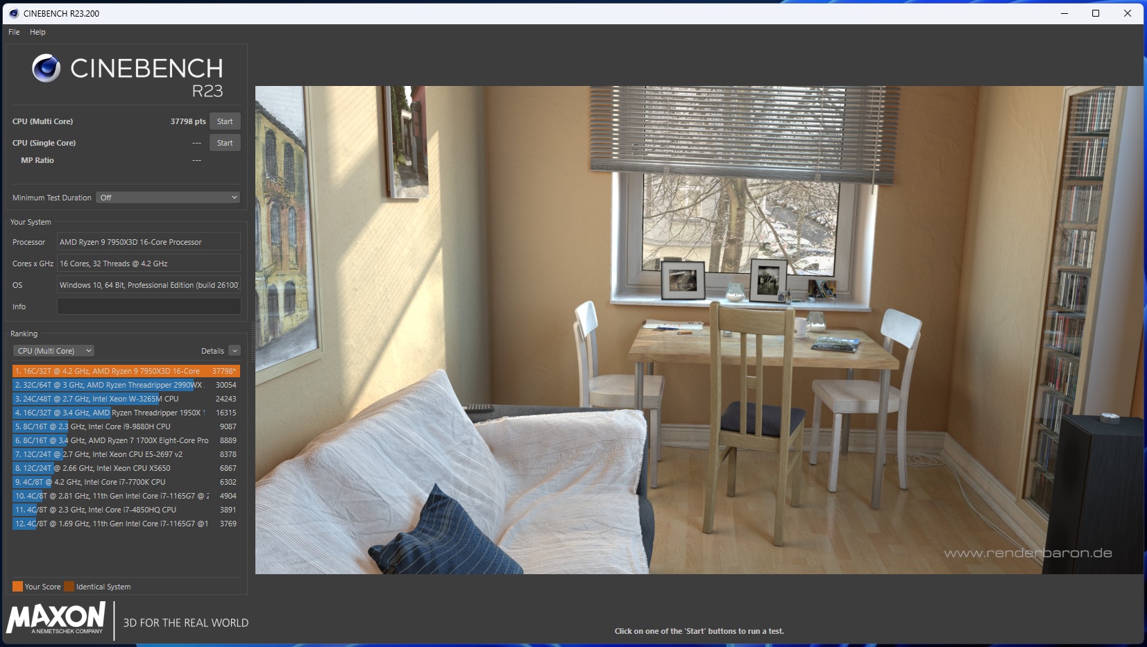

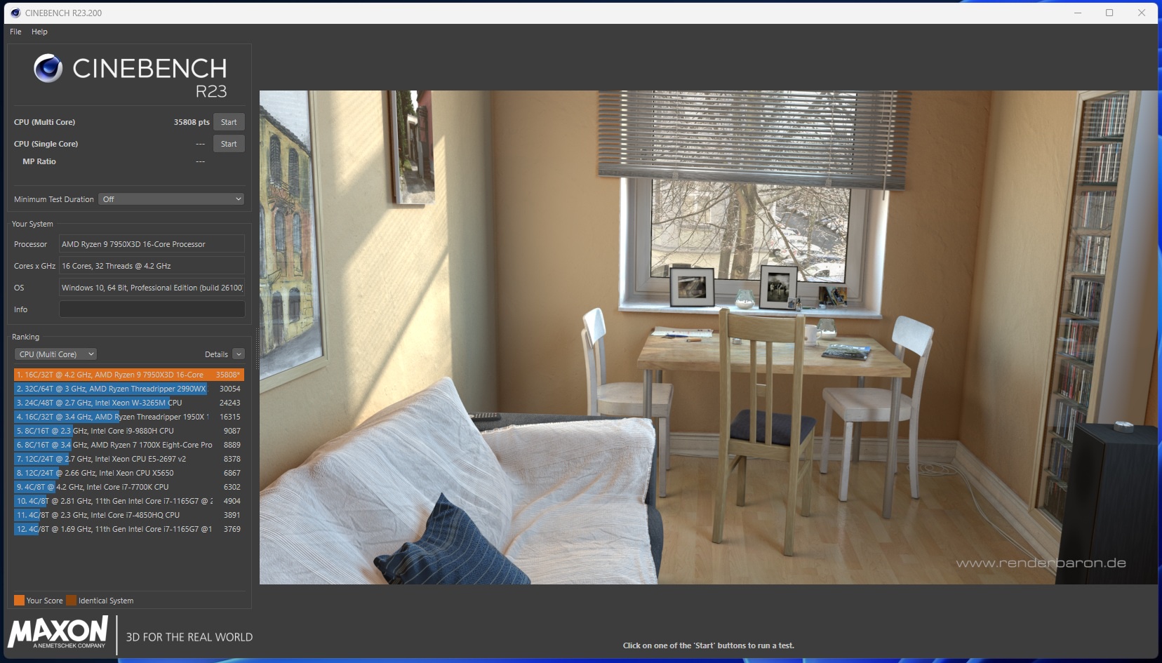

Sorry, another thing I found, and I dont know why it effects things so much, was LLC played a big part in things, if I set LLC to 5 for instance, which ASUS bioses label best for overclocking, my scores in things like cinebench are rubbish, but if I set LLC to 8, my scores are great, you have to make sure you set this first though as it effects how much CO you can apply.
LLC Lvl 8
LLC Lvl 5
@Jamin280672 Thanks for your insights. I think when I first went into the bios for it I set the LLC to 4 and I think my scaler is at X1. So I only score something like 33k-34k in CB23. Personally I am not a fan of setting a high LLC.
I do have eclk option on my motherboard and I will consider it once I dial the CPU in more. I do believe I used a rather more conservative negative CO something like -15 as it a nice middle road number.
