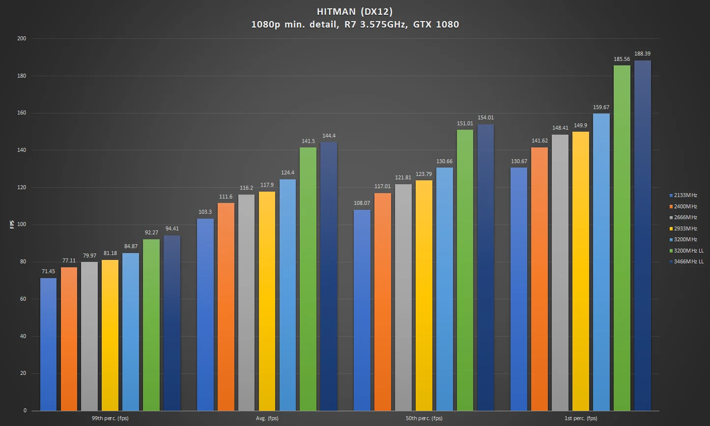

Also to add to the above Ram plays big factor on the Ryzen. The difference on fps and metrics between 2133 ram and 3466 is around 40%. Because of how Infinity Fabric works

What are you basing 40% on, that one screenshot of the hitman bench?
The hitman, (humbug had more)
In addition to AMD blog
https://community.amd.com/community...emory-oc-showdown-frequency-vs-memory-timings
where even Dual Rank shows performance gains over Single Rank ram.
What is LL, Low Latency? so like 12 or 14 CAS or something? (Because that jump on the green bar is quite significant)
Yeah low latency. It will be CL14, I dont think anyone has managed CL12 on anything higher than 3200.
If you can manage 3466 CL14 there is no point go for 3600, bigger improvements come from tightening the subs.
