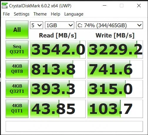

I'm currently getting these speeds on the same drive.
https://i.imgur.com/A2sRT0I.jpg
Hi pesst
I think your m2 connector may provide only 2 lanes of PCIe. To get the best out of your Samsung 970 EVO it needs 4 lanes. If you have a PCIe slot spare with 4 or more lanes, you could use a PCIe to M2 adapter.

Brilliant, thanks. I'll get one ordered and see what happens, your a star. :D
@pestt
Did you instal Samsung's NVMe driver? Also is your motherboard on the latest BIOS?
Yeah, did both. It seems the M2 slot on the board is only x2 as JR1 suggested and not enough. I've got the Akasa adaptor from OC coming soon so will put it into a pcie slot and hopefully should get the right result. Fingers crossed, will post the result as soon as I get it installed. Cheers.
