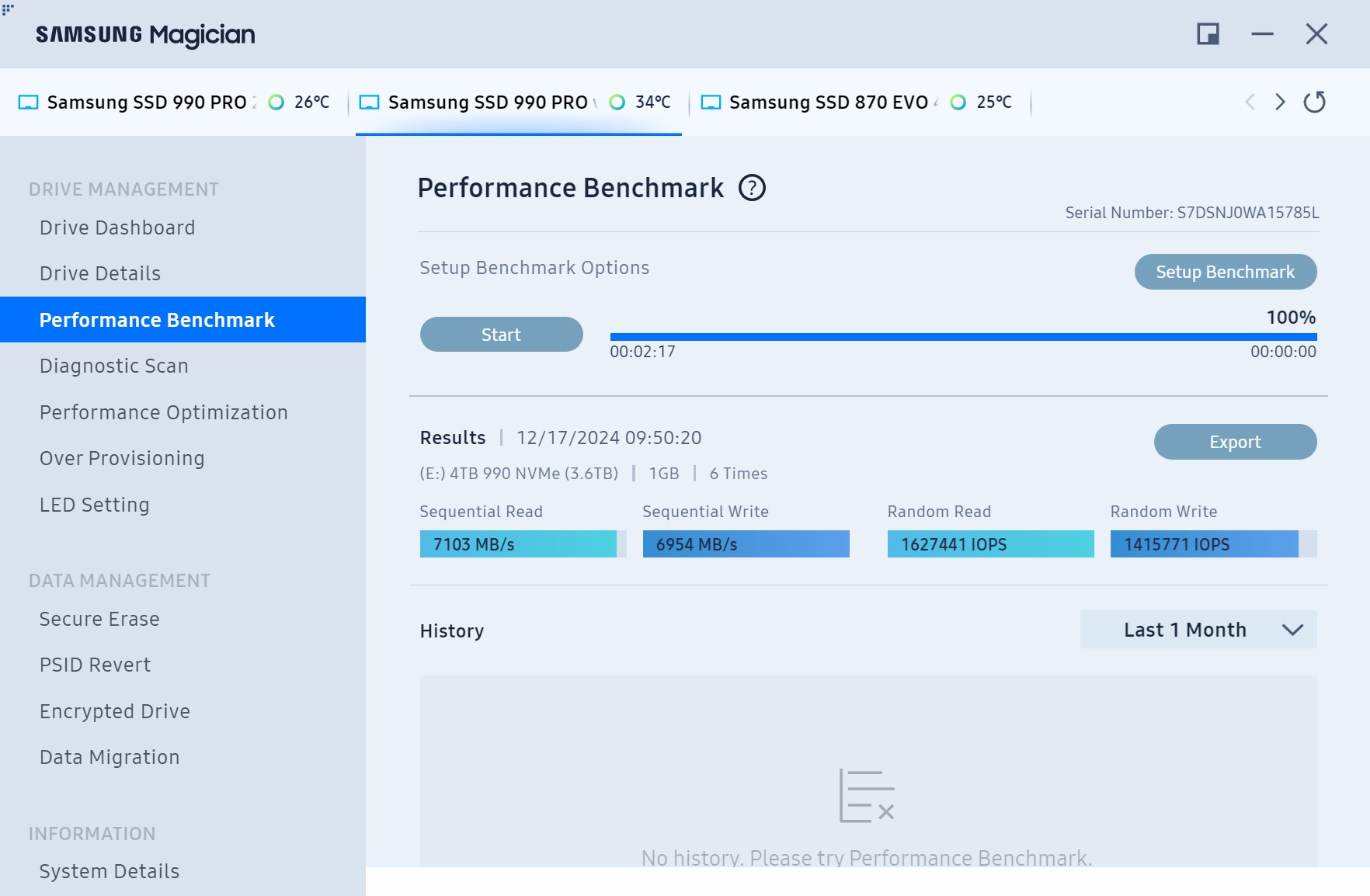

My 2TB 990 pro
My 4TB 990 Pro
Just bought another one of these though will take me a day or two to get around to fitting it as I need to take half the system apart to get to the M.2 slots :( so will do a comparison with my older ones.
Within normal benchmark margin of error for me.
My oldest 990 Pro:
One I bought a few days ago:
Having 2 of them sitting under the same motherboard heat spreader (along with an SK Hynix NVME) isn't doing wonders for the temperatures though - before the one there was running about 5C cooler idle than the one with the factory fitted heatsink on its own slot - now they are all about even temperature wise under idle or up to moderate use - though the ones under the motherboard heat spreader are still cooler under heavy load than the one with factory heatsink.
Thanks for doing this comparison. Interesting to see that the performance is just is fast on a new one. Still not clear why mine is getting much lower speeds than everyone else in Magician (and random reads in Crystal Disk Mark) but it's fast enough not to really matter.
I wouldn't spend time investigating, but a key question is whether your motherboard, Windows install, drivers or other software is making this small difference.
I've got lots of systems so testing such issues is simple, but if I only had one system I wouldn't worry about it given its close enough to spec. Chasing down the last few percent on parts of an overall system's performance isn't worth the time for me.
