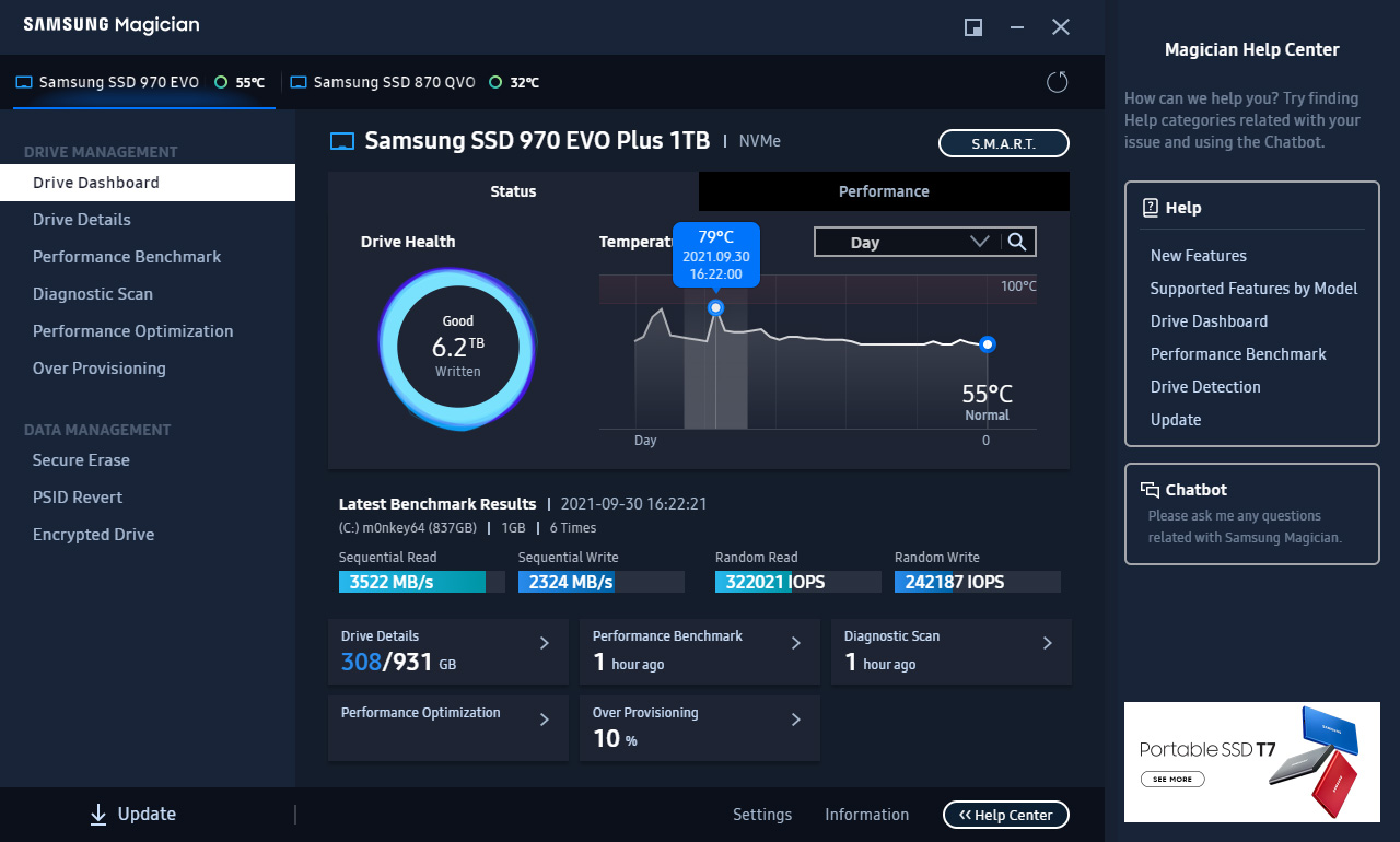

I guess this thread is relevant for this update instead of a new thread... Samsung magician has had a major update today to v7. Now the temp "status" shows as good when the 970 idles at 50+ which is what is expected for this drive whereas it was showing "Too Hot" in the old version. New UI as well and stuff has moved around a bit with some new features like temp history logging.
My 970 Evo Plus 1TB reached 83 degrees during the built in benchmark tests. I may invest in just a small stick on heatsink for just the controller on this drive if this proves to be a problem although I am not doing sustained heavy data writes to the drive much at all. Always small files with the odd video transcode here and there but they are written much slower than what would heat the drive up.
