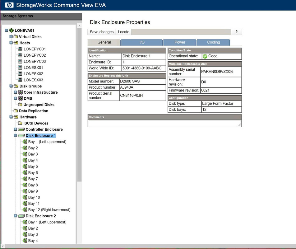

Both the 2600 and 2700 can also be used if you move forward to a larger infrastructure in terms of hp gear. They are the same shelves used in the eva and I believe they can also be used in later storage solutions from HP.
I love my old EVA but that's next to be replaced anyway those shelves are awesome, I can literally hot add shelves one controller at a time without downtime:
Also it's sensible to be tied to a vendor for most business applications where money comes second to uptime, performance and data retention. The disks are like they are because the EVA for example doesn't use traditional "raid" configurations for its disk groups, instead it uses a custom block algorithm which is mind blowingly complicated (feel free to look it up), anyway im digressing but effectively what it allows is greater resilience in the array if (when) you suffer multiple concurrent disk failures providing your not crazily provisioned. It saved my ass last year when we had two drives go down in a day followed by another one later that evening in the same disk group. basically providing the disks were not neighbouring disks we could have suffered even more up to perhaps 3 disks per shelf before we would be entering the world of data loss.
I have 4 hot spares sitting on the shelf, 4 hour turnarounds on parts plus 24/7 support and really it adds little to the TCO but is convenient. Who really wants to be searching for disks?

The firmware is something to do with the way the disks are grouped I am sure. You can have disk groups of almost unlimited size, for example my core infrastructure disk group (array) is 48 disks and is considered small for an eva and which although you could potentially do with a raid 10 array you wouldn't really want to as not many controllers will support that number of disks then what if the single array goes?
The eva picks a min or max parity size based on the number of drives so it can effectively shift data around in order to change the amount of parity delivered to the array. I hope that makes sense. For anybody interested the controller for an eva is a HSV340.
