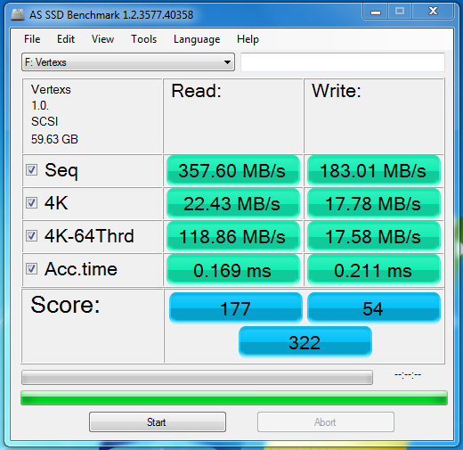

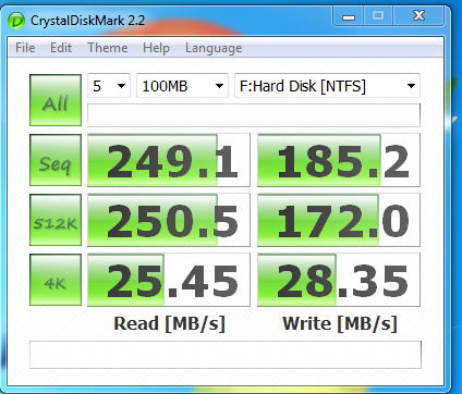

Ive got 2x 30GB Vertex drives in RAID0. Crystal Mark results are odd, 512K read is better than sequential haha, thought it was meant to be less?
And then using AS benchmark which is specifically for SSD's
