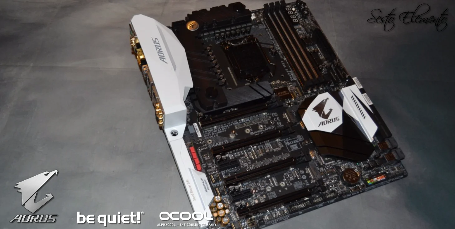

Intel core i7 7700K (De-Lidded)

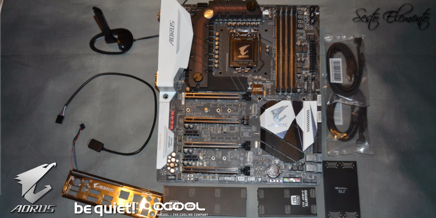

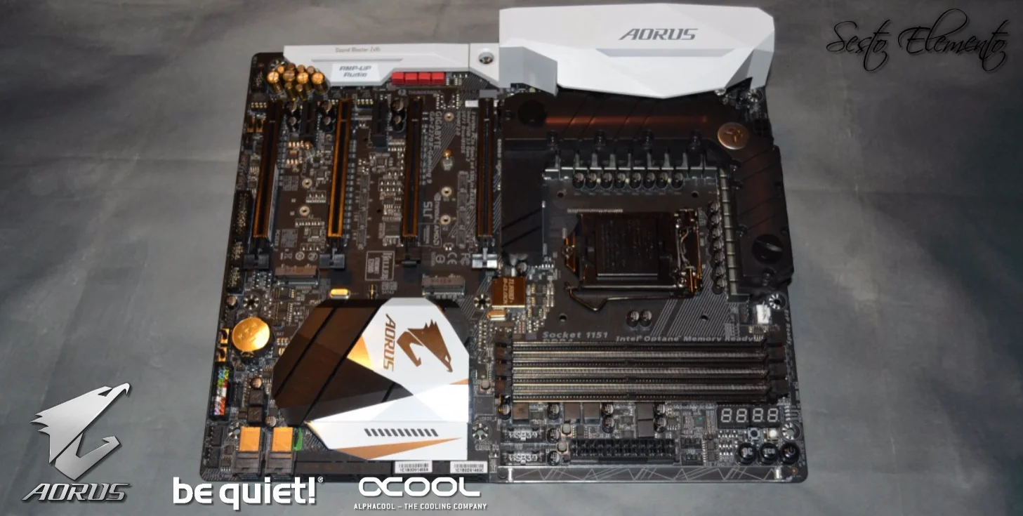

Gigabyte Aorus Z270X Gaming 9 motherboard
Gigabyte Aorus GTX 1080Ti Xtreme WB edition
16GB Team Group T-Force NightHawk RGB @3000mhz
Full alphacool watercooling (List to come)
be quiet! Dark base pro 900
be quiet! Dark power pro 11 - 850w

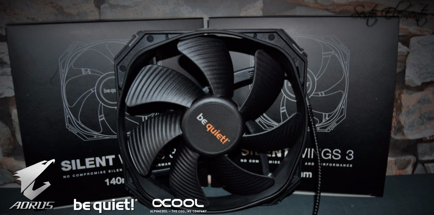

be quiet! Silent wing 3 fans (140mm PWM)
Will update this list as more parts are confirmed.

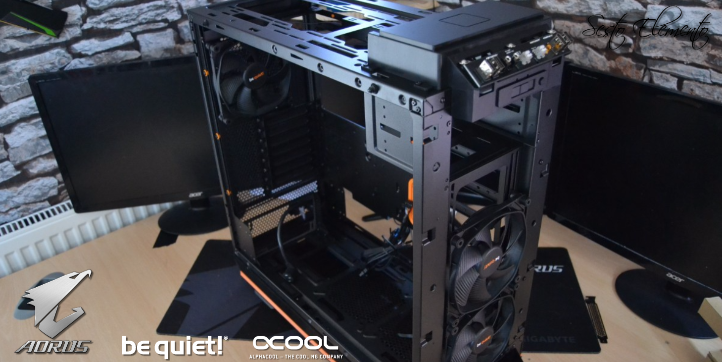

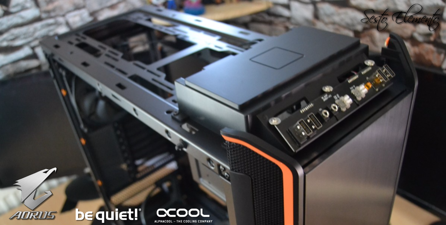

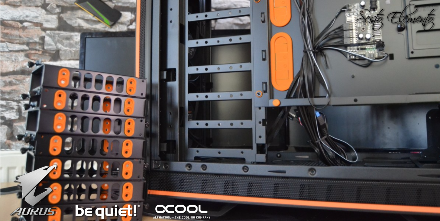

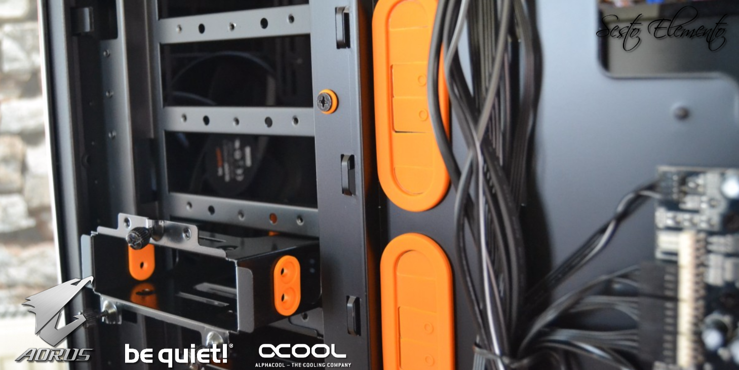

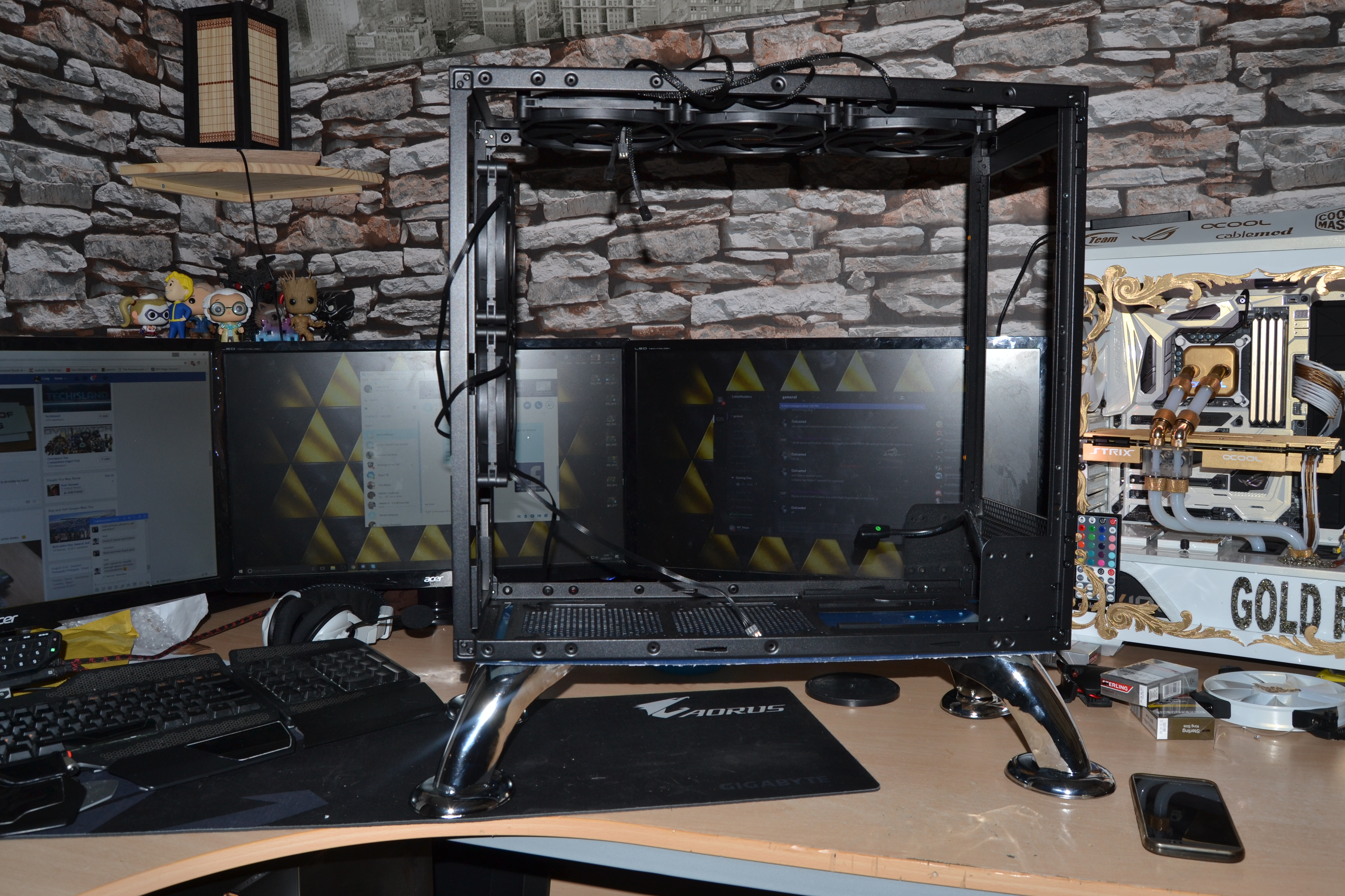

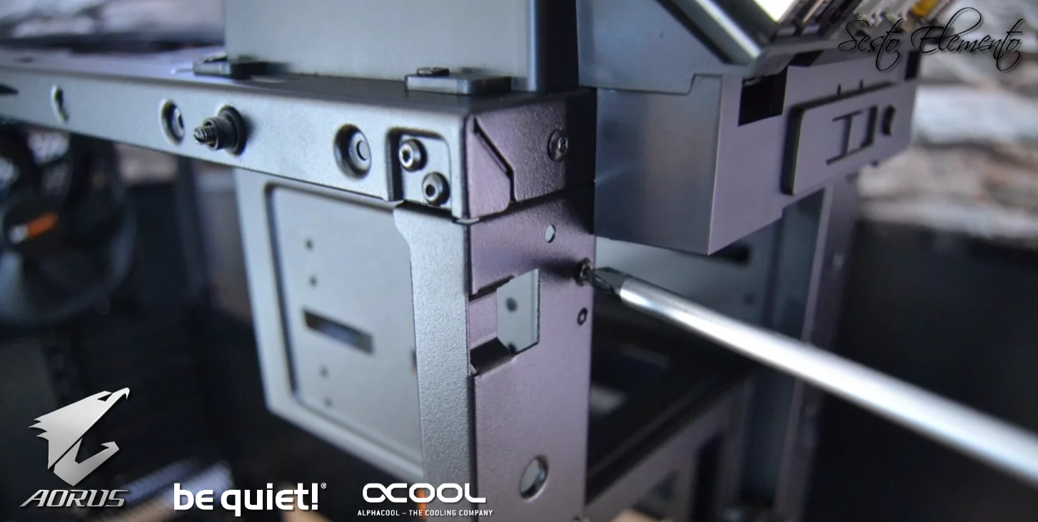

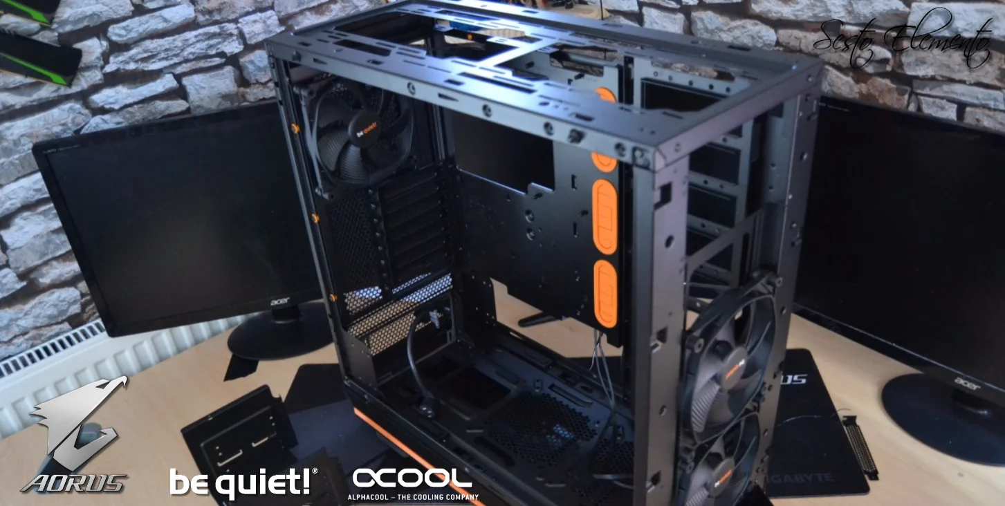

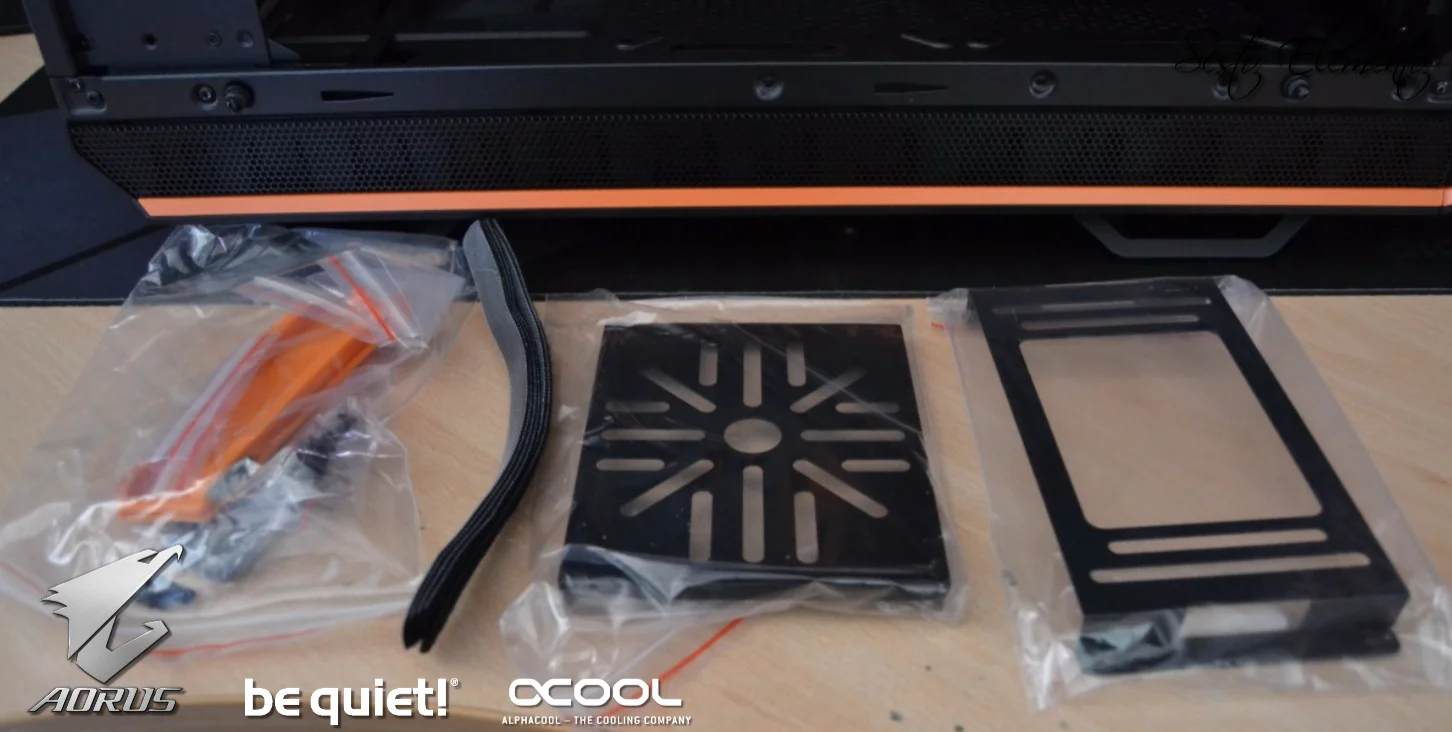

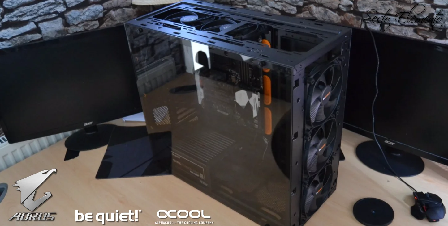

Case arrived and i Started work, by stripping back the case to it's underwear.
More updates will come in the following days :)
Thanks for looking

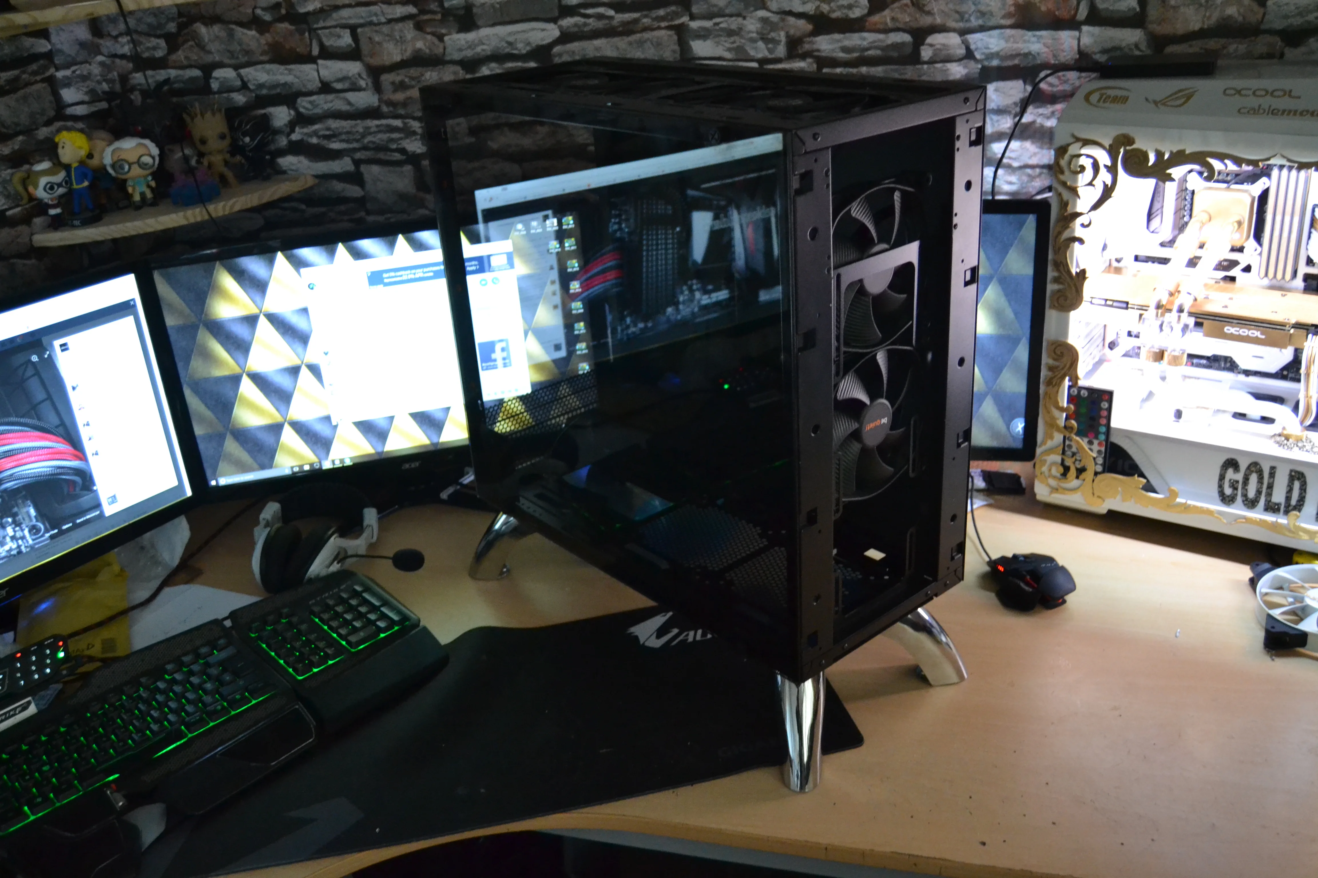

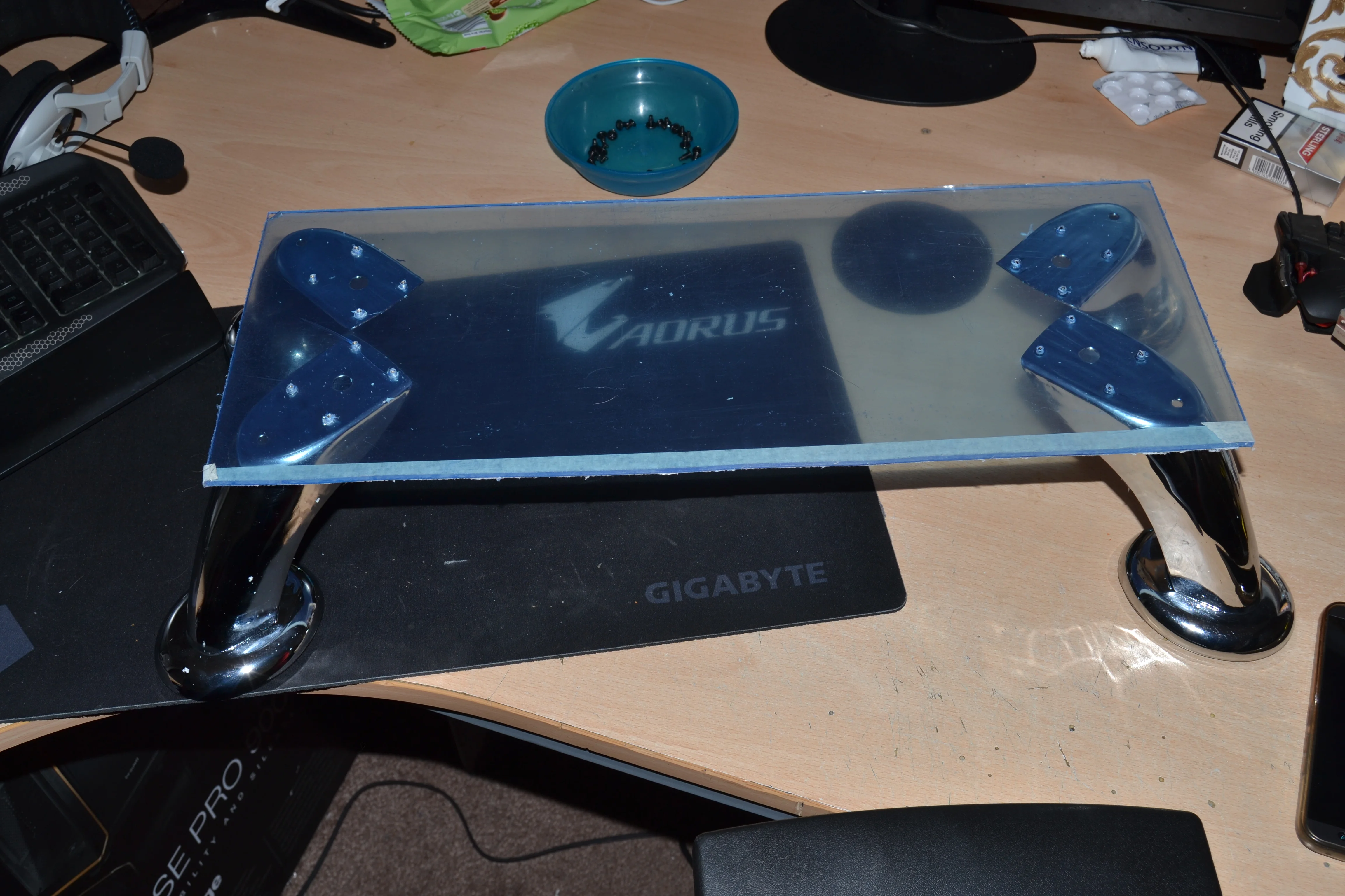

Slow progress as i wait for most of the parts to arrive.

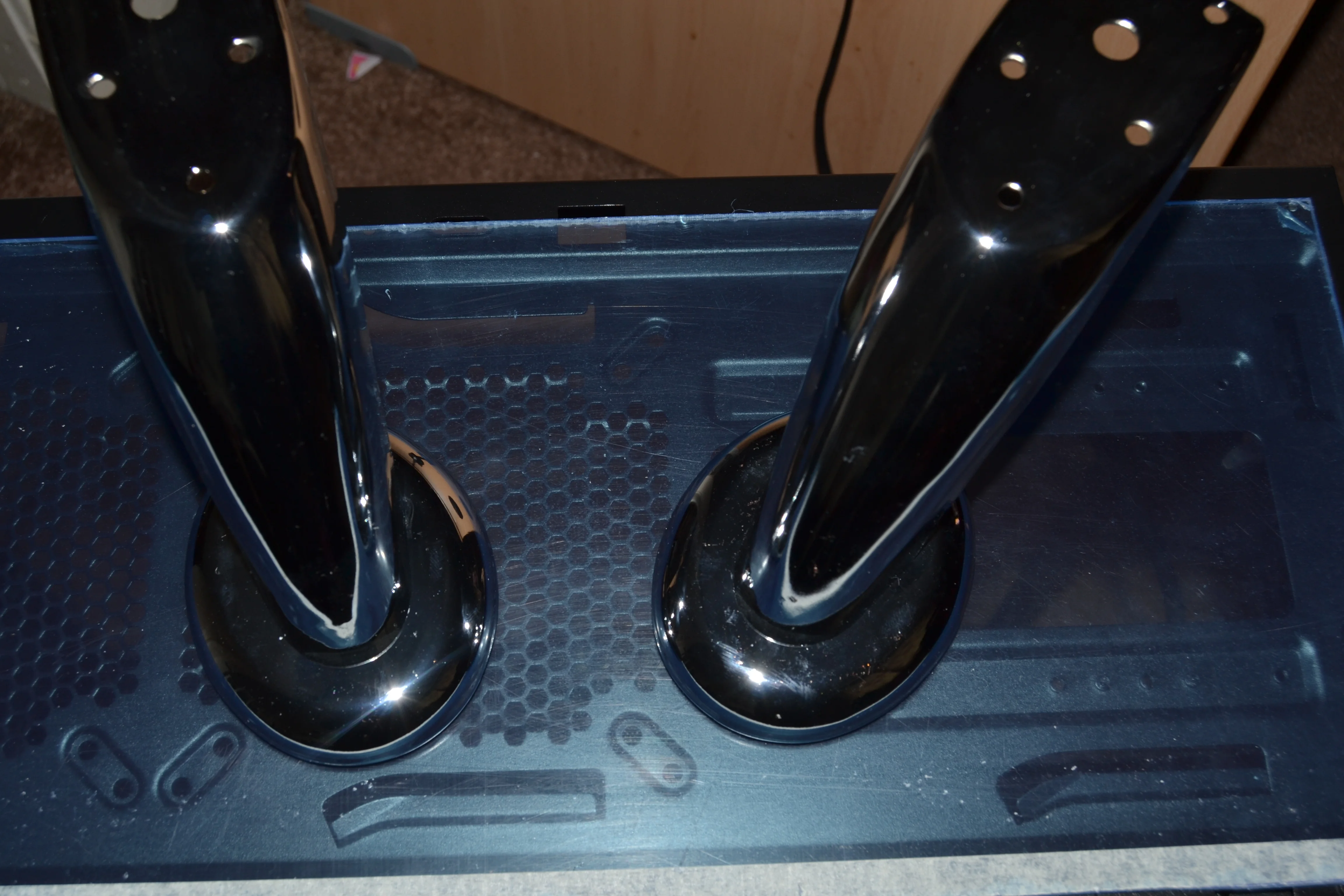

Today the legs arrived, so i've been test fitting them.
Will post as much as i can as soon as things start to arrive.
Thanks for looking.

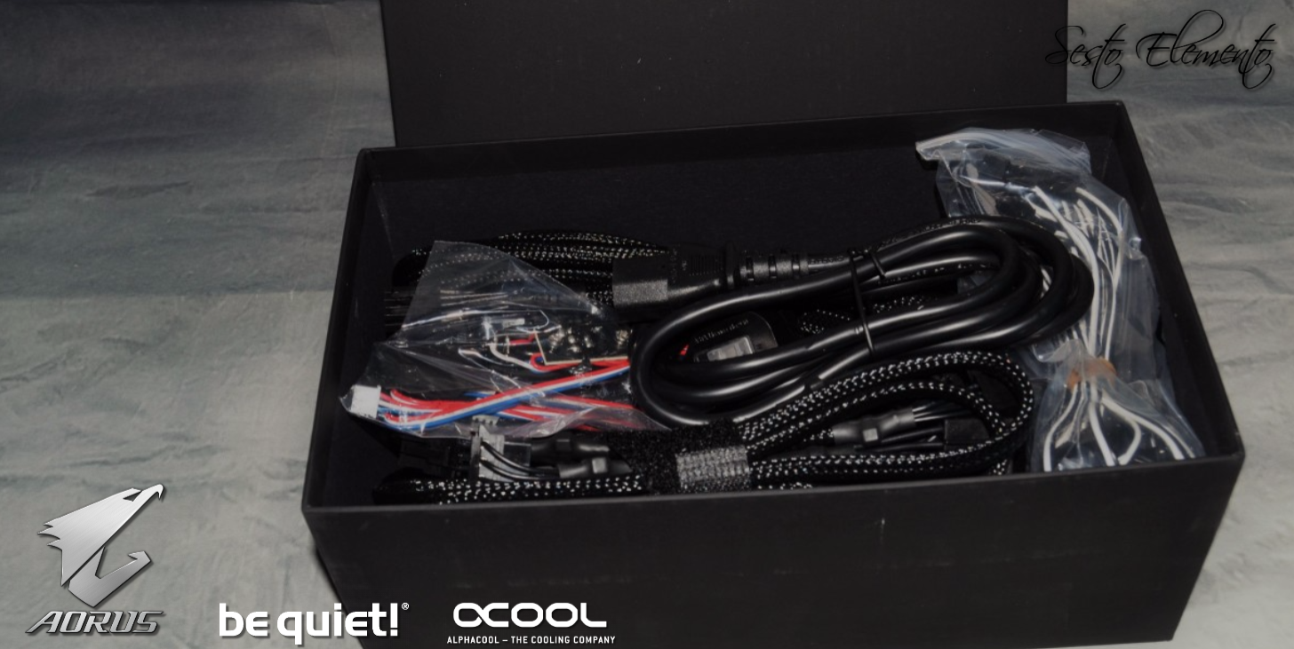

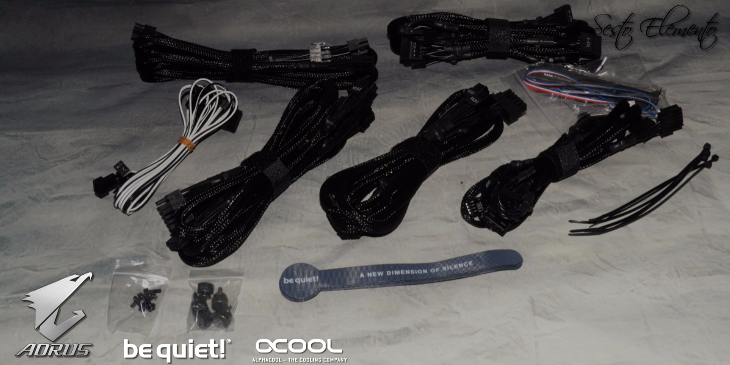

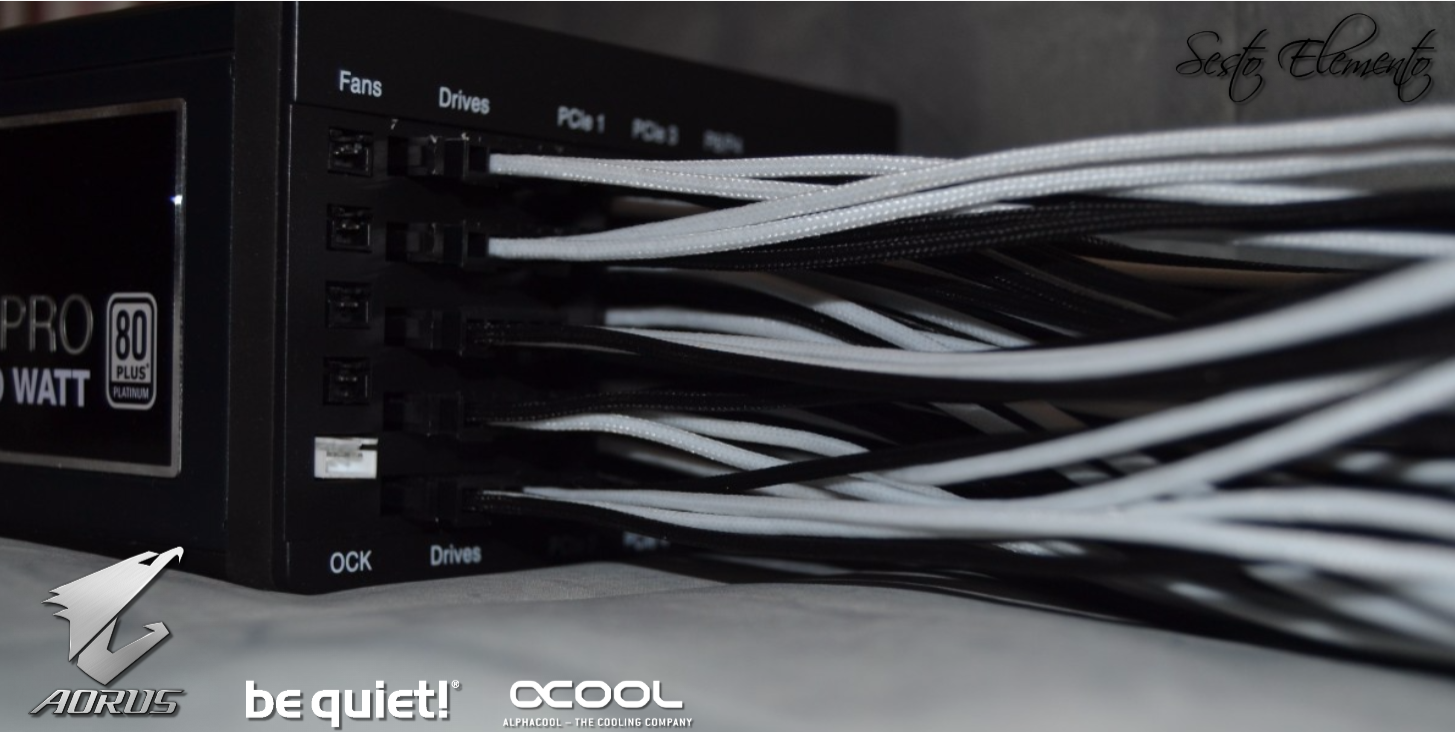

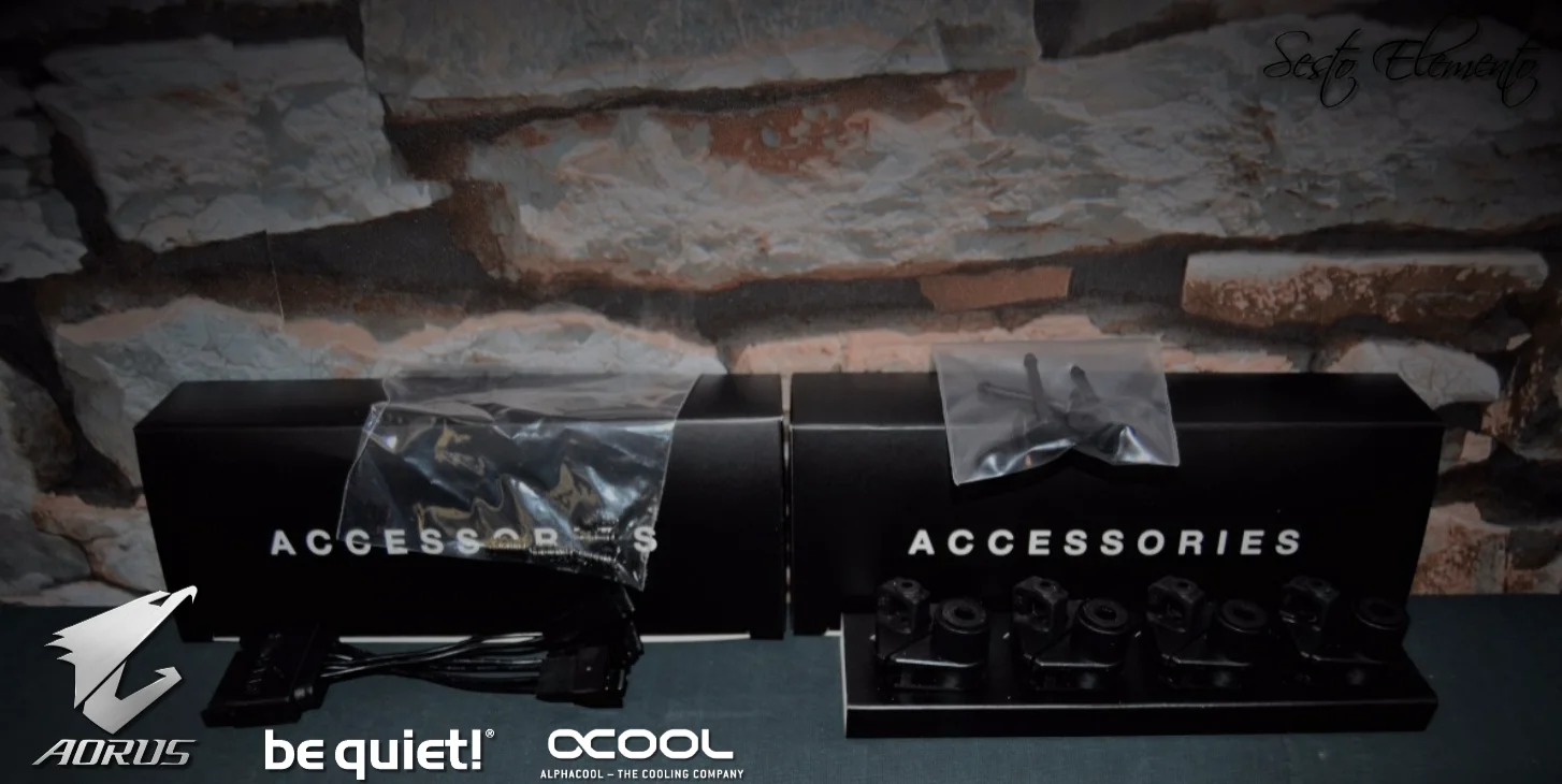

Cablemod Cable arrived
Bought these during the Easter sale, got the whole lot for £40 inc shipping.
Bargain!
more to follow, thanks for looking

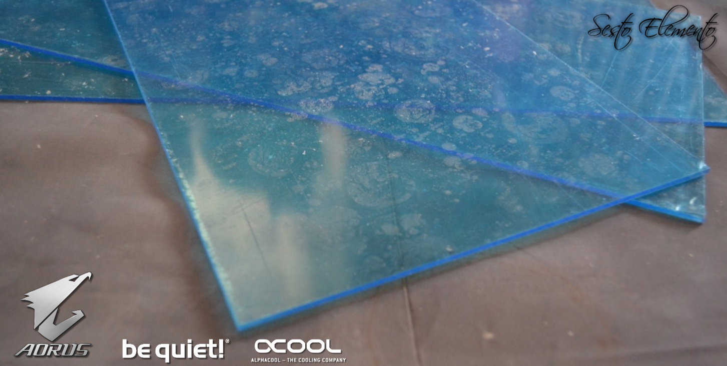

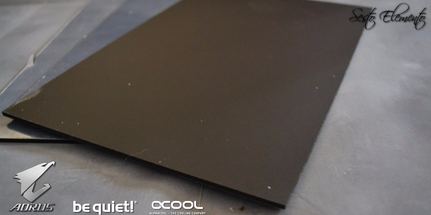

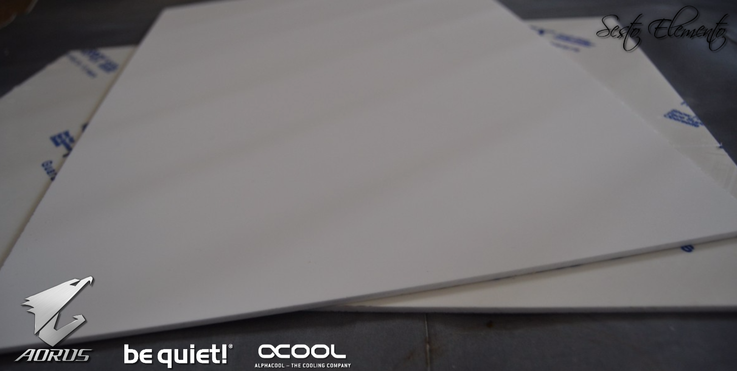

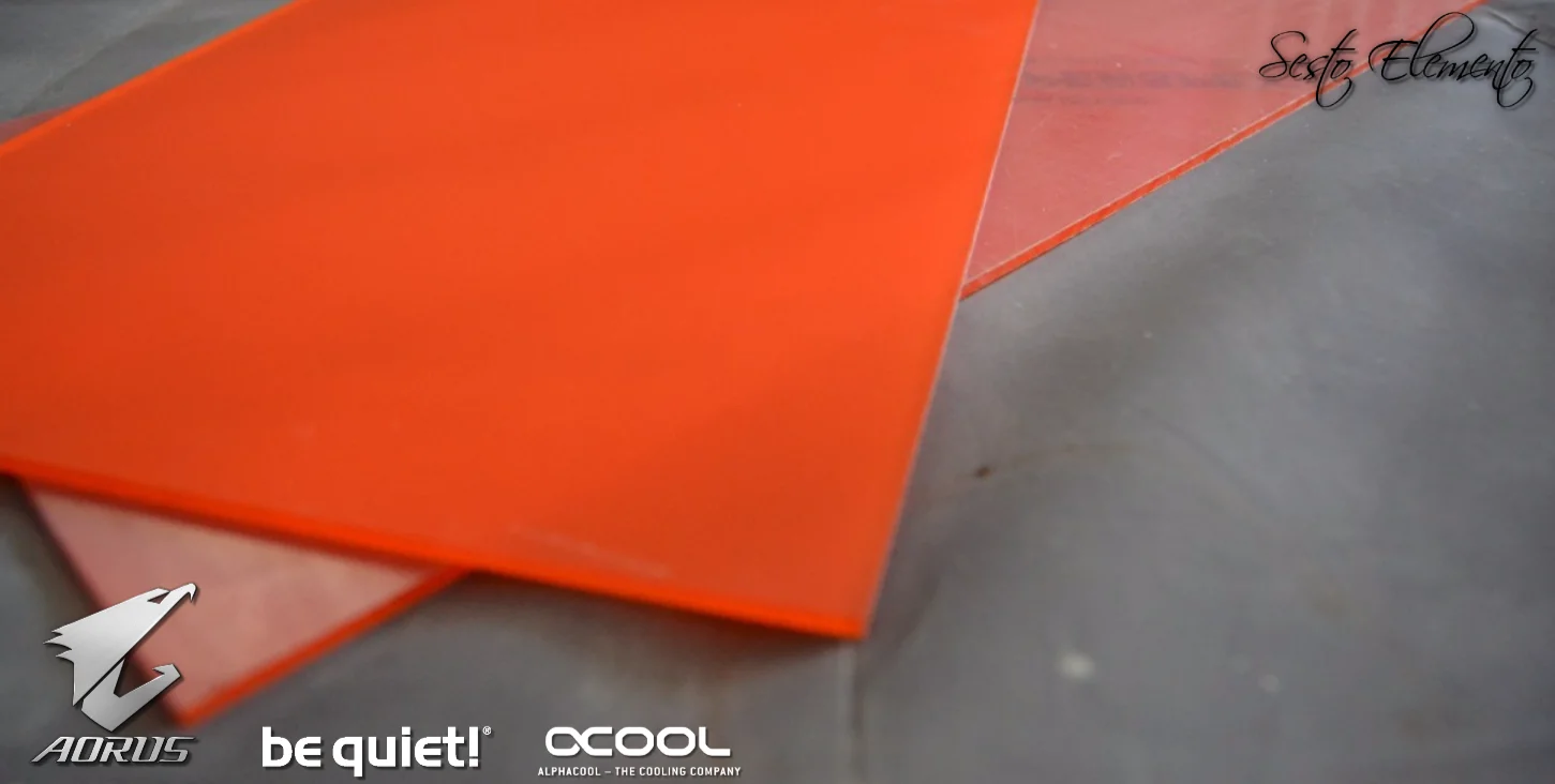

Acrylics arrived today, so i can begin work on the panels and front reservoir!
Be slow progress, as i still have to do all the mapping with the software before i actually do the cuts.
Check back later for updates
Thanks for looking.

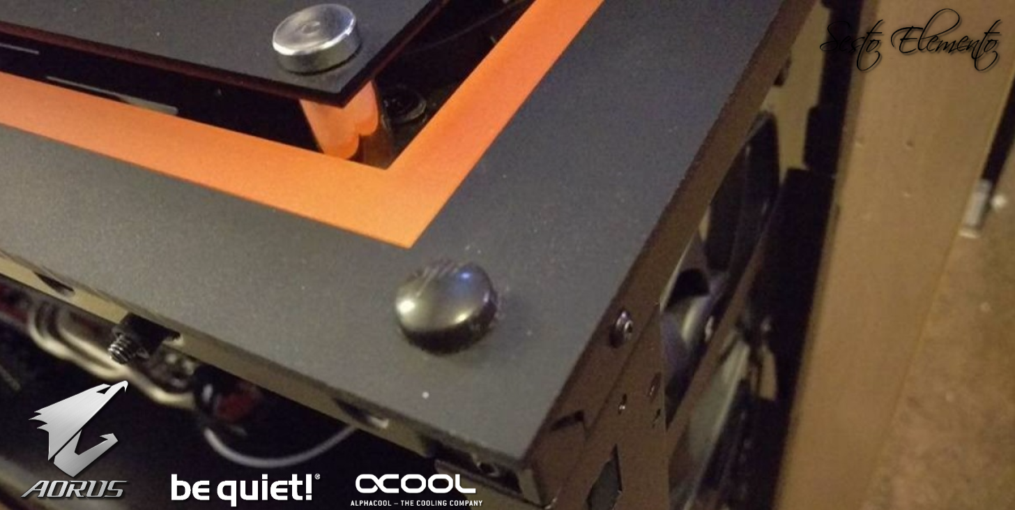

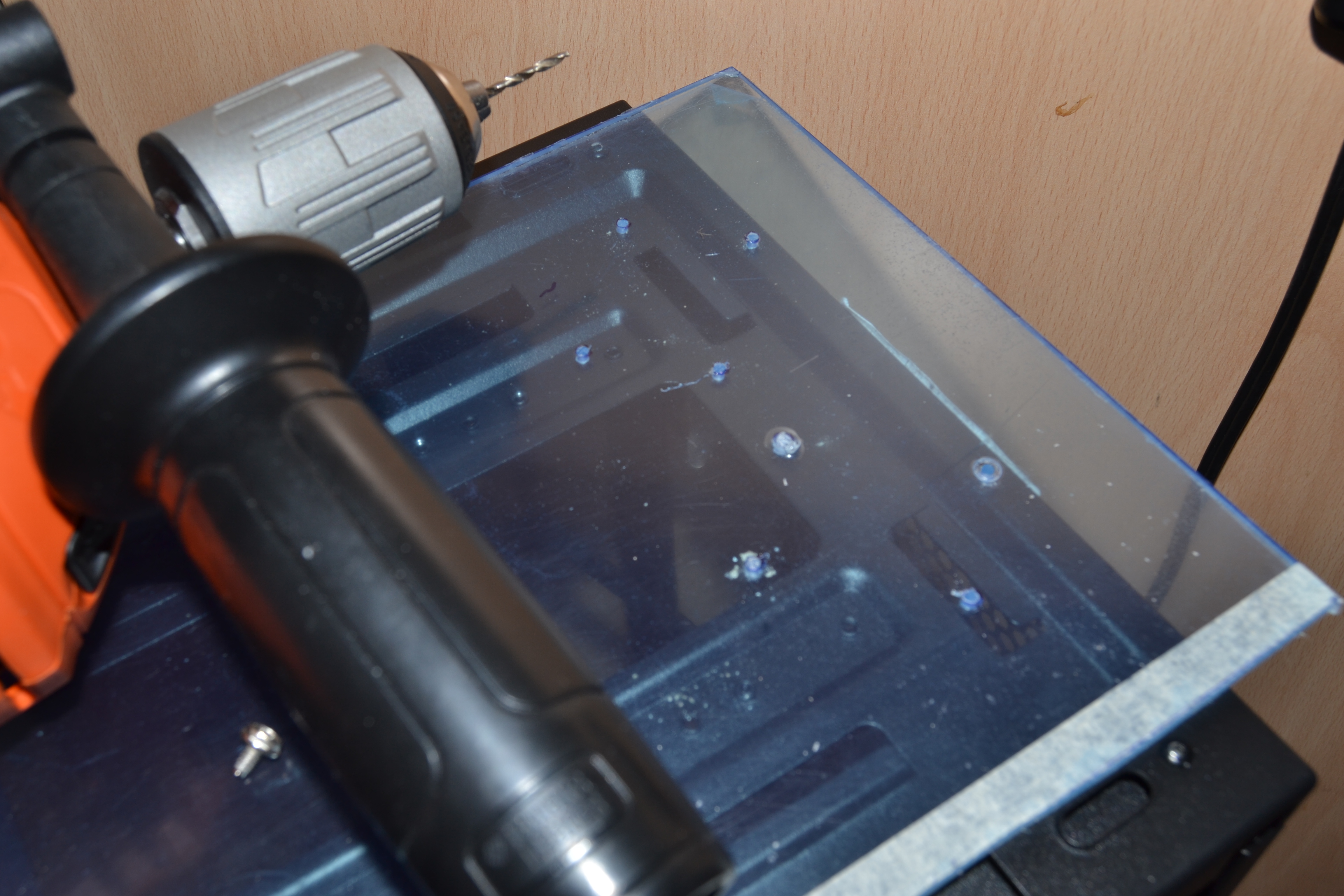

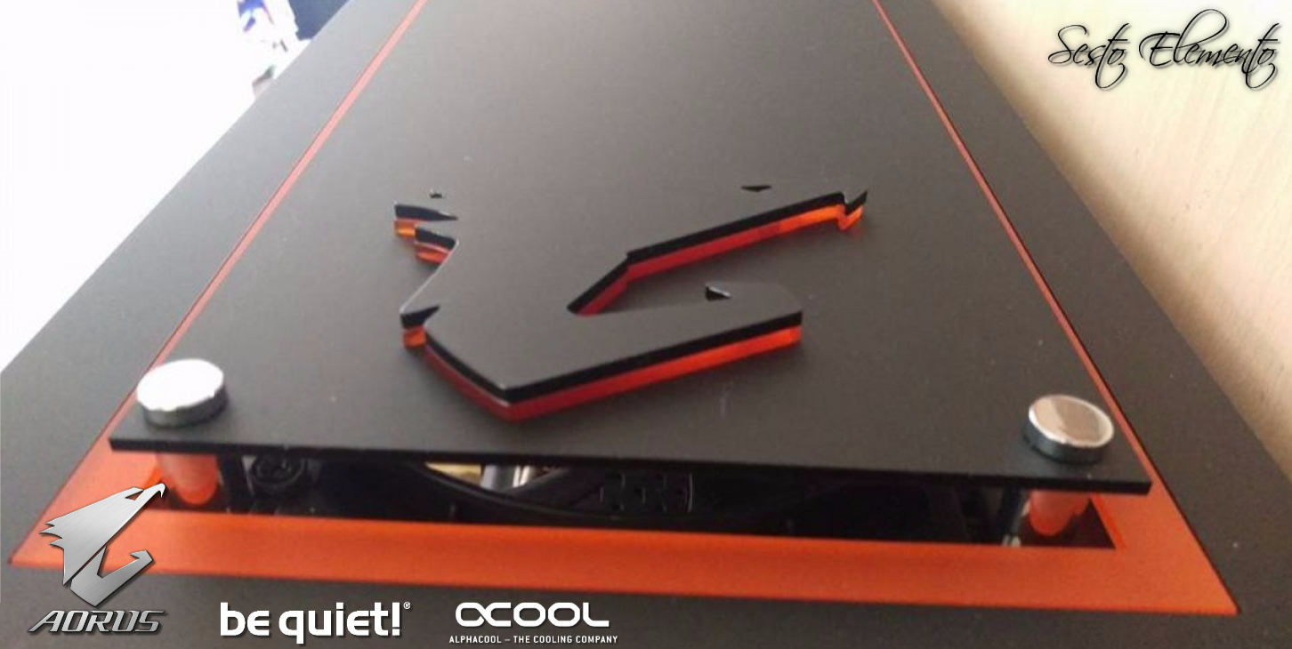

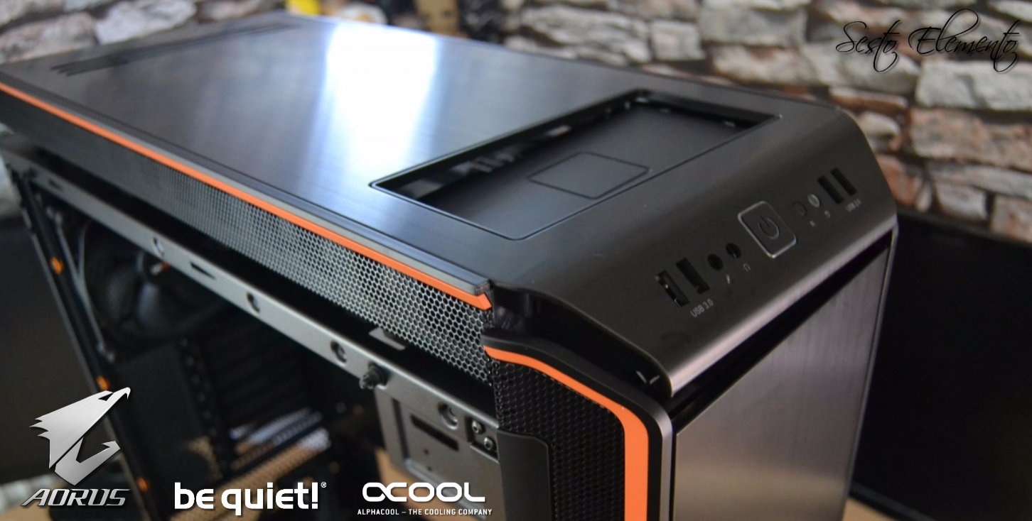

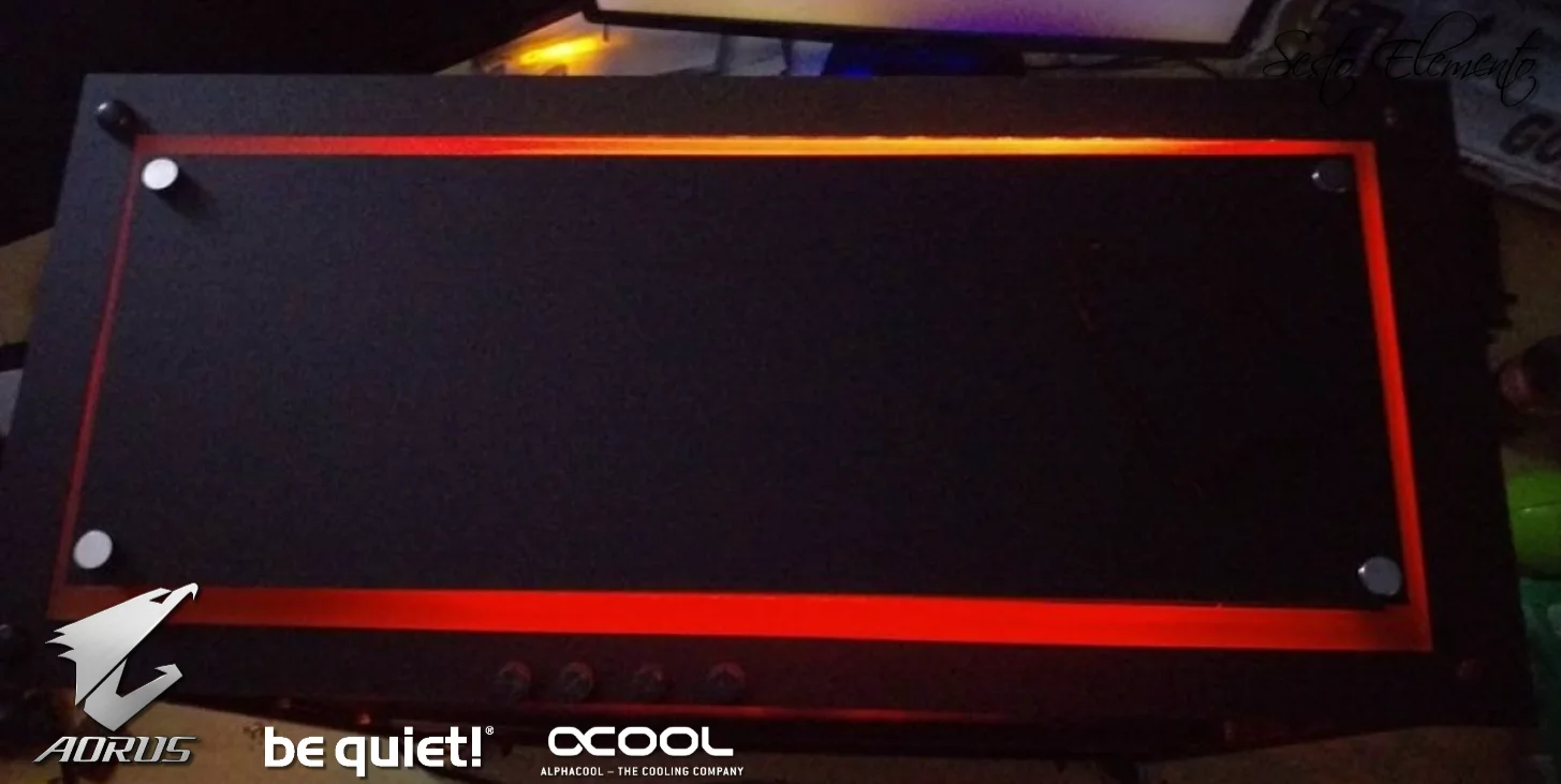

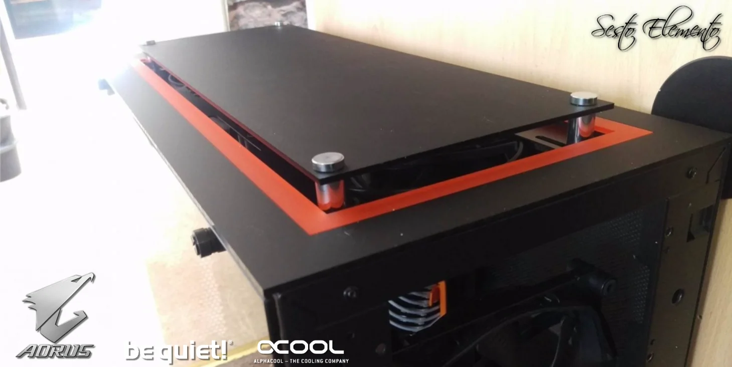

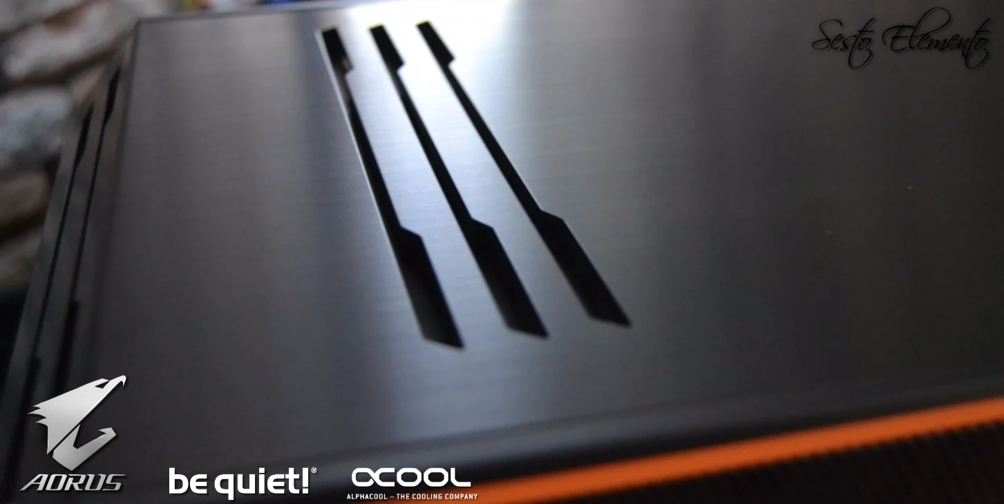

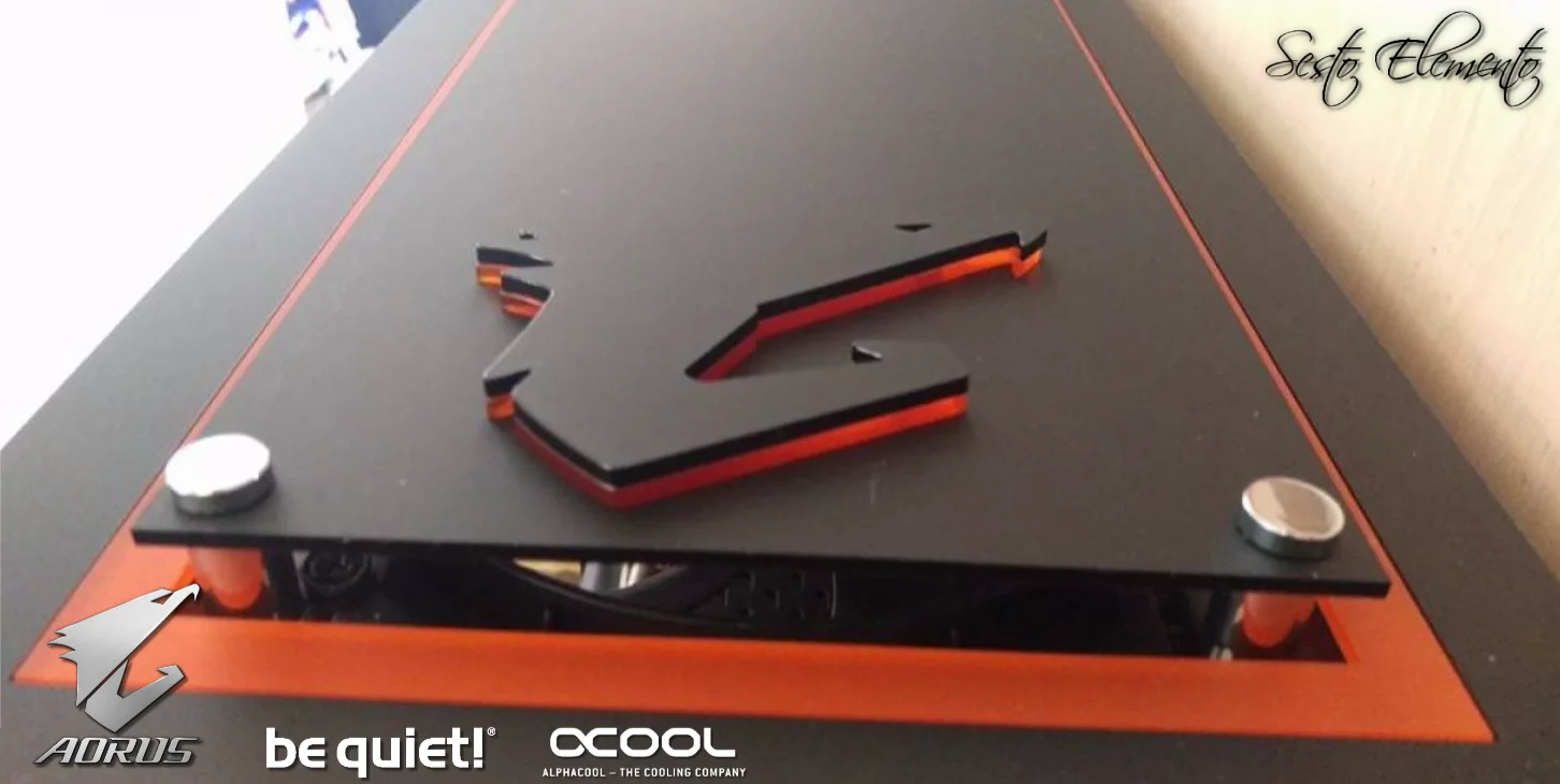

Little update today
Top panel has been cut and I've fitted the legs to allow air to escape.
The orange is frosted,m while will glow when the LED's are on, inside the case.
Will angle cut the edges and bolt the top to the frame.
Never seen anything like that cooling idea. I'm curious if your plan is based on any tried and tested method or just a theory?
Either way I'm very interested to see how it goes.
It's all theory right now, but theoretically, it should work :) At least when running idle. lol

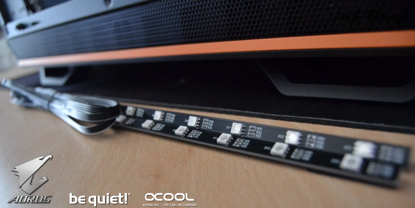

I bolted the top panel to the frame, and used screw (black) covers, to keep things sleek.
I also had a quick test with the lights, made sure it glowed right.
I'll now drill some holes behind the Aorus logo, and put in a couple of 2.5mm white LEDS.
That should complete the top panel. :)

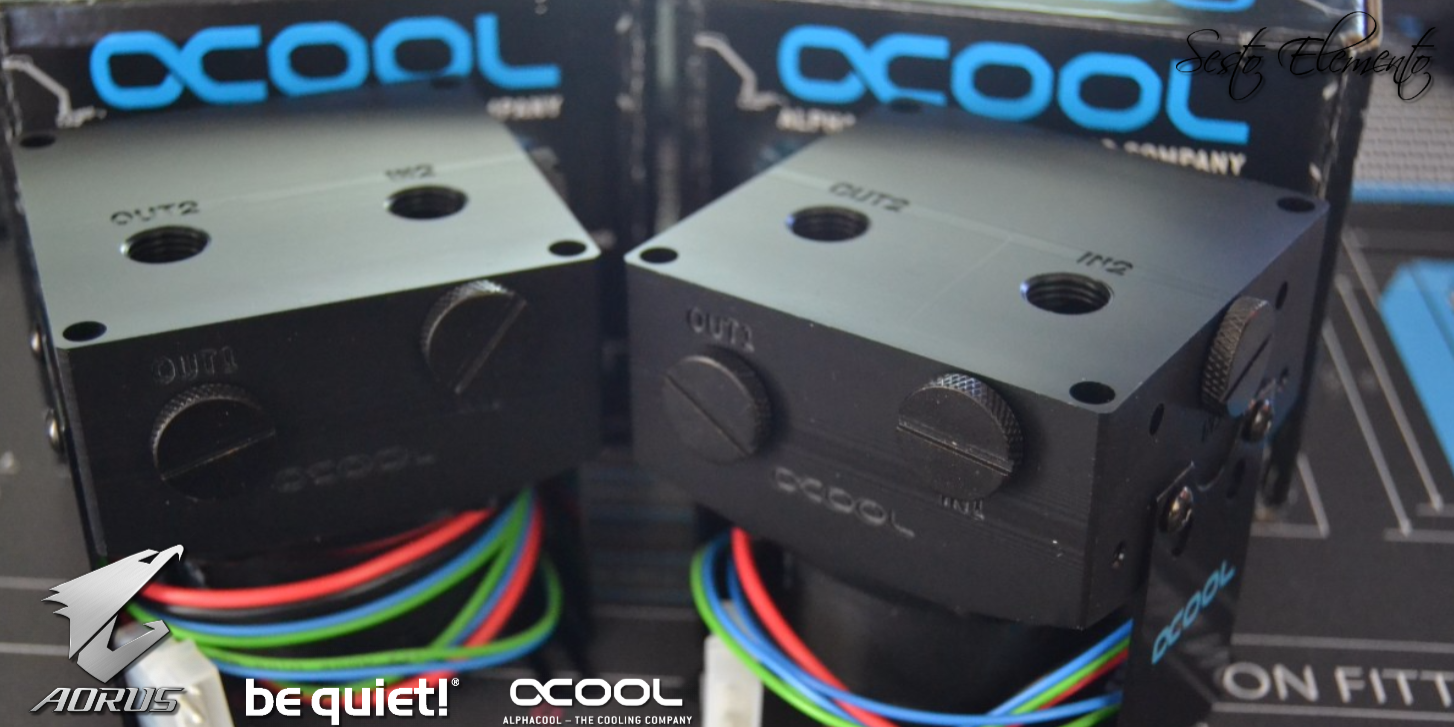

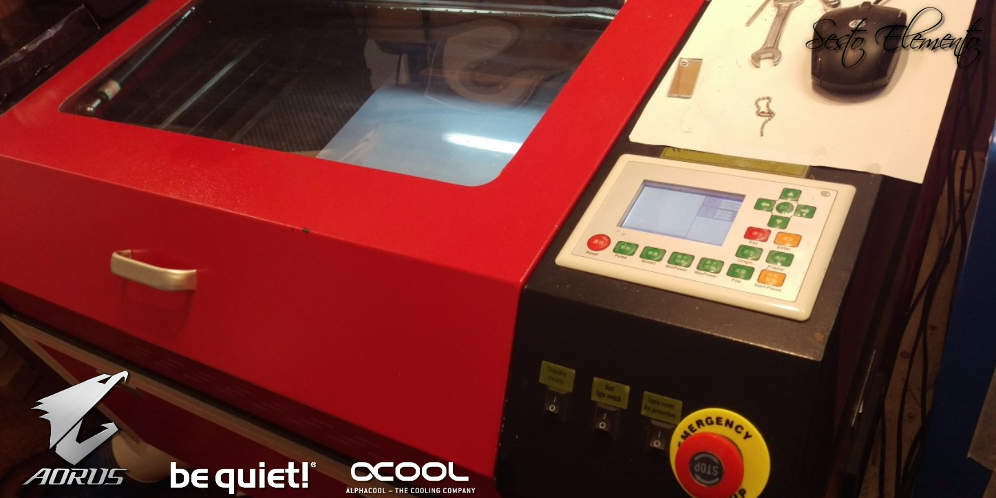

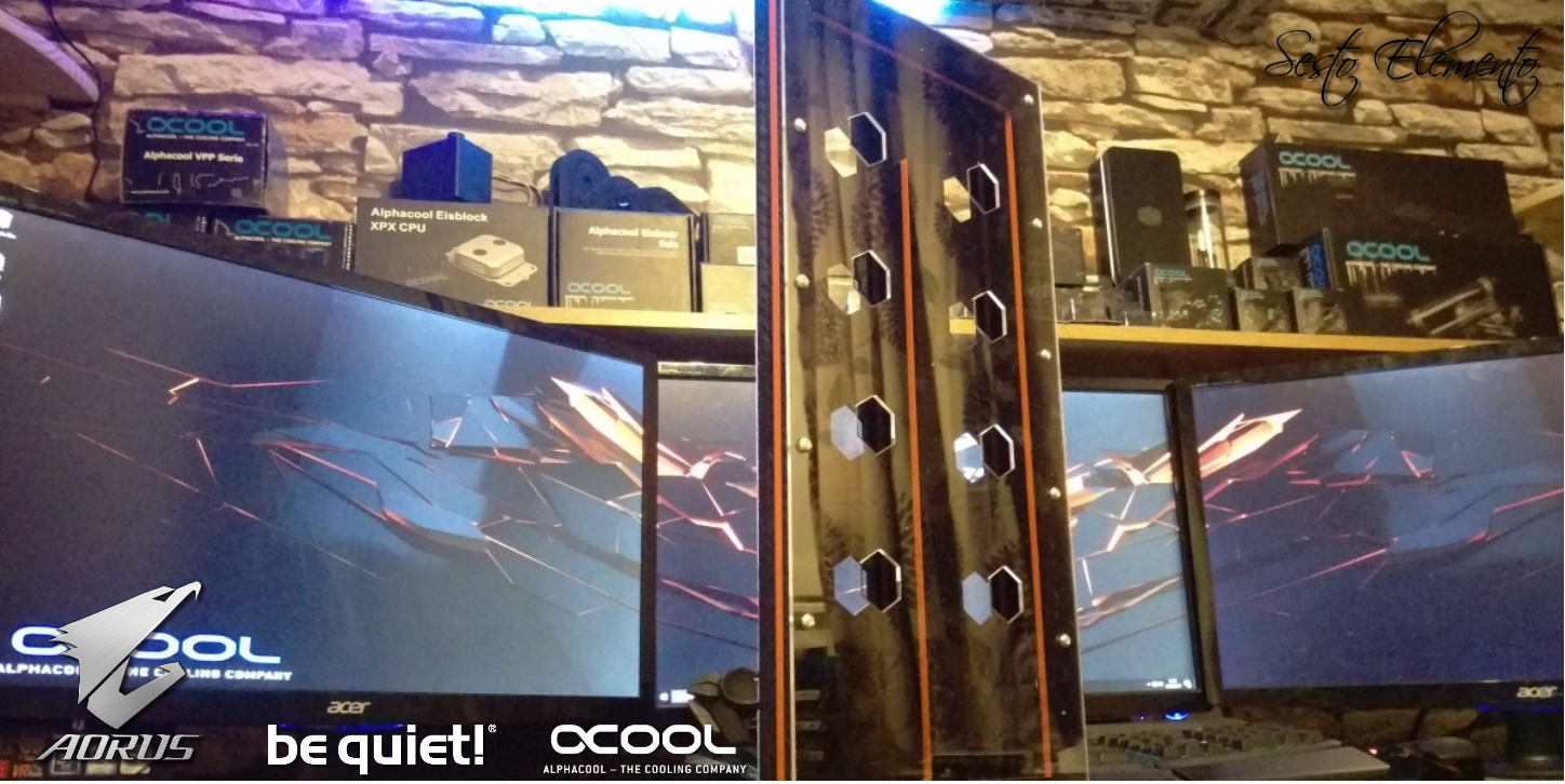

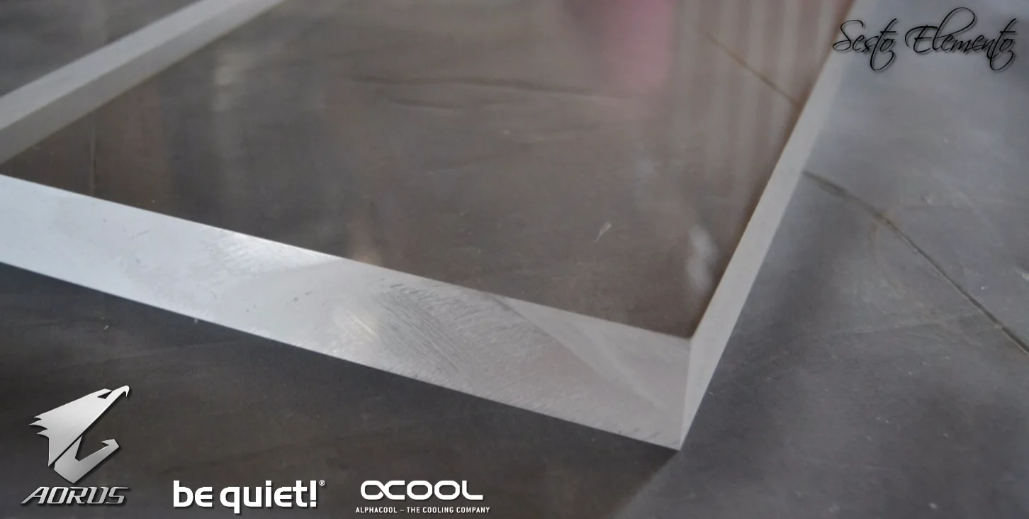

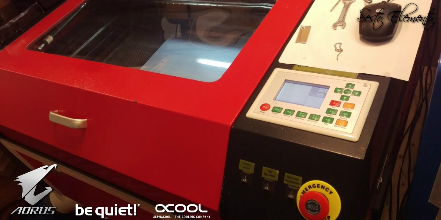

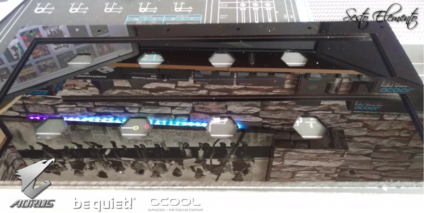

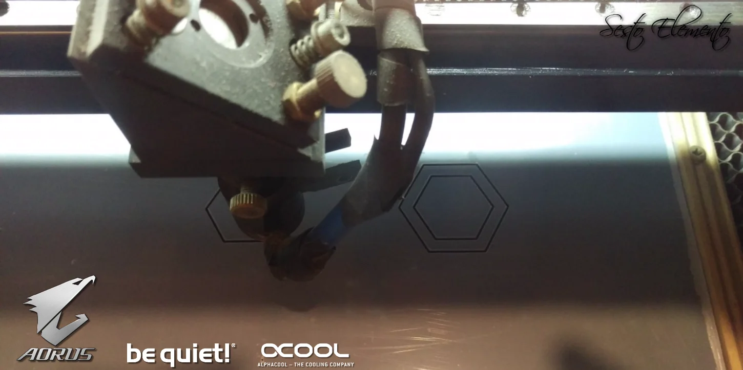

So we started work on the Reservoir today.
It's going to take 8 hours to cut. *Crys*
35mm thick, lazer at 50% power and speed at 0.5.
We don't wanna go too fast, or use too much power as it could melt the acrylic back together after cut, Nice and easy does it.
Special thanks to ALPHACOOL for the massive support. These guys have bent over backwards to help me out on this.
huge props lads!
Unboxing and overview video will be available later tonight.
Thanks for looking.

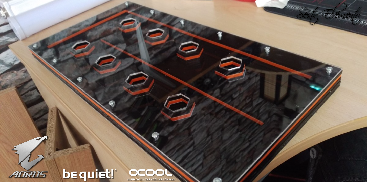

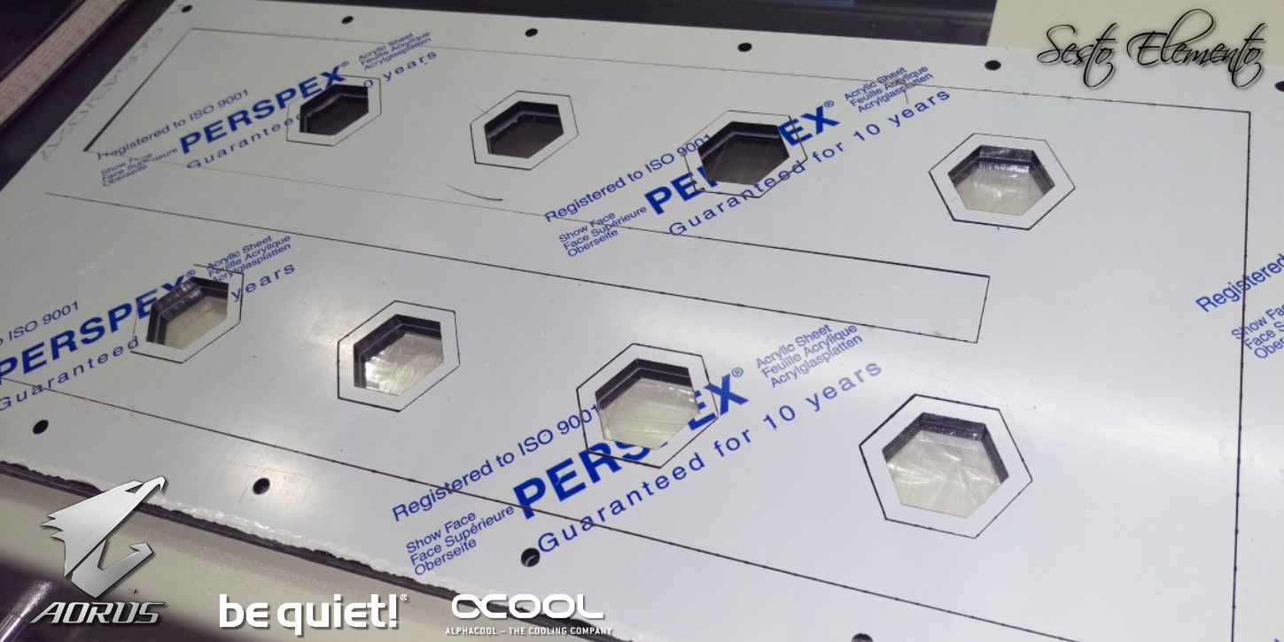

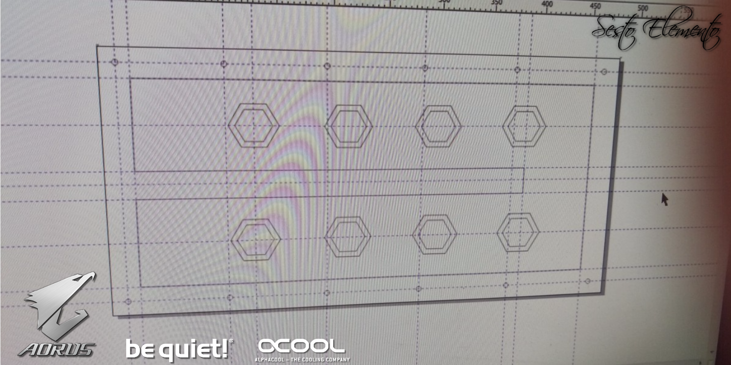

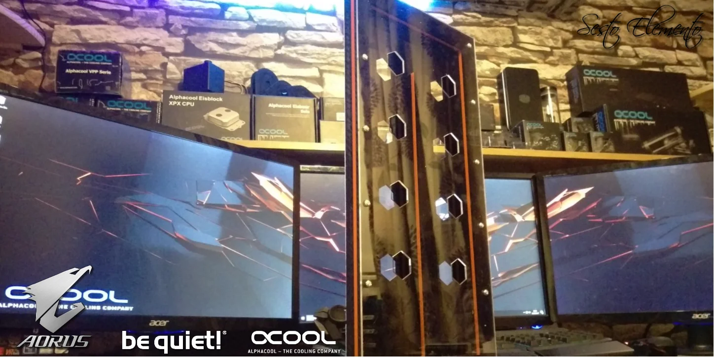

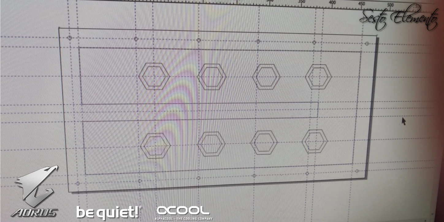

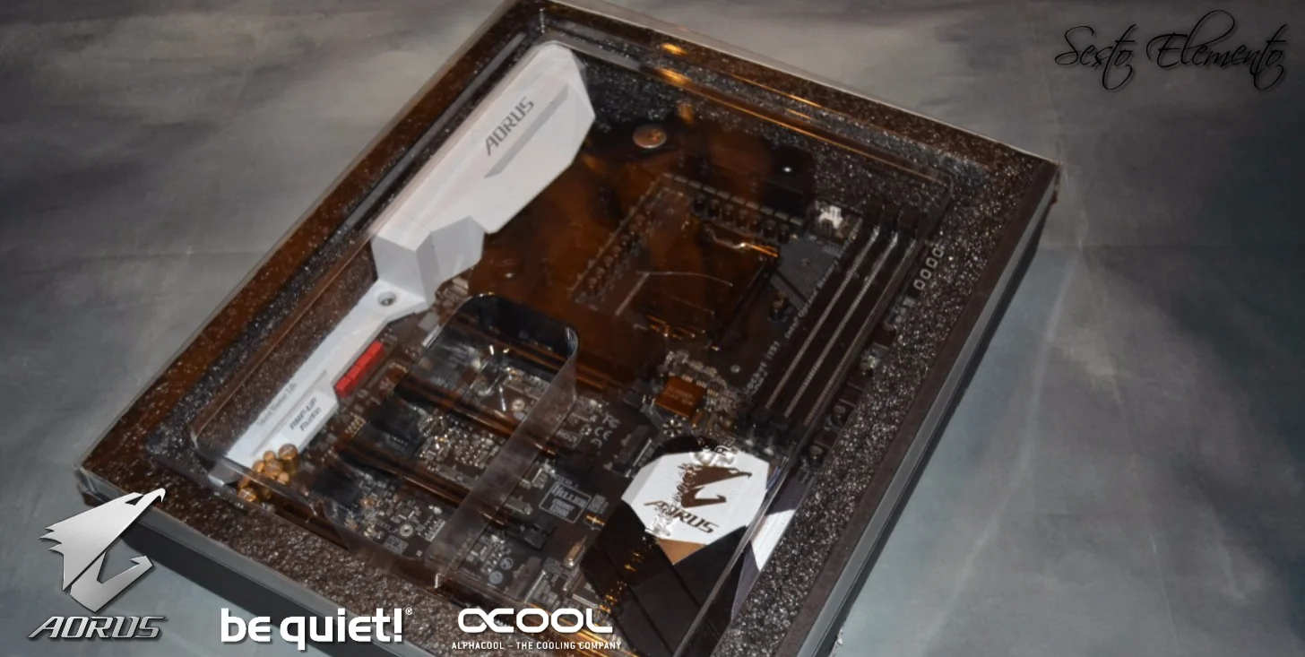

Reservoir update!
I had to completely re-design the reservoir due to sizes and limitations on the inlet and outlet ports.
So first of all i plotted the design on the computer
And got to work on the acrylics

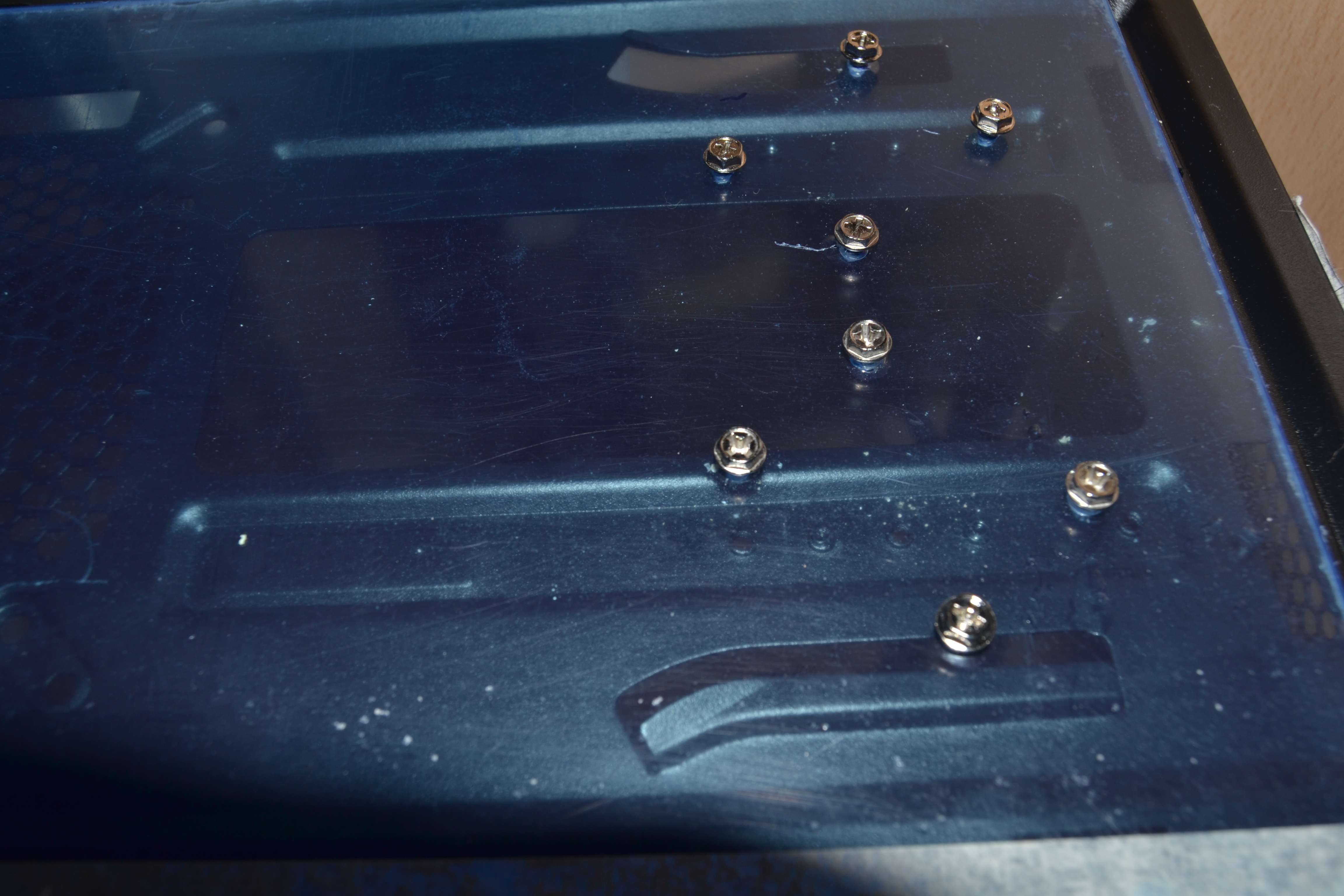

Once they were cut, i took the covers off and placed them together.
I then bolted them together to test fit and get a peek at what it will look like when finished!
And i am in love!
II really hope this works! lol

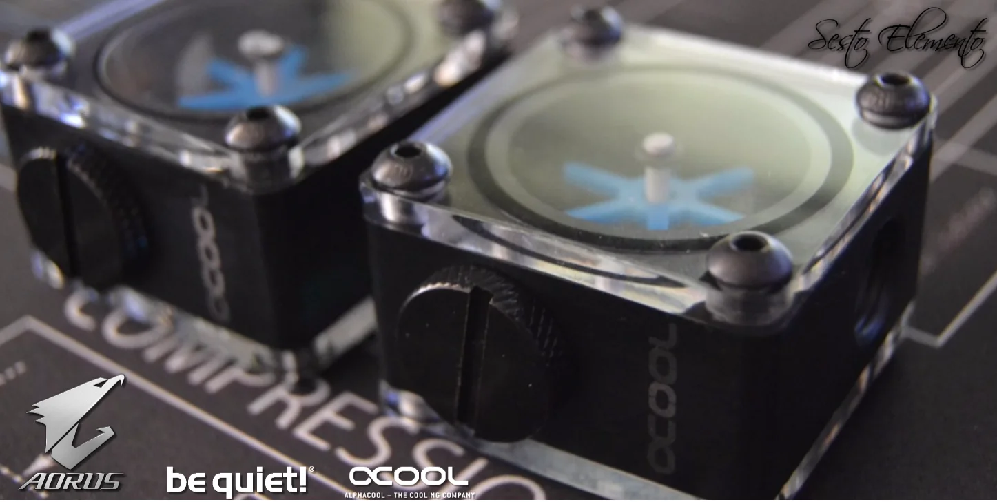

Air pump and fittings are next to be attached, so fingers crossed!

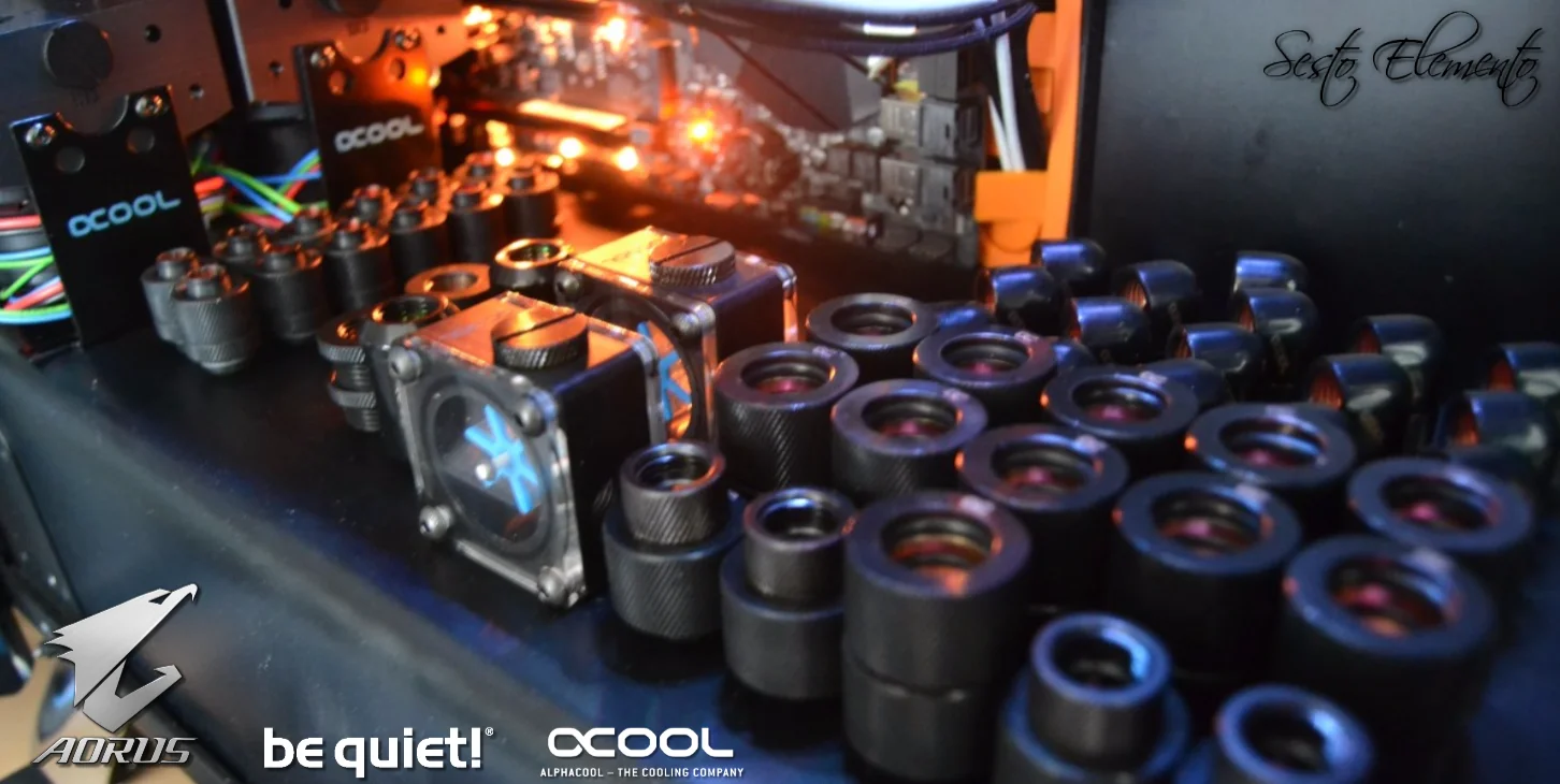

Just a quick update.

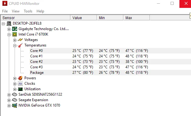

It works.And it performs on par with a normal custom loop. If not a little better.
I was sceptical, but last night was my first test and now i can't wait to share results.
So.
First test was idle, because for some reason people like that
27c
Second.
2 and a half hours of ESO on max settings and 5760x1080 (ESO is because it's pretty intensive on the CPU)
peaked at 48c
third test was the big one
AIDA64 extreme system stability test
With results that wow'd me, here they are
In the first 20+ minutes it hovered around 55-57c
After 70minutes it never moved above 60c.
i would have left for longer than 70 minutes, but was no need, i got the results i wanted to see.
here's a short clip of the test at 17 minutes in.
I will follow up on this post soon with more details on how everything works, including a video which will describe everything better than i can with pictures and text.
