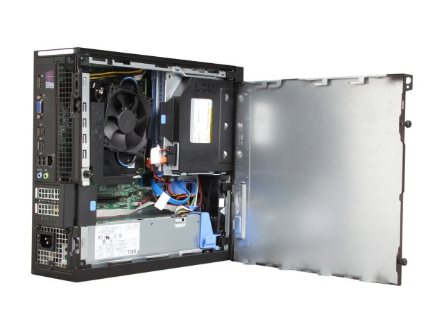

I have a Dell Optiplex 3020 SFF which has a low profile, single slot PCIe slot. It mainly an office computer and I like the smart subtle appearance and size. It has an i5-4590 so it's no slouch, perfect for gaming, it just needs a little boost to GPU power. The only issue is, its very tight in there, tighter than it looks in images.
http://www.digitalwish.com/prod_images/3020_s3_full.jpg
