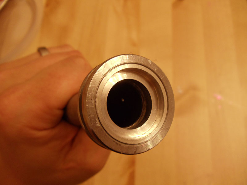

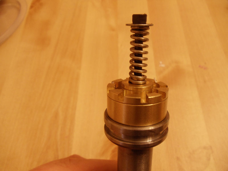

I fitted a virtually new ZZR1400 shock onto my K5 a couple of weeks back, rebuilt the forks with much stiffer springs and cartridge emulators and spent a good couple of hours setting up the preloads and damping. It has transformed the bike, no more diving to the end of the forks under braking, and the rear end now feels absolutely planted. I probably saw a greater improvement than most as I'm a bit on the err..chunky side, the stock springs are probably not too bad for a max of 10-11 stone but the damping is still poor.

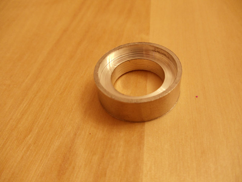

Curvy SV owners are lucky, the Racetech emulator clones from Debrix fit perfectly into the damper tube, and are a small fraction of the price of the Racetech items. They can also be fitted into the pointy forks, but you need to get some bushes turned up to keep the valves centered - I made my own, but even if you have to get a local machine shop to make them you'd still save money over the Racetech emulators.
