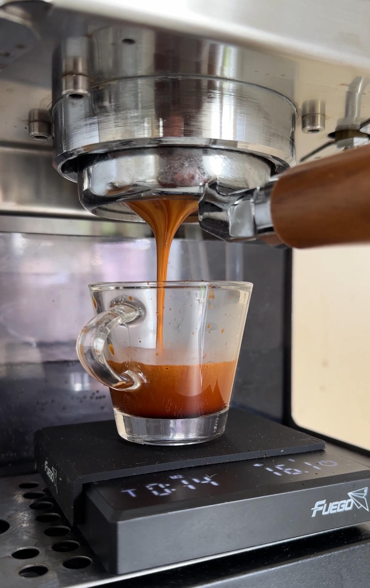

Since I've not used the machine in over a year, black flushed, cleaned it out and did a test shot last night (I never drink the first shot after cleaning with chemicals), 18g in, 36g out...12 seconds! On 13 setting on the Niche Zero.
Using the naked portafilter, it looked good but some spitting (found 2 spots) in front, ignore the wet patch.
12 seconds is fast even for a turbo. You're probably in the right grind range for an allonge though. If your beans are med to medlight could pull out 80-90
for the naked portafilter I thought the important quality indication was as it starts to flow ... but when using a spout, crema output, for me anyway, is only obvious at the end.

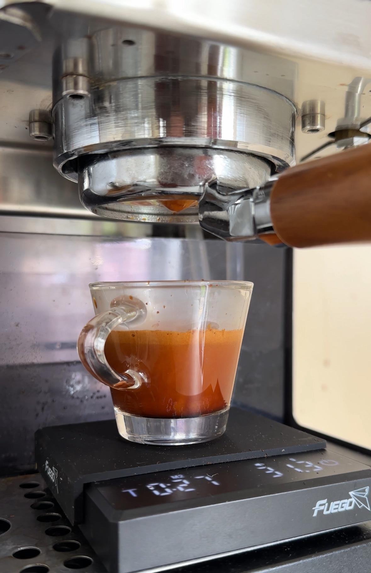

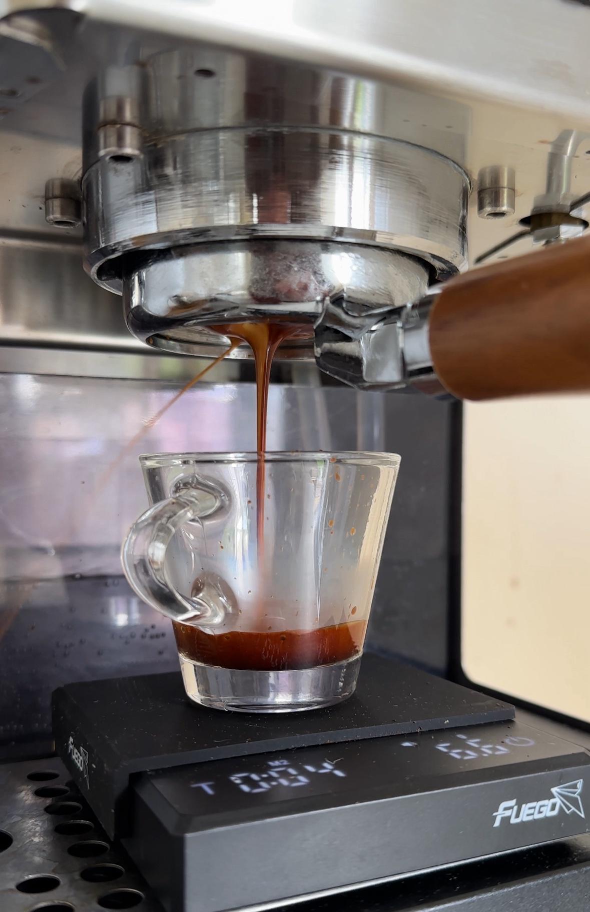

Espresso'ing .. used naked for second of evenings doubles - ok it's difficult to time it to get good initial crema picture, + basket is 10mm above pf rim - nothing too dirty.
have to put the pf on a piece of wood for the tamp, since can't press down on spout.
15g in, 30g out.
Channelling happening and made a mess on the side, straight into my Niche.
Timing was good but it was a bit sour…hmmmm
15g in, 30g out.
The channelling would mess up the flavour and make it sour.
The trick to good espresso in my experience is tamping, don't over do it. If you need a longer extraction then grind finer rather than tamping harder.
Keep meaning to get a measured tamper, but I'm pretty consistent with my technique now. I prefer to press my fingertips around the edge of the tamper rather than leaning on the knob, more tactile and easier to gauge.
I'm usually doing 16g in, 32g out in 35-40 seconds for light roasts.
