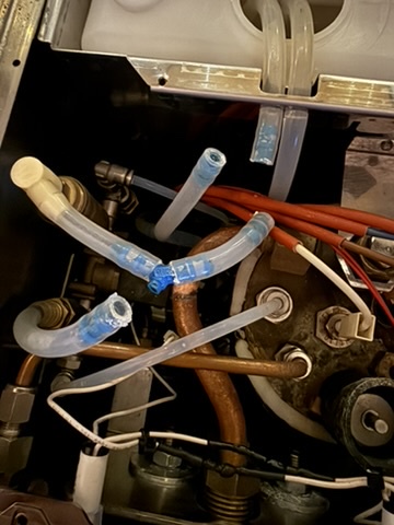

This is what I found when I opened the Mara the other day :
After removing the bits....the connectors have just perished and crumbled to bits

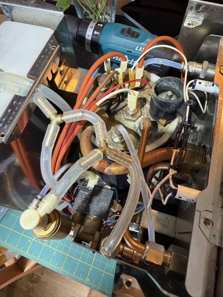

Now replaced with shiny new brass connectors :
Touch wood, after a very thorough rinsing through of the boiler several times.....everything seems to be working ok. Had a thorough poke around, and apart from the silicon hoses, I can't see anything else that might cause a problem, everything is metal. Looking around at various images they clearly stopped using these connectors at some point.....for good reason.
^ It should be fine. Citric won’t attack any of the metals there. The blue/green colour you saw was probably it taking the chloride/oxide layer off one of those copper pipes where over time the pipe has reacted with the chlorine in your tap water
