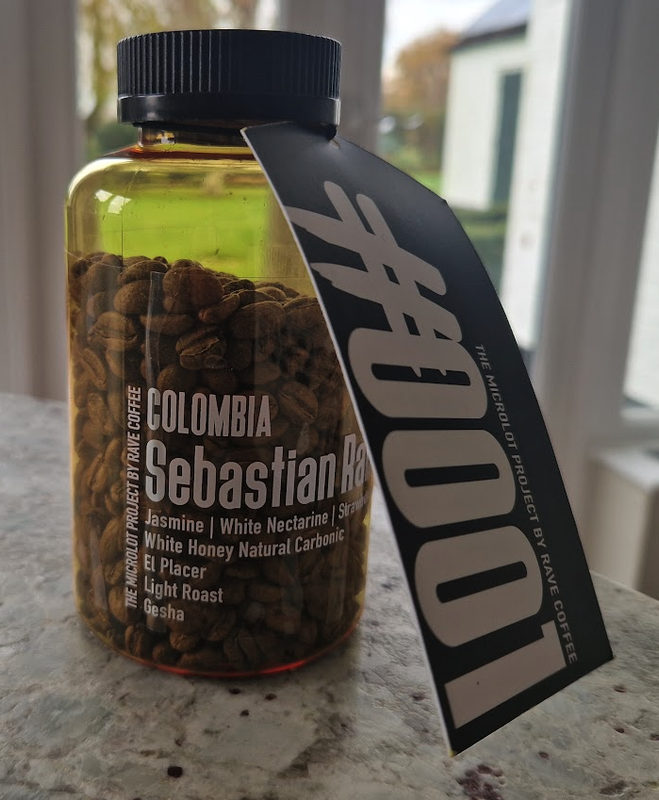

Welcome, nice setup :) I've had a bit of a mixed experience with Rave, just cracked open a new bag of theirs for the first time in a few years but a little early to pass judgement yet... Although i do also have this to try:
