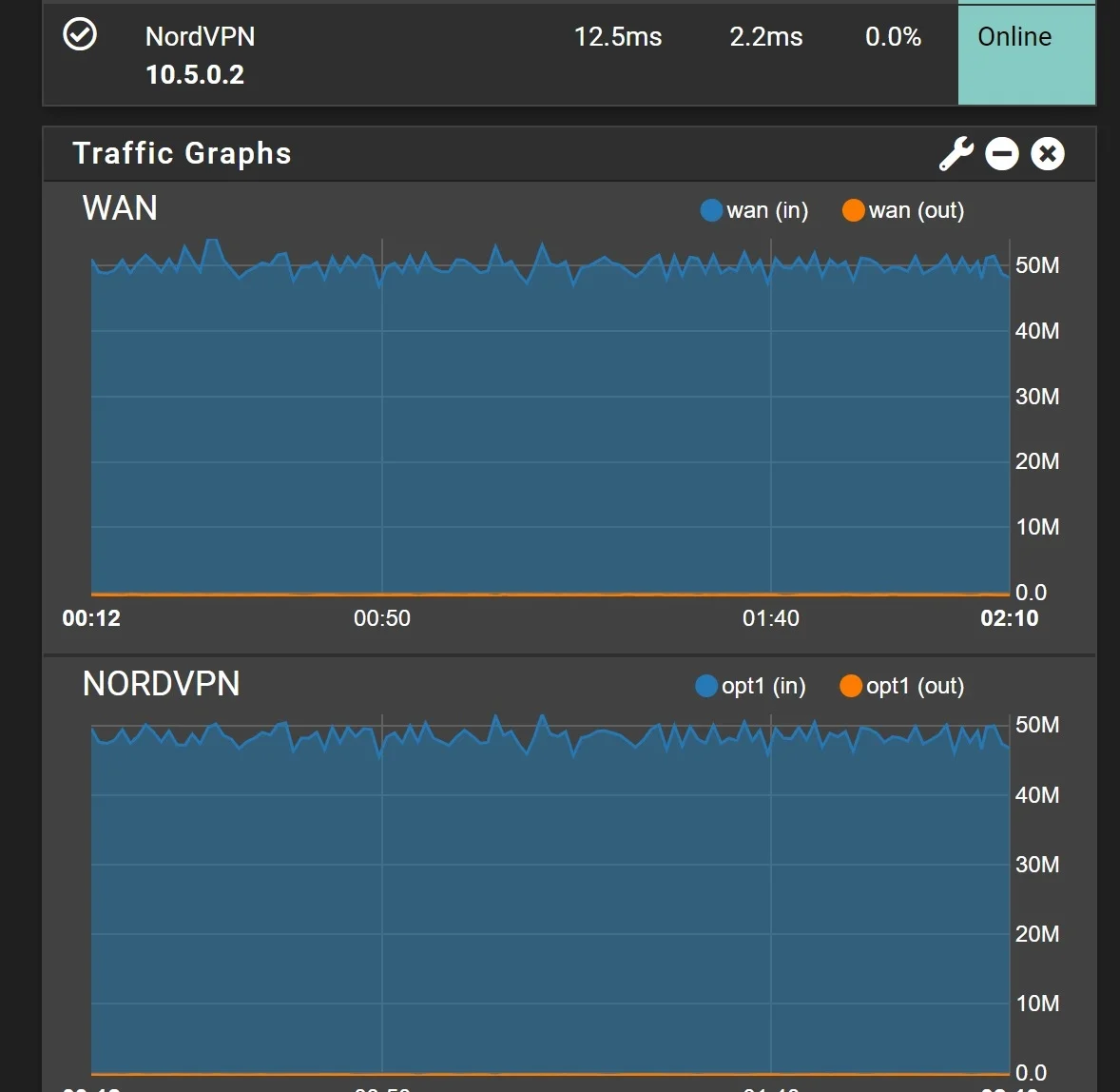

I've got Sky FTTP 500Mbit, my setup is with pfSense, running NordVPN on a separate vlan for downloading purposes.
I'm having an issue where if I download large files (20-30GB+), that the download speed through the VPN will plummet and eventually stop. The VPN interface goes down with 100% packet loss. That in itself isn't the end of the world, but it also seems to bring down DNS for anything not on the VPN vlan, so the rest of the house loses internet for 5-20 minutes until it sorts itself out. Rebooting pfSense and/or the ONT rarely fixes anything, it just has to be left to come back to life. While it's not working, my WAN link is still up, some websites will still load and Whatsapp/Discord usually still work, other sites will just not respond at all.

So this is while downloading, no issues at all

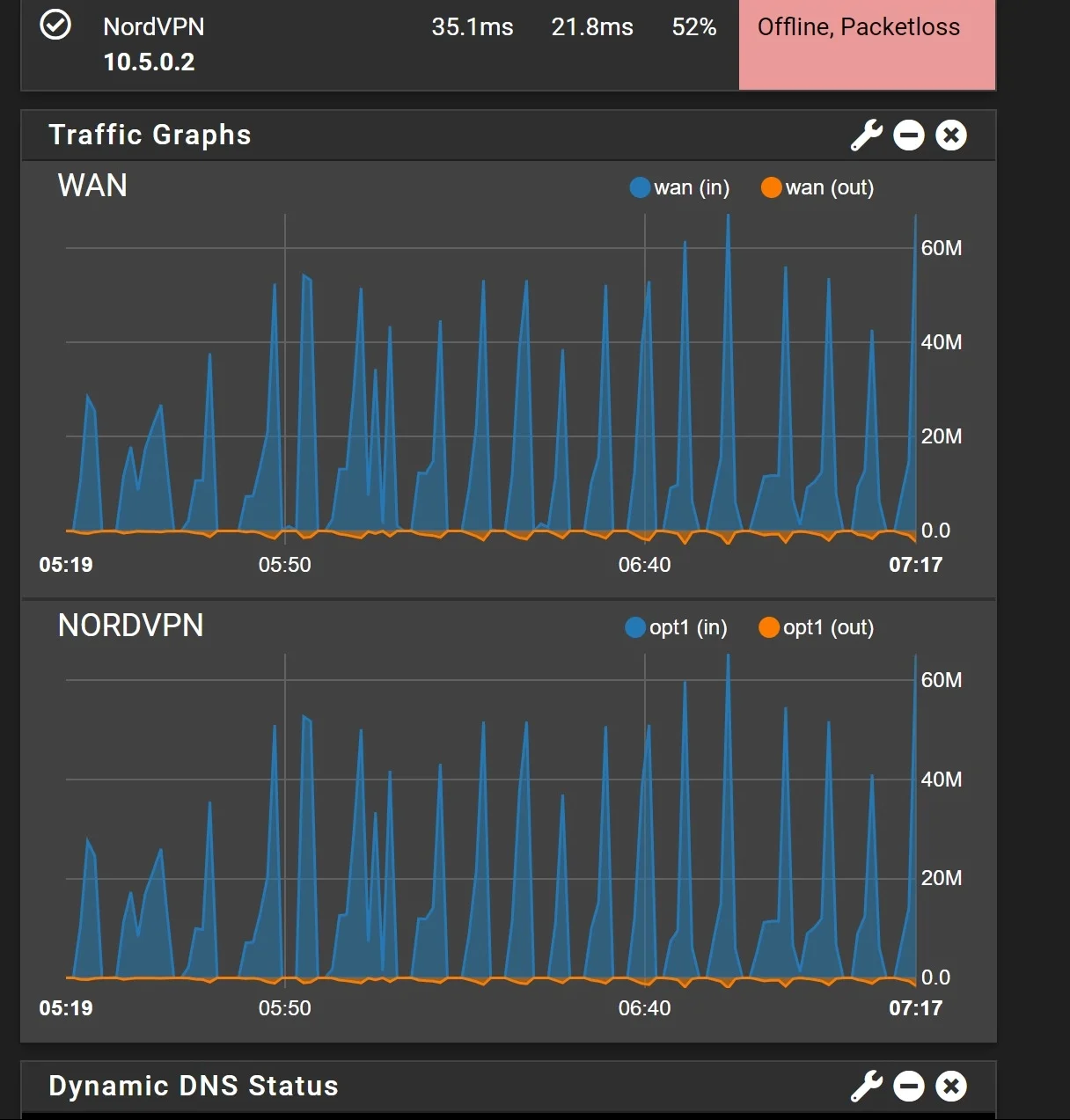

Then suddenly the download speed drops like a stone, with small bursts of activity and high packetloss, which eventually leads to 100% packetloss and no connectivity. The VPN will not reconnect at this point.

I'm not currently using either DoH or DoT. It's possible they are seeing the encrypted traffic though. Something else I have just tried is setting up a cheap VPS with a Wireguard server, connecting pfSense to that and using that as my VPN. Exact same issue, after downloading 30GB+ then the speed starts to tank, then both NordVPN and my VPS VPN show as offline. So it's not like they're even targetting known VPN hosts.
