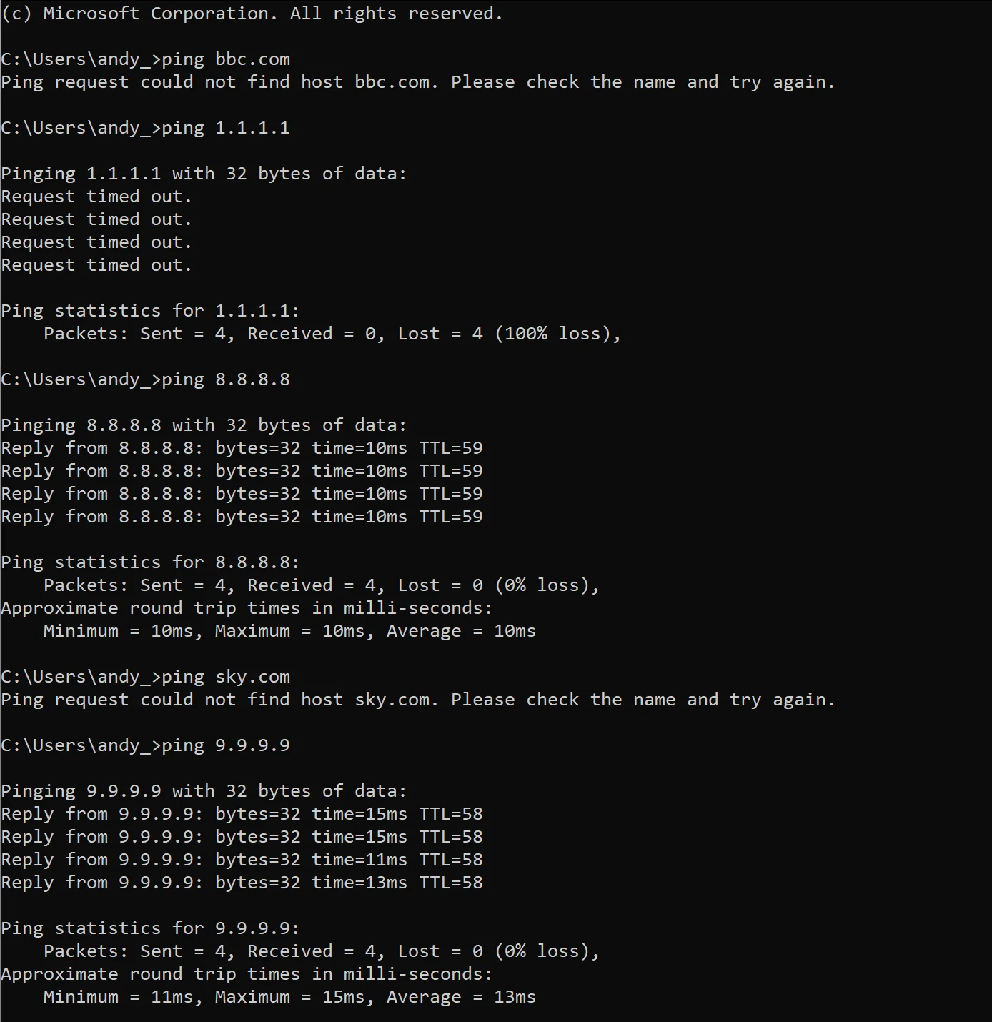

I didn't think to do a tracert tonight actually. It's all working again currently although I'm going to try and break it again shortly after reading about re-enabling the Broadband Shield then disable it again after an hour, as apparently it can still stay enabled even when it's been disabled. Not too hopefuly it will fix anything but the hour will be up soon and I'll try it.
I did do a few ping tests though:
