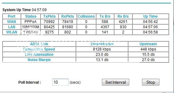

Just got sky back up and running today after a house move, I know it takes upto ten days to sync properly and stabilise, but from what i can make out I am connected at around 8Mb download and half Mb upload, yet try a little downloading and gwtting anything upto 200kb/sec, seems slow really, is it just where my connection is just starting up, I have a screen shot below of router status,
how does it look
Either you're on access*, which is horribly slow and shaped, in which case all you can get is 8 but will find your pings are high.
Or you're on llu and some thing's wrong, that snr is usually high. I find this unlikely, because with that attenuation (and a lower snr) you would be connected at 24meg.
*Tbh, if you are my advice would be search for any llu provider at your exchange and switch during the cancellation period, otherwise look into that snr.
yeah I'm on access, no choice as the exchange hasn't been touched yet, is it normal for access to have high pings then, not too good for online gaming then? and is it traffic shaped aswell?

Here's my line details:
And at present I've no chance at all of watching anything on Youtube or I Player. There's no point in trying to download any updates for my PS3, any page takes ages to load and gaming is impossible. As I said at the start of my post I really do wish you all the best but I cant paint a rosy picture for the service given the experience I'm receiving at present :mad:
your connection is exactly the same speed as mine up and down, if i am reading the correct things for the speed, 8128 is 8meg download? and 448 upload is about half a meg?
if i can get them speeds it would be ok, but at moment im downloading MOH from EADM and getting 226KB/sec which is just over 2.2meg, (i think) so how come router shows over 8 meg?

Your router is already connecting at the maximum rates possible so everything you're seeing is down to a combination of the load on Sky's backhauls and the traffic shaping they're using to control that load. Unfortunately that's not going to improve soon.
thanks, thats **** from sky then, got an 8 meg connection but they allow me 2 meg, :mad:
Looks absolutely fine, 7150kbps is the highest profile you can have on an 8mbps line (the rest of the capacity is protocol overheads etc). The fact that you're not getting the full 7150kbps during the test is down to Sky having limited backhaul capacity.
