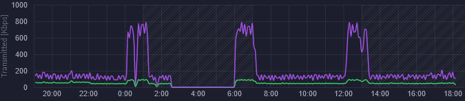

I'm surprised quite how chatty the Q boxes are. Here's some graphs from my UniFi controller showing the last 24 hours. First graph is the switch port that the 2Tb Q box is connected to:
This is the switch port that the Mini (yes, it's 10/100 only) is connected to:
Purple = transmit, green = receive. Both boxes have been in standby since about 22:00 last night.

That's interesting - thanks. I'd been meaning to run some packet captures to see how much of the traffic originating from them is traffic between the boxes and traffic to/from the internet. Looking at the graphs it seems pretty clear that the vast majority is traffic between the boxes.
