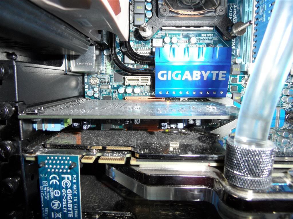

My sound card is above my top graphics card:
I can't use my bottom slot for a 3rd graphics card because my USB 3 card doesnt fit above my sound card, the Gigabyte heat pipes are in the way.
