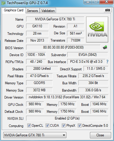

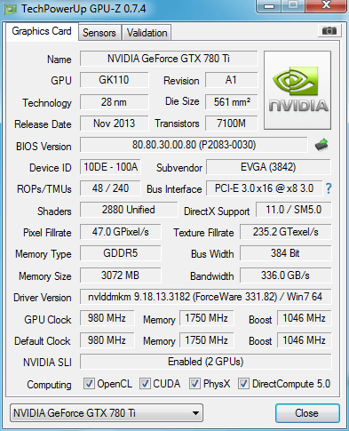

Download GPU-Z from TechpowerUp and look to the right where the quetion mark is, this show the Sli and what speed they are running on the pcie, if you click on the ? it will run a test to confirm this
Sometimes you will need to re-install Nvidia drivers when you move the cards.
Okie did you re-install the nvidia drivers ? (there was a new driver in the last couple of days). If have go for it and benchmark Heaven 4 again. If you do a custom install at the bottom there is a option to delete all old drivers first.
FFS i feel your pain, re-install Heaven 4 , GPU-Z can see them so it cannot be the dip-switch. Download Cinebench and run OpenGL that, ill compare that.
FFS i feel your pain, re-install Heaven 4 , GPU-Z can see them so it cannot be the dip-switch. Down load Cinebench and run Open-GL that ill compare that.
ok mate, does it matter that im running the basic edition? assume not.
